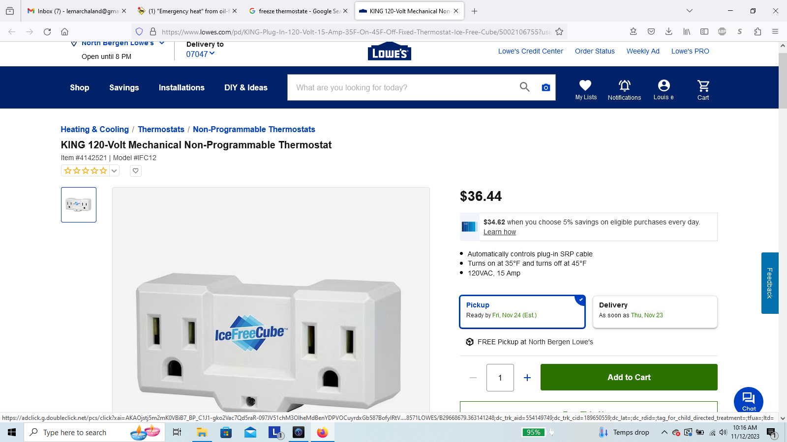

The simple dial adjust ones will cycle themselves on and off to maintain a room temperature or just use a freeze thermostat to turn them on/off.
such as this or the cheaper ones from Amazon;

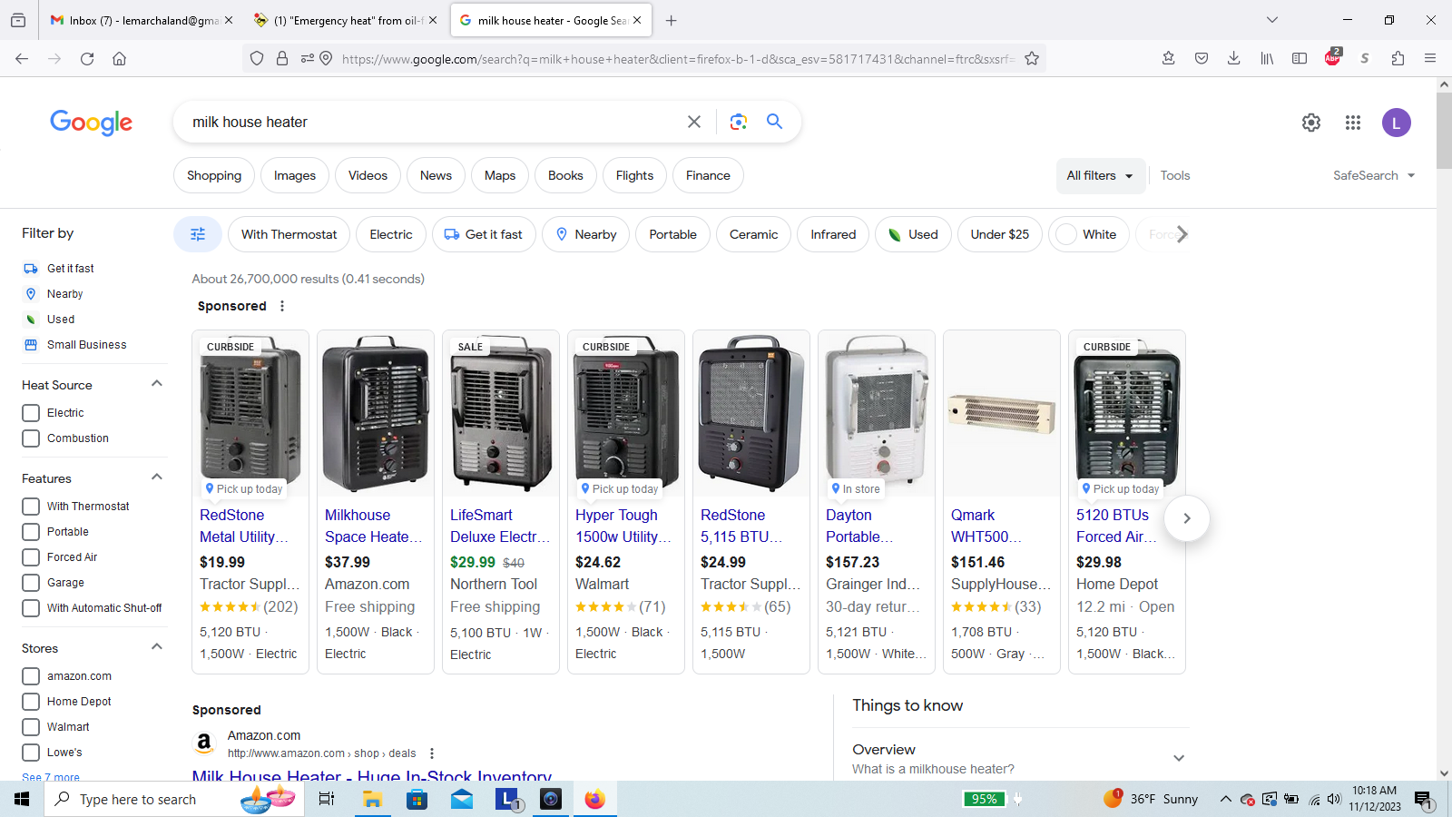

We have used the "milk house" electric heaters for many years in milk house to prevent freezing.
They are used all night long "unattended" do we worry at times? Yes, but I'm not going to sleep out there in the winter!!!

They also last longer. I have one I've used to heat a small building for 15 years or longer. I have it plugged into a space heater thermostat and it maintains a steady 50 degrees when I'm not around to feed the wood stove.
That's about what I'm looking for, but even lower temps.
Again, what brand model?
For my application I'm not looking for 50°F, 40°F would be fine, if I can set it that low. What space heater thermostat do you use in case the ones I want can't control down to 40°F?

I am all for winterizing over heating, but if you heat, remember that pipes behind walls and under floors will get colder than the rooms. I suspect that so enticing set for 40F may not keep pipes at a distance above freezing.
Those milk house controls are great for items that are exposed in the milk house, which are also usually made of non-flammable materials like concrete...
