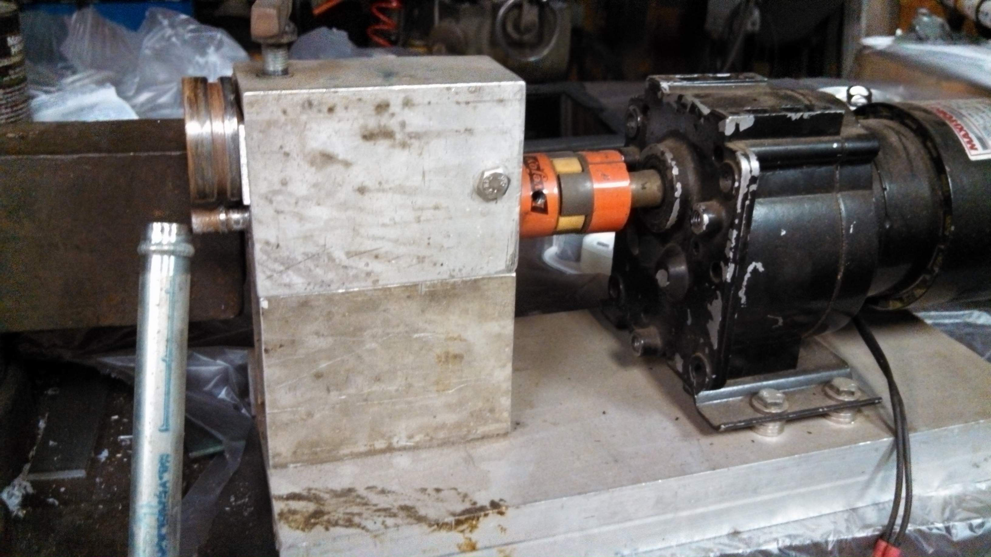

My 5 C collet closer would never swage a tube down enough to insert it into the same size. They are made to deflect thin tubing less than a 3, 4 or 6 jaw chuck.
I do have a tube beading tool that I built that might work on stopping a smaller diameter from going into a larger one.
I have only used it for keeping hoses on though. I have used it with copper, steel, aluminum and stainless. It only goes down to 7/16" but can go up to any diameter. The largest diameter stuff I have used it on has been for turbo pluming, 6".
This is what the results look like with EMT
Niiice, that looks like something I need..!!
