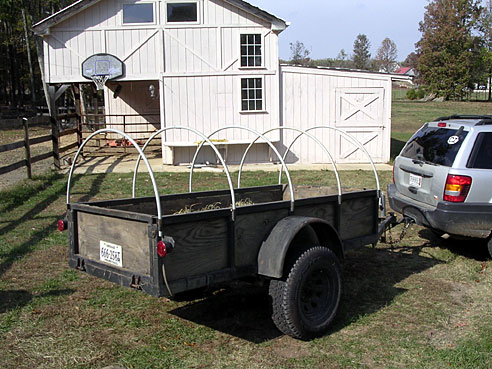

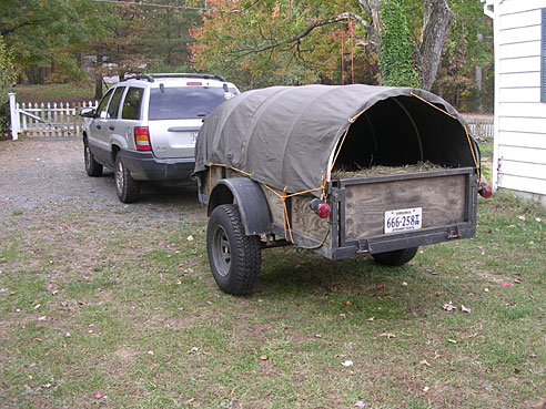

I did enclose my trailer for sheep transfer. To hold the tarp up, I used electrical gray conduit which is bit soft but it worked very well. The conduit slips into piece of steel pipe welded on the side of the rail.
If I used it more than once a year, I would make those loops out of steel, or at least the first and the last one, but this was very cheap to build and for the occasional trip to take the sheep on a date:) - it is good enough.
