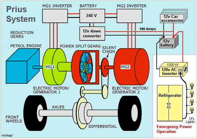

I'm sorry, my 30kW quote was from an earlier version of the Prius. Here's the latest version.
I found the article that you pulled that screen shot from...
FD Prius Power
If you read it, and look at the diagram, the owner is only running a 1000W inverter from the 12v battery of the Prius to power a small load, not 50,000W.
466918d1462071047-energy-storage-cheap-low-tech-prius-backup-power-gif
   / Energy storage, cheap and low tech. #42
   / Energy storage, cheap and low tech. #44
FD Prius Power
That does not change the fact that there is net 50KW available from the engine / generator system. Conditioning it for home power is all that remains.
And no one has done that yet.
And if they do, from some quick web searches, to produce 50KW it has to run at 5000rpm. Typical Prius owners report their engines are running anywhere between 1000 and 2500 RPM at 70 MPH. So 5000 RPM is like running your Prius at 90+ MPH. Who would want their car sitting in their driveway running at 5000rpm for hours or days at a time? Its only got an 11 gallon tank. It would drain it 3-4 times a day and it would be the equivalent of running at 90+ MPH for 24 hours, or about 2000 miles! Who's going to want to put 2000 miles of hard wear and tear on their car each day and suck down 40+ gallons of fuel?
