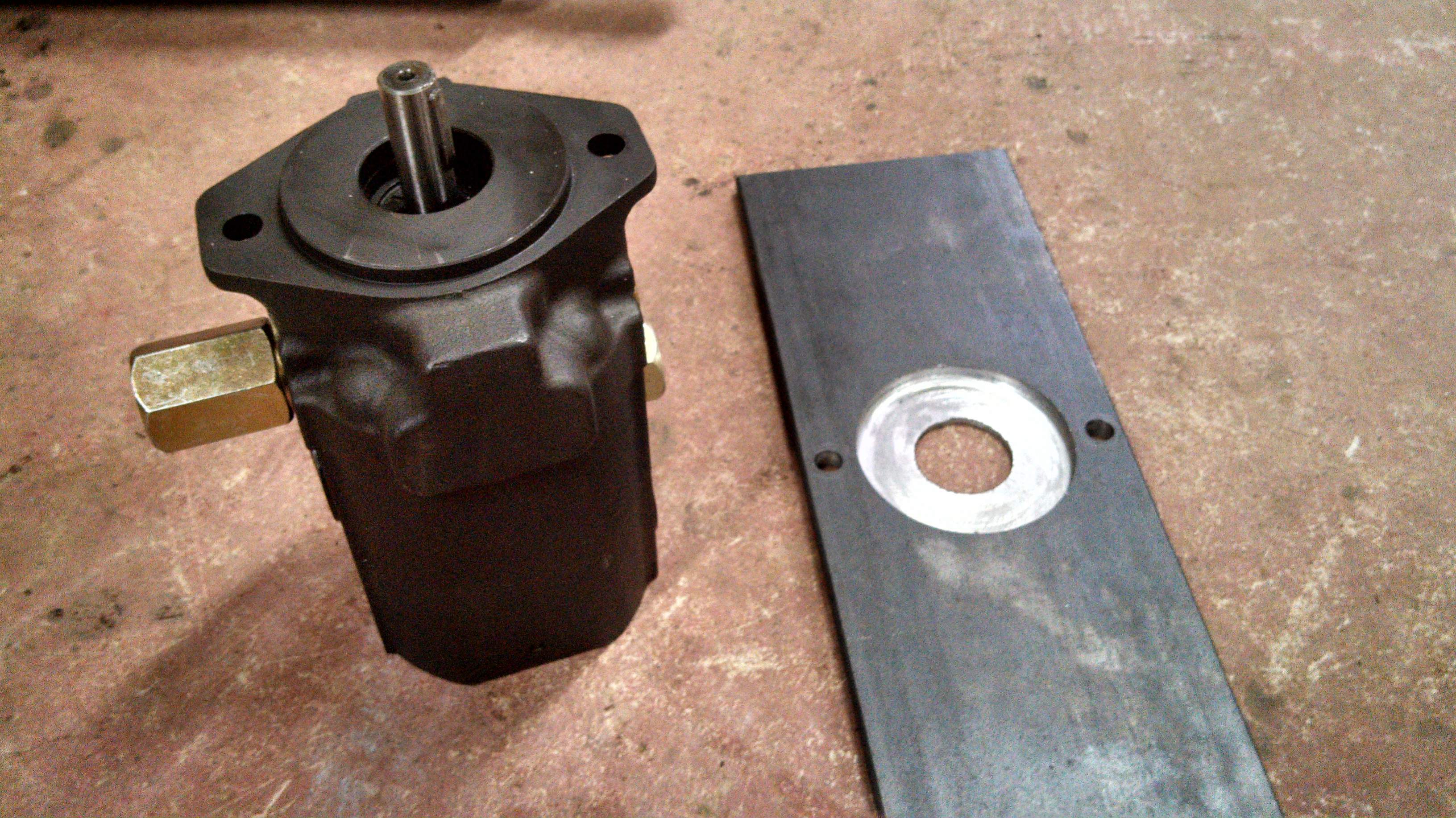

Oh, and here is some pics of my pump mounting:
