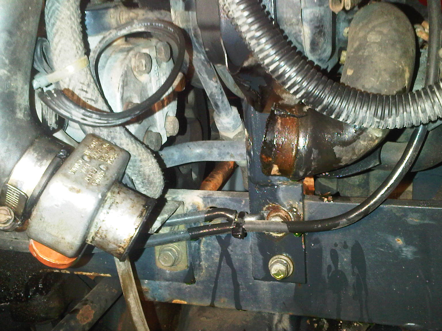

Hi. This is the inline heater that i have installed on my MF 1140...works like a charm...will melt snow on the hood.
It is installed in the bottom rad hose. You simply cut it and install the heater.
I happened to have a pick on my phone since i was changing the water pump today.
Ordered a new water pump from the Massey dealer...$300 plus shipping...OUCH. The lower rad hose is $50.
