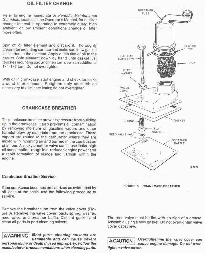

The attachment is a picture of the crankcase breather on an Onan gasoline engine. After looking at it, I think my reed valve just may be stuck. Anyhow, the specs say the compression for the 16 and 18 HP engines should be between 75 and 115 psi. If yours is smoking, it's probably either the rings or the crankcase breather letting too much crud into the carburetor. I have other specs from my Service Manual, so if you have any questions, maybe we should start a thread specifically about the Onan. Some other folks might want this info too. /forums/images/graemlins/smile.gif
