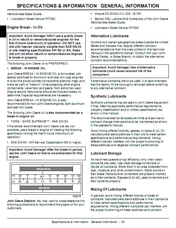

Maybe this will make it clear as mud.

My JD Manual for the 6420 says to
"Diesel Engine Break-In Oil
New engines are filled at the factory with John Deere ENGINE BREAK-IN OIL. During the break-in period, add John Deere ENGINE BREAK-IN OIL as needed to maintain the level.
Change the oil and filter after the first 100 hours of operation of a new or rebuilt engine."
It goes on to give the types of oil (Specs for the oil to meet) that can be used if you don't use their break-in oil. It also warns against using their Plus-50 and certain other specs during the break-in period.
Leo
