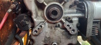

Hello: I think I have also stripped out my Kohler coupler.
How did you make out on your project?
   / Engine drive shaft coupler to hydraulic pump failure. Need help! #45

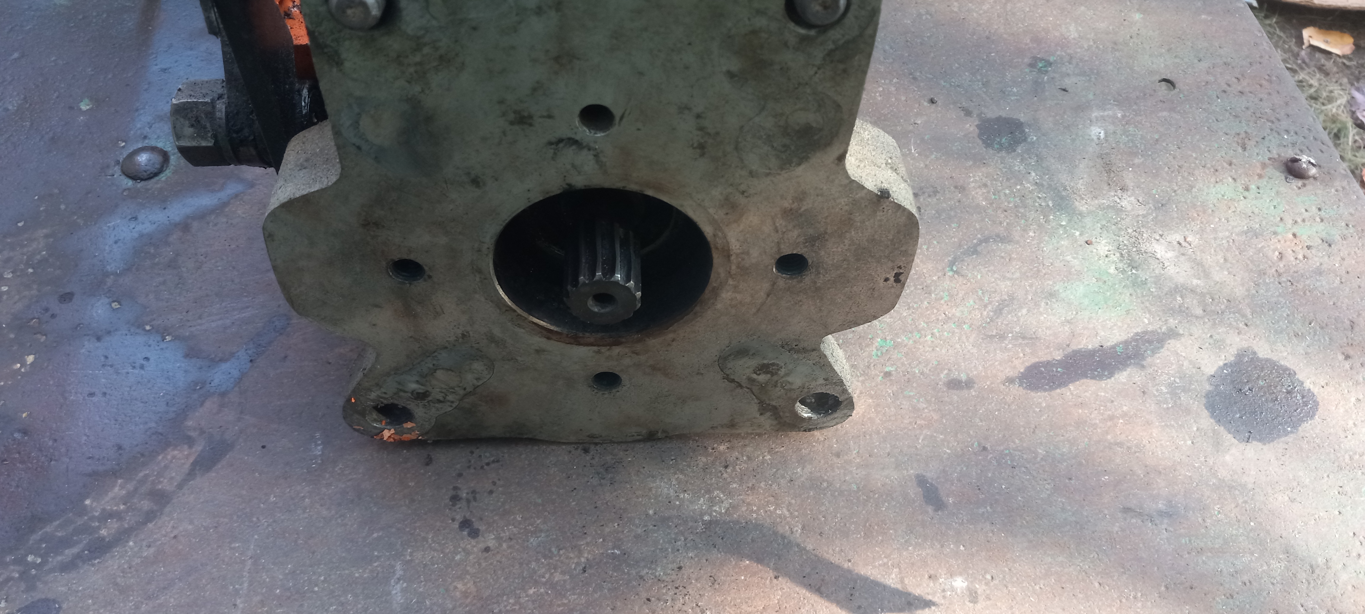

I ended up pulling the pump and it looks like the spines at the engine stripped out.
The splines on the pump shaft look OK.
Next is to order the part from Kohler.
