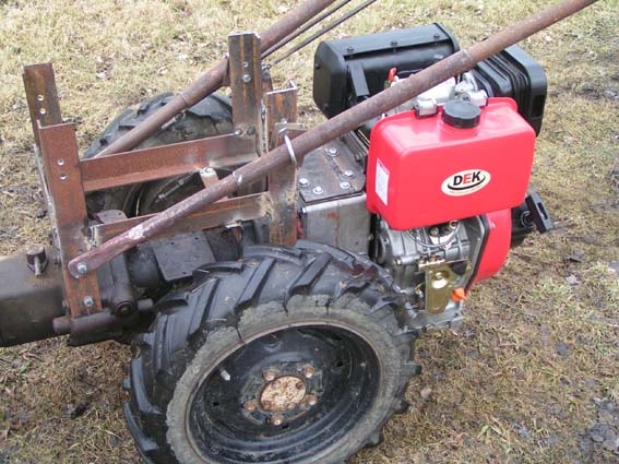

kris, in your travels what is the smallest engine you have seen someone put on an L?
/ Engine ideas #24
I did a search on the DEK diesels, I found lots of info but nowhere to purchase from. Any ideas?

Js5020- The smallest is probably a 13hp Honda. All of the people who I have seen repower go for higher hp engines ( more power arrrrh). There is a guy who put on a 20hp Briggs. The smallest engine that Gravely used is a 8 hp Kohler, which there is a brand new one on e-bay right now from an equipment dealer in NY. E-bay: Item number: 190071622246.

I have a daily user Comm 12 and for most jobs, except blowing wet snow the 12 Kohler is more than necessary, and it's so tail heavy. I was thinking the only things I would be using on this converted L would be the sickle mower, a power barrow, and maybe a 30" deck on the lawn. The original engine was a 5hp Gravely, but as we know the torque that engine generated will exceed x3 any modern 5 hp. I was thinking with these limited tasks I would try smaller than 8 hp.
/ Engine ideas #30
Js5020- I wouldn't go smaller than an 8hp. The 8 hp kohlers were not as tail heavy and better balanced than their 12 & 16 hp siblings. They were eqivalent to the Gravely engines in balance and power. A smaller engine might not be powerful enough and you would be severly limiting what you could do with that machine. - Kris :)
