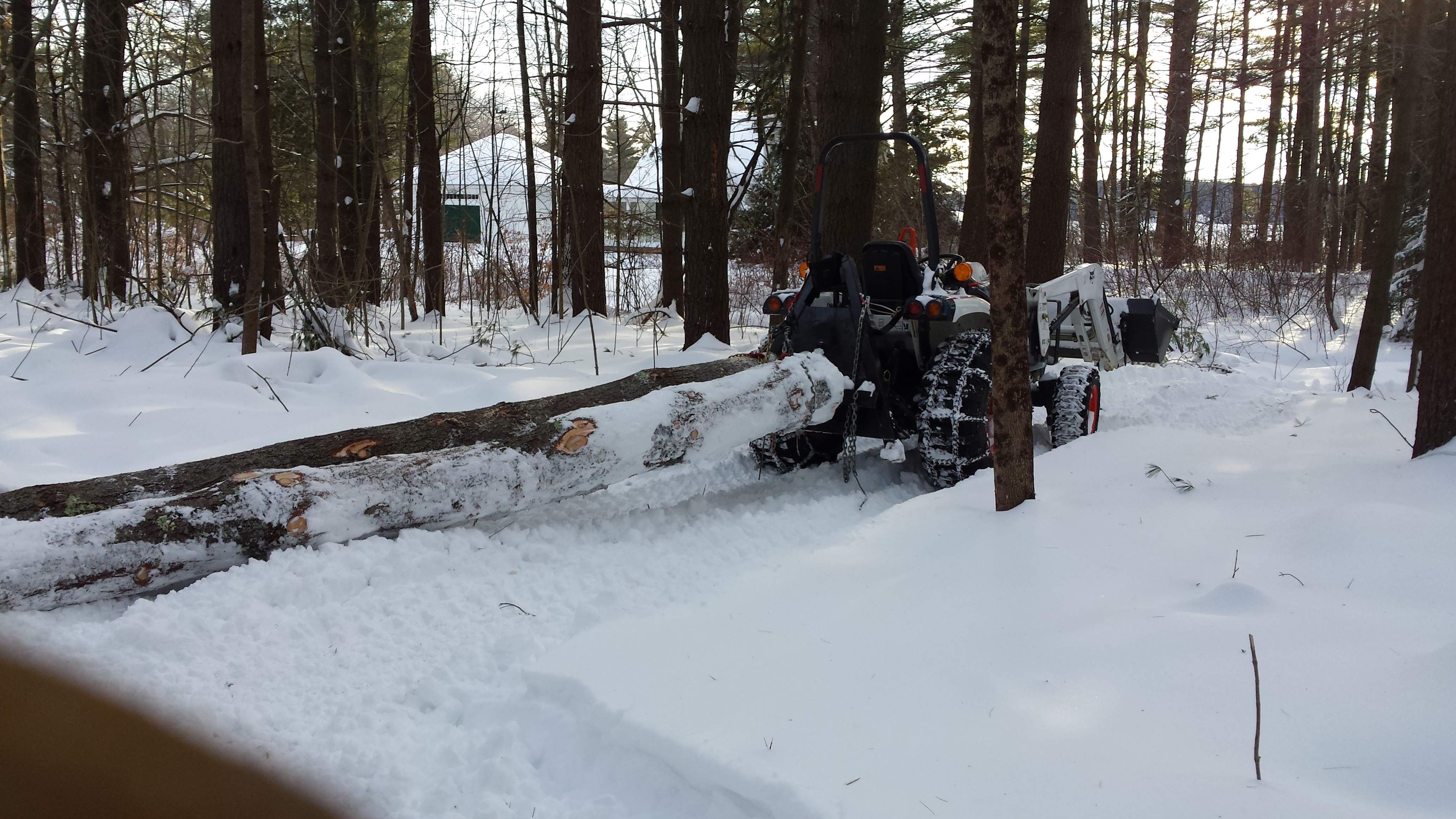

Since my last post I have racked up another 50+ hours, mostly pulling saw logs for my bandsaw mill. The Bobcat tractors are very well made, comparatively to Kubota I really appreciate the extra weight, in some application (bush hogging) which I don't do I think the extra weight might be a hinderance. The ct335 can easily pull 2 17' long 20" pine logs over some pretty uneven ground, after breaking my winch cable several times I have decided that 1 log going slightly faster (mid range 2-3-4 gear) results in just as much wood by the end of the day.
As of right now I have around 4000bf of pine pulled out in just a little over 2 days, plus some firewood. As of late the 4+ feet of snow has made going pretty slow. Even with the R4 tires and good chains I was able to keep my twitch trail open with 30" of fresh powder.
The changes I would like would be slightly larger front tires, rear wheel weights (I don't need more weight with the backhoe but could use the extra weight pushing snow in the winter) & a hydro shuttle shift.
I originally had planned on using the tractor for a year or sell and upgrading however the more I use it the more I like it. If a clean ct450 came for sale locally I would'nt hesitate to move up. The backhoe is small but very useful.
