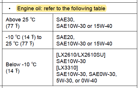

The manual says if between 14 degrees and 77 that I can use SAE 20 10W-30 & 15W-40.
Living in New England, the temperatures are below and above those ranges. I'm an AMSOIL guy and would like to use their oil but am not sure which to go with. Any suggestions? LX2610.

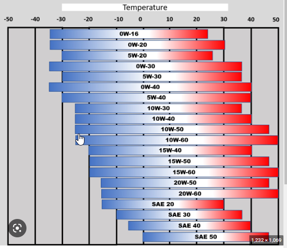

degrees Fahrenheit?? the operating temperature of the 15W-40 is way more then 77degree F ....15W-40 temperture chart is from -31 to 104 degree F

Fahrenheit

Fahrenheit
I see, they went pretty conservative on the temperature but its good. You can use anything between these 10w-30, 5W-30, 0w-30, 0w-40 or 5w-40 (even if not listed). If you only change your oil once a year and have extreme flux of temperature, go with the 0W-40 of even 5W-40 you have the best of both worlds. I personally always want the last number to be 40 in a diesel engine I use 0W-40 despite its price because I am in the same situation you are, having summer temperature in the 40 degrees Celsius and -30 degree Celsius in the winter. Many folks say the internal temperature doesn't go over 30 degrees Celsius regardless of the external temperature they may have a point and since your manual say you can put 0W-30 you can.
fist number = cold temperature viscosity coefficient and Last number = Hot temperature viscosity coefficient
All oils operate at 210-230 F as set by about 190 F thermostat in the coolant. Don't have a clue what those upper temps on the oil charts mean. Think they're for air cooled engines.
I do believe that those are the expected ambient air temperatures.
Doesn't make any difference. All oils operate at 210-230 F irregardless of outside temperature. Outside temperature has no effect on the hot oil's performance. Cold does.
   / Engine Oil #20
That is still the ambient temperature range that the engine is expected to operate in.
For most the low temp rating is the important point, unless your out in the desert in July.
