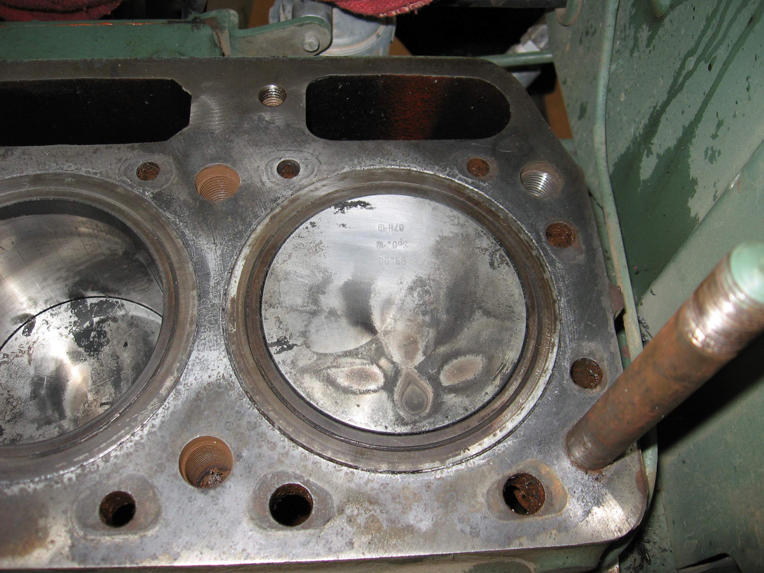

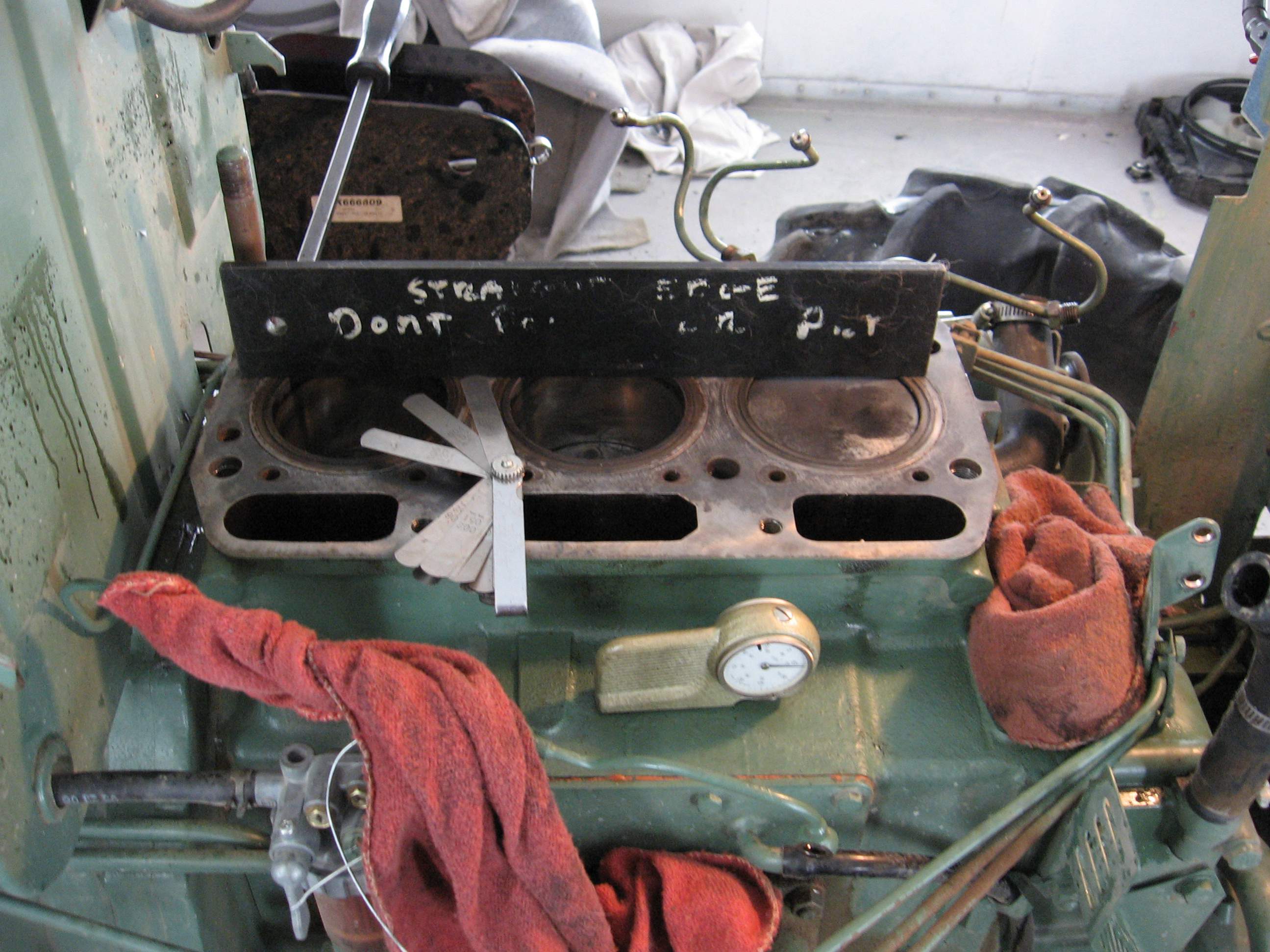

What you must be joking???? :confused: I cant begin to explain how many ways that is wrong seriously wrong.
Here is a pic of my engine when I had it down sorry I didn't measure the actual piston height for posterity and it doesn't show a side view.
I knew it had to be ok because it ran fine up till the HG blew which was the engine builders (hack) mistake of not checking or letting it slide the fact the head was out .009".
It is common btw for diesels to have pistons above the deck/liners that is how you get 20+ to 1 compression.
I had to turn the crank so the pistons were down to measure my liner heights (that what I am doing in the one pic) because the pistons are above the liners like I mentioned .019" sounded ok to me that you say yours are.
