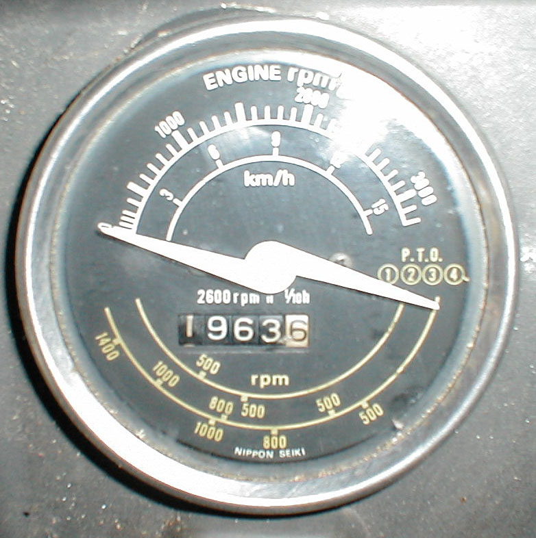

The YM numbers above YM2010 with multi-speed PTOs have a bit different hour-meter RPM tach PTO gauge. Even the YM4310 is way different too because of the OE Yanmar turbo.
This model has the 4-speed PTO
1=542
2=685
3=1005
4=1268rpm

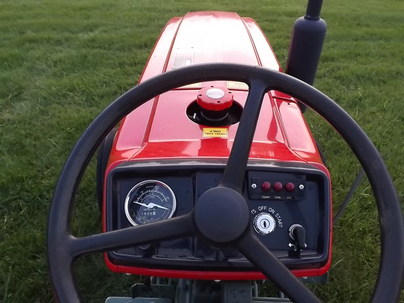

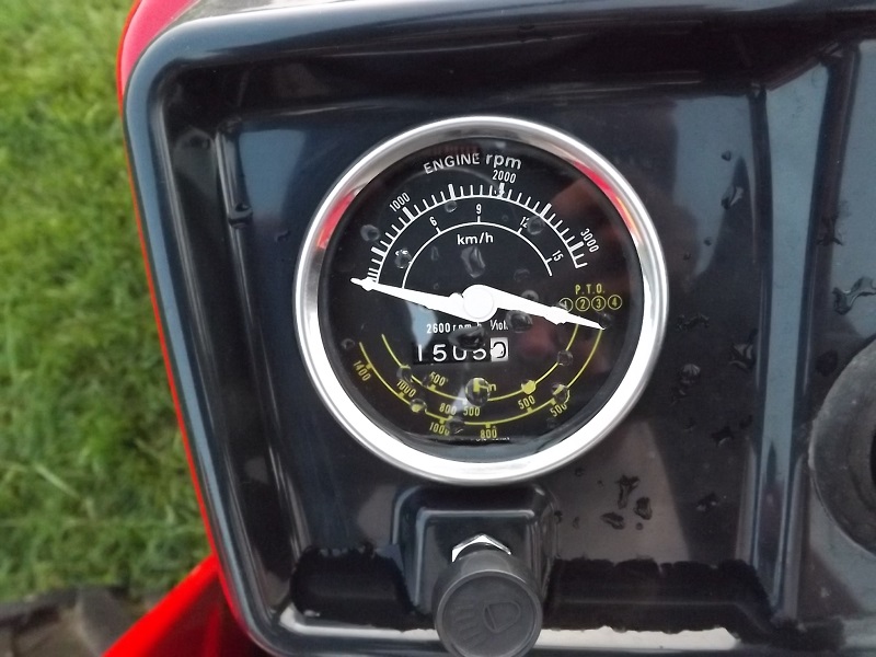

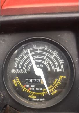

Here's one from a YM2500/YM2610
A YM3810 tach
A YM336 has a tach similar to the John Deere derivatives.
A YM2820 tach is square like the F/FX Series. The YMxx20 machines are really a different level of CUT.
A YM4220 turbo diesel has the same square tach as the YM2820
A simple YM1401 tach, too bad it has moisture on the inside. YM1510 has the same tach.
If you need to find out what Yanmar has what gauges, jump over to the Hoye site and look at the gauge panel for that tractor. There isn't a one-size-fits-all.

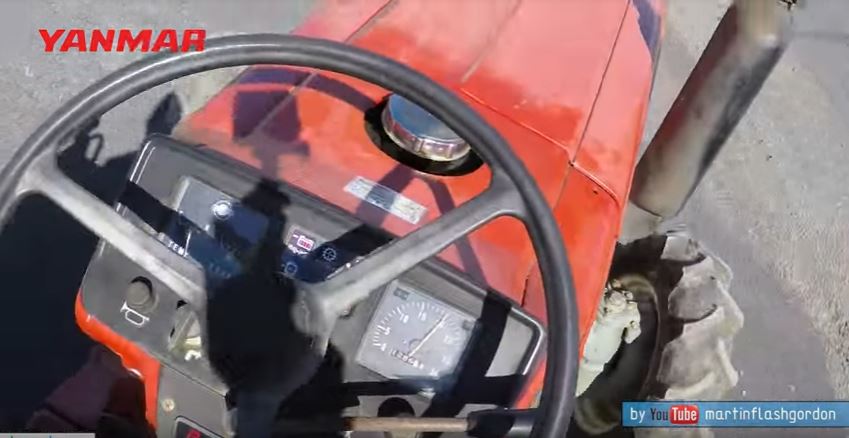

It all has to do with achieving correct mower blade tip speed, (some say OISHA mandated), and depends on gear ratio of the implement, (do the math). I believe a 4' rotary mower blade is generally 16,500 fps. (max 19,000fps for a 18" mower blade).
   / Engine RPM vs PTO rpm #16

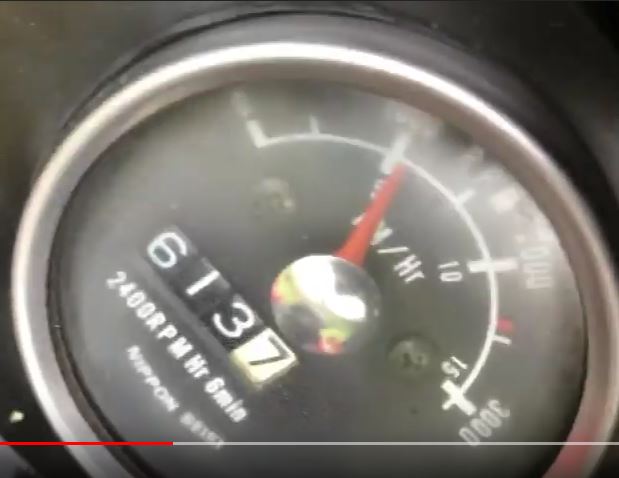

Do you see a little red mark at 2400 RPM on the tach?
That's your 540 PTO speed marking.
By looking at the other hour-meter and tach gauges, this information seems to be what you need. Now, you could back it down to 1800 if you like to keep both the tractor engine and attachment/implement to have a longer life. Just keep the blades sharp. Do you have an 'over-run' clutch on the PTO spline output gear? If not, PLEASE get one. It will save you $$$$ if the PTO breaks from an over-run problem.
