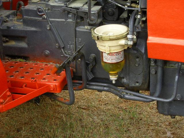

Just to keep all concerned in the loop, it simply cleared itself up, so it definitely was water. At the very end if you went sideways on a steep incline it would sputter a little and it would be the last of the water sitting in the bottom of the fuel filter. I could only make it do that about three times and it stopped completely.

I think it will come back! Missing only under load is a sure sign of fuel starvation, not water. If it were water it wouldn't matter if it were loaded or not, it would sputter constantly, especially at idle.
Since it only sputters under load it is a clear indicator the the engine's fuel demand/requirements go above what it is able to get. From there you just have to figure out why it isn't getting enough fuel, fast enough. It could be anything in the fuel system, from the tank outlet to something in the injection pump itself.

Just a few thoughts...
If you drain the tank, drain it through the petcock. Most tanks are designed to fully drain if on level ground. This would also give you an idea of the flow.
Watch where to check for "sucking air". Since you have an electric lift pump, it only sucks on the tank side, the other side is pressure...usually the filters are on the pressure side. The lift pump is probably somewhere under 10psi, so you might see a leak. If the filters are on the pressure side I don't see how the pleats could be sucked closed?
My 26hp L only uses a half gallon an hour at load and is only a gravity feed, just a trickle from the tank hose. So fuel usage isn't really that high.
It's a tough call on the actual problem, one of these things you do a bunch of stuff, then it starts working and you don't know what it was. It also sounds like an air problem. I ran mine out of diesel once and it took several tries to get it all out. I was surprised at this.
For the water I had one of these laying around.
Good Luck,
Rob

Some points are being overlooked, here. Although it would sputter under load, it was never consistent. In fact it was bad when it first started but got progressively better while still a significant burden. Also, it has done it at idle but only once.
The BX doesn't have a petcock. There are fuel filters on both side of the pump. The cap was never plugged because the sputtering was intermittent (I never did open it immediately after shutting down) but when I blew through the cap there was free air flow without obstruction.
I was Hoeing again today and it is fine. I really think it was water. Water in the bottom of the filters that was originally on the tank and as it depleted ended up as small quantities sitting in the bottom of the filters. It is remotely possible there is a blockage in the tank, but countering that to some degree is that when stationary, using the BH, it evades me how that blockage would get out of the stream. There is no counter force happening.
