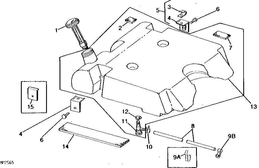

What happens if you disconnect the gas line from the tank (before the filter and pump) and just let it run into a container (with the tank cap on) for 10 mins?
That should let you diagnose a tank blockage or cap vent failure issue fairly easily.
Aaron Z
Okay I tried that with about half a gallon of gas in the tank. It is just dripping out. I took cap off and same drip flow. Is that the problem? I would think it would flow much better then that? I will replace gas line. How do you clear the gas tank?
   / Engine stalls after 20 minutes, gas starved? #24
That is the problem, it should flow out freely. Can you shine a light into the tank to see if there is something in the outlet?
Your problem is either:
1. Junk in the tank plugging the outlet
2. Junk in the fuel line plugging it up.
Try blowing (with your mouth or low pressure compressed air) backwards in the fuel line and see if that takes care of the problem. Long term you may need to remove the tank to clean it.

If this is your set-up, I wonder if the drain valve which includes strainer and filer could be clogged. It is part # 11
This is my exact setup. I had the Kohler engine before. BTW the valve knob (part #11) only turns about a 1/4 of a turn and does NOT shut off the gas at present. Should it?
I pushed compressed air both ways from the tank fuel fill with rag wrapped around to seal and then from the hose line back towards the tank and that did it for now. Gas free flowing again! for now. I will probably need to take tank off and clean it and replace part 11 this summer.
