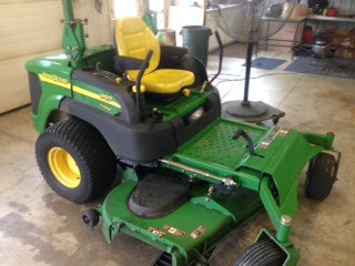

I have a JD 997 Ztrac with a diesel engine. it was driving me nuts last week when the machine would die with no warning, engine, blades everything like you shut the key off while mowing at 6 or 7 mph. We did the fuel cap thing, cleaned the radiator, cleaned the air filter. Called the Deere dealer for help and he said they never had heard of this problem. As a last resort I pulled the fuel suction hose out of the tank. It was plugged about 3/4 of the way. I cleaned it off and re-inserted the hose into the tank through the bulkhead seal. Runs like a Deere again, no more problems.
