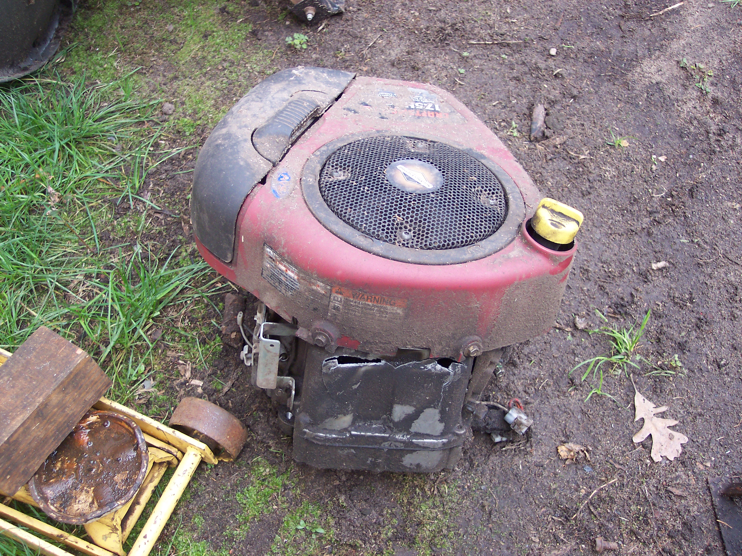

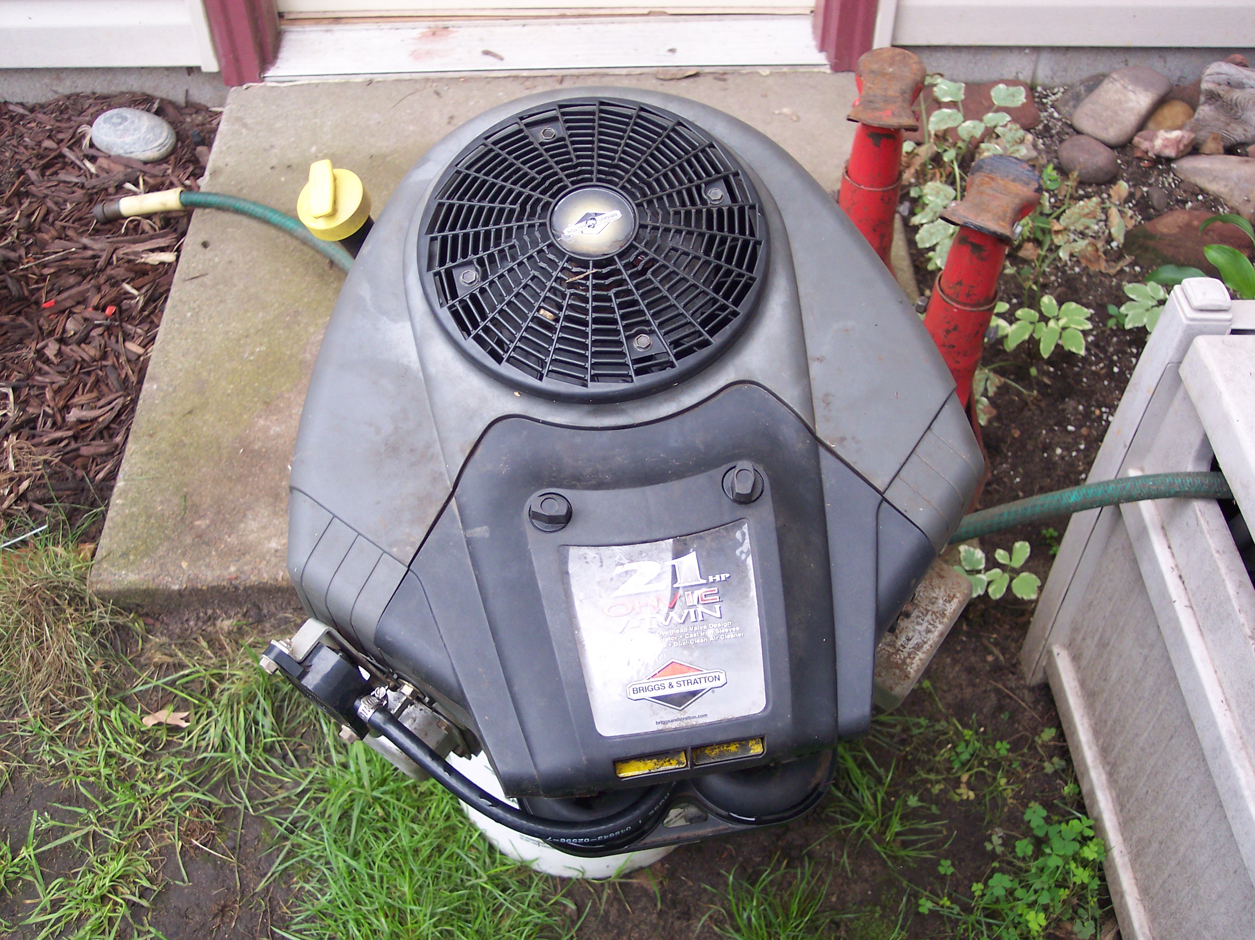

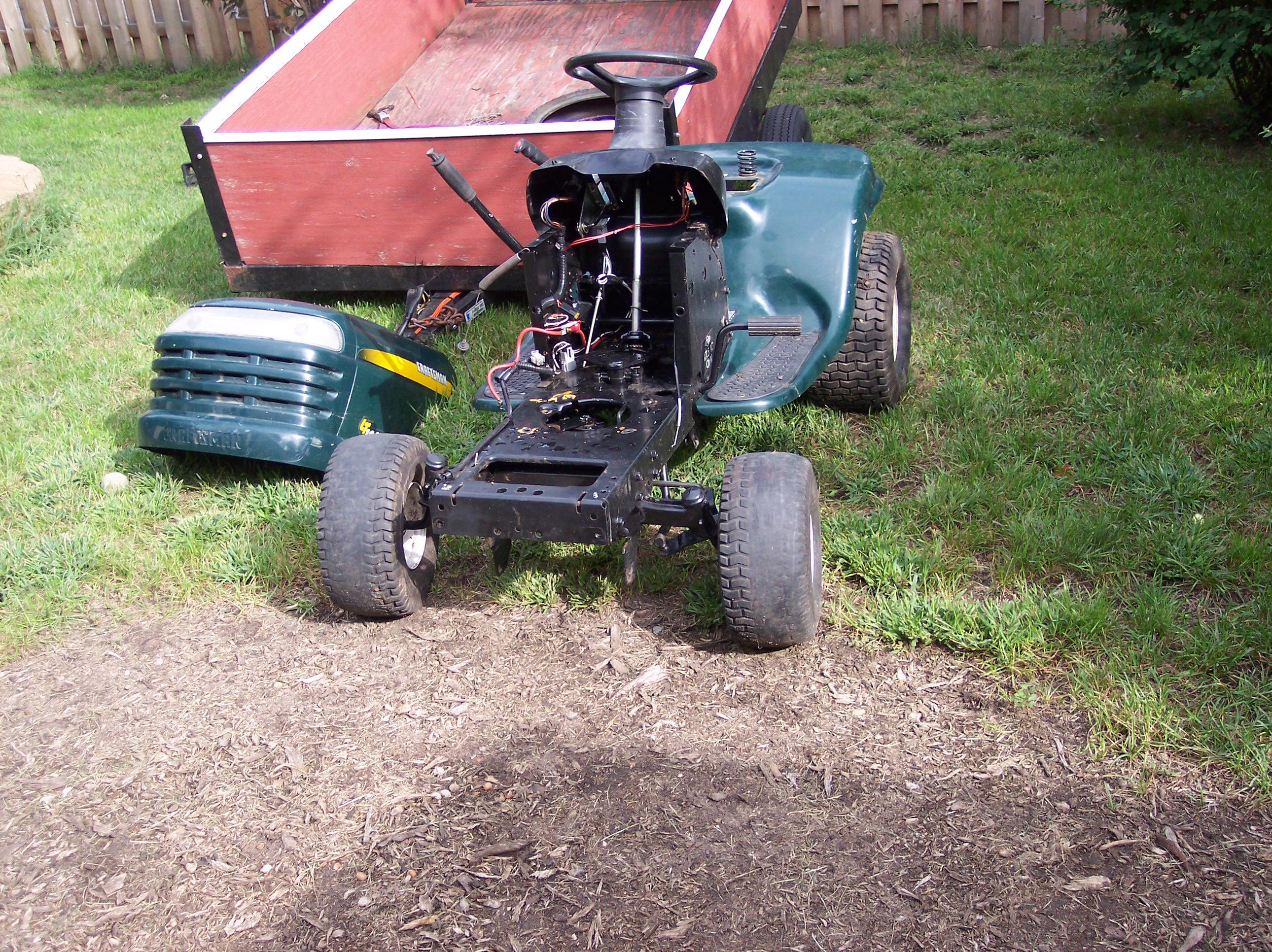

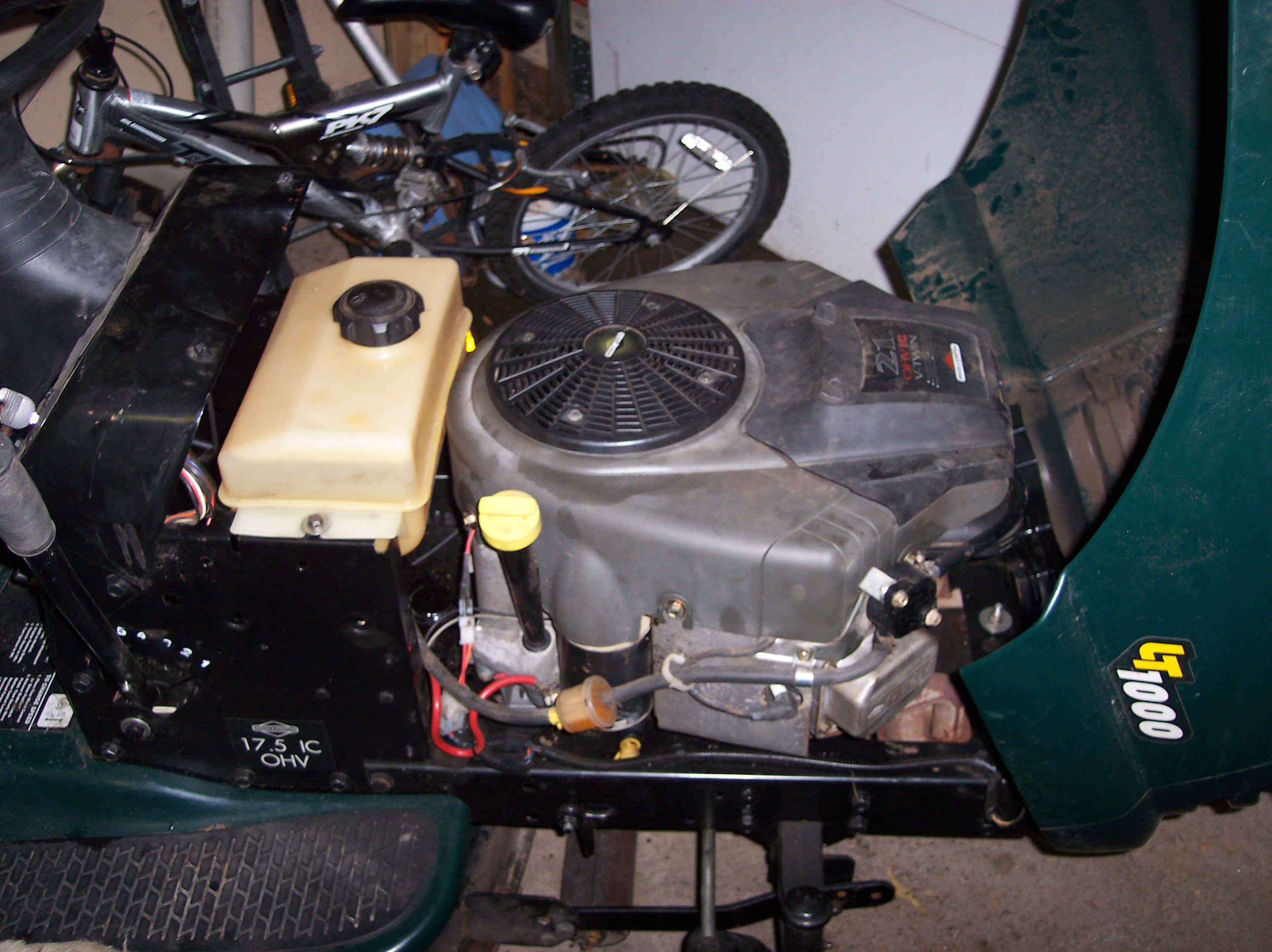

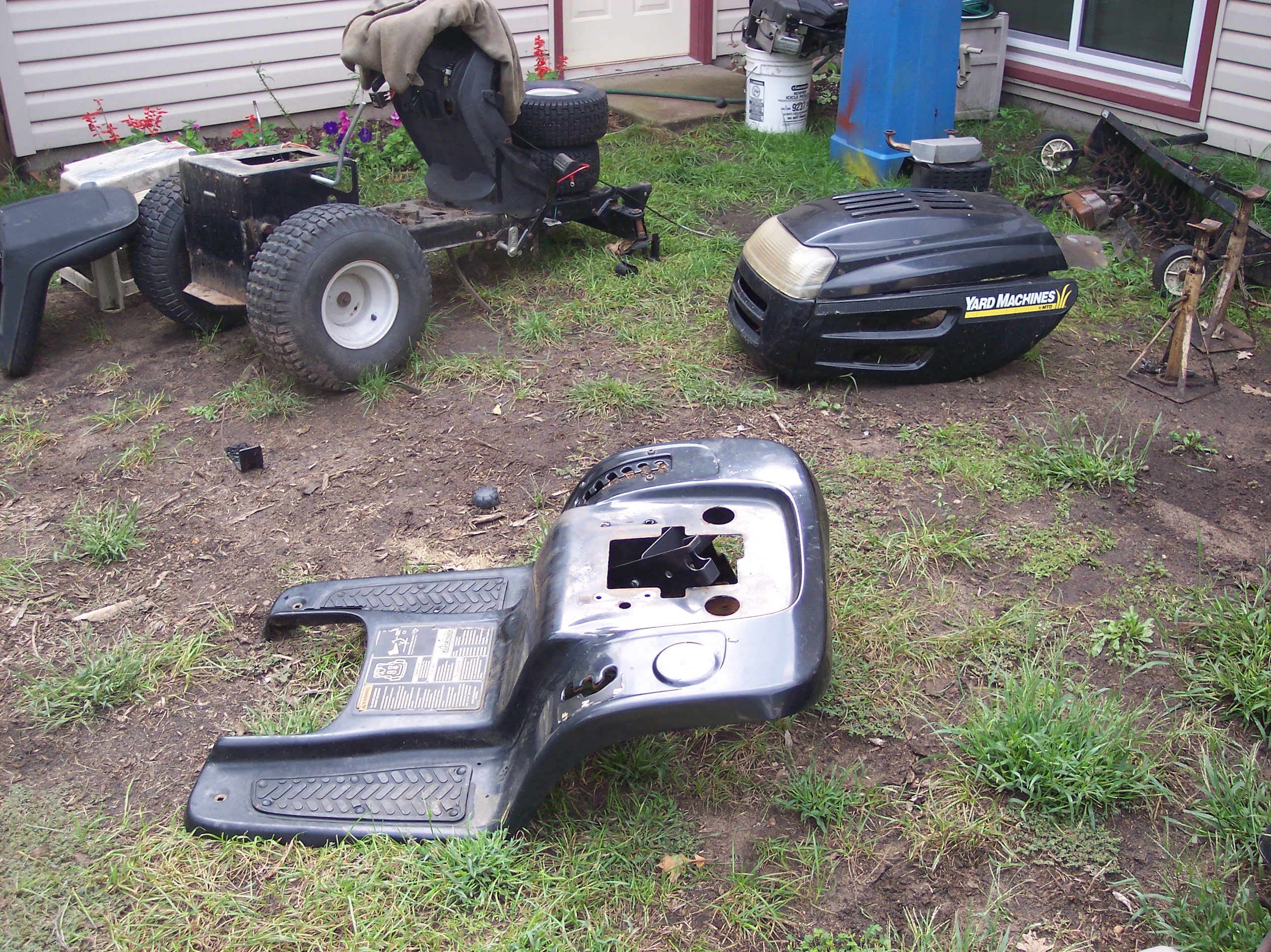

Here are a few pix. Derelict chassis, washed LT, blown single, good twin. The very worn Yard Machine had brand new front tires-amazing what people will do. Even though Craftsman isn't exactly a high end machine the difference in quality between the two is marked. Just the front ends-plastic bushing vs metal w zerks. I watched some videos about the hydro and will put the drain in to flush it. 100_0928.JPG100_0929.JPG100_0930.JPG100_0927.JPG

Yep, the twin will go in, easy? Usually both sets of mount holes are in the frame as the HOP is offered with the twin as well. You will have to fab the muffler mounting and hopefully will have clearance in the HOP frame. If not fab those pipes or figure them in the price. Longer throttle control cable, may be some choke mod or add a cable if it had a separate choke cable on the twin. The six pin connectors should be compatible however the single could have had a separate lighting circuit that can be redone. You may need to figure a new stack pulley in the price as the twin is likely a 1.125" shaft VS a 1" in the single.
/ ENGINE SWAP!!??
Holes match, exhaust might even fit frame hole, donor cables will work, electrics match, pulleys are same O.D. & height. Thought about cast axle(on C.L. here) if straightening doesn't work out. I'll see about mounting the bigger tank too. Ok guys I'm an old newbie! What do HF & HOP mean? Must be secret tractor talk!!??:confused3:

Ok, cast axle swapped in, fresh front tires from donor look nice. Will wait on any hydro work until I see how it operates. Ready to mount engine. Read a horror story by B&S worker stating management would do nothing about quality issues! This engine is an '03 so maybe they weren't shipping crap back then. Any fixes for known problems? Visible issues under valve covers? If Inteks are grenades what would be best replacement to hunt for? During my career wrenching at the U of MN I really liked the Onans on the welders I maintained. We had Cushman 3 wheelers too-their motors were robust as well but both horizontals. These projects are just to keep me occupied not make money. :stirthepot:

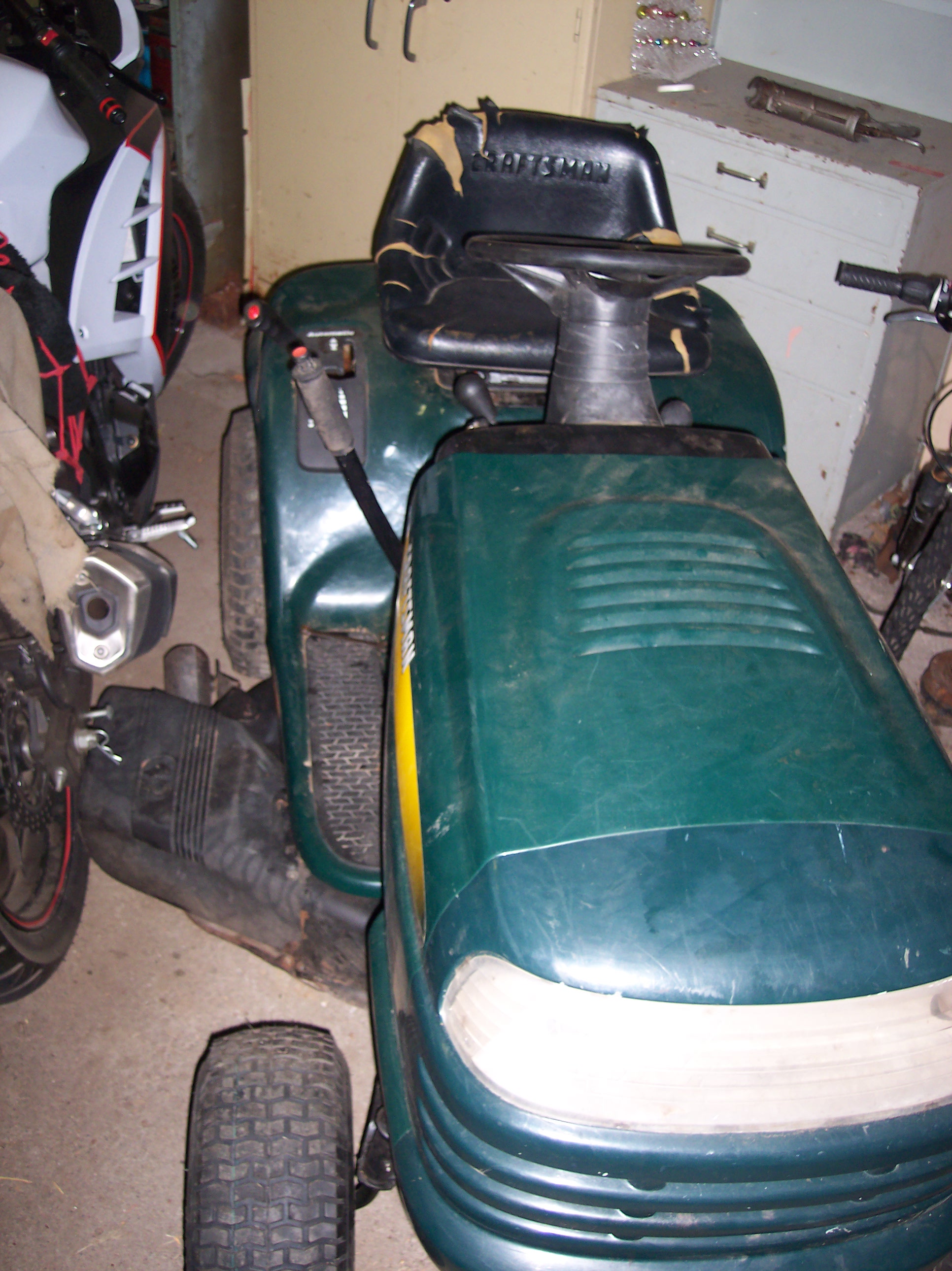

All done & ready to mow. New spindle brgs & blades plus a little paint on deck. The thing was obviously meant to take various motors so easy swap. It has been temperamental in the electric safety switching. It would start but die if brake released or pto lever moved. I unplugged and jumped the switches but it cranked wo firing. Plugged switches back in and now works normally. Do you believe in GREMLINS!. The seat's a little shabby but good enough for my butt.100_0931.JPG100_0932.JPG
/ ENGINE SWAP!!?? #18
Good job. As mentioned, this unit can take different motors. Mine has a horizontally opposed Briggs twin on it. Mine has a big fuel tank under the seat, the battery is where the fuel tank is on yours. I really like the variable speed on mine, I hardly ever use the clutch and brakes.
/ ENGINE SWAP!!?? #19
Looks like it was meant to be. Good job!
