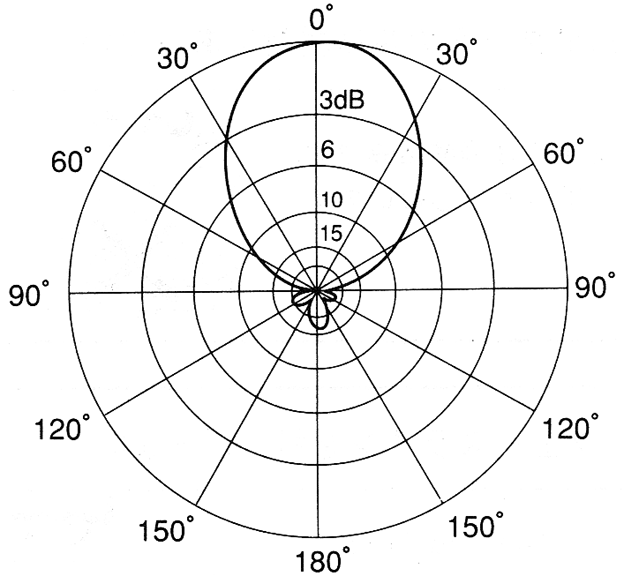

Here's a picture of what KUOA described in post #54 & #55. The antenna is redirecting the power in one direction instead of all directions.
   / Enhancing WiFi reception? #64
For those that might be interested lets analyze this polar plot a bit. Lets assume this is a horizontally polarized Yagi antenna and we are looking down at it from above. Although the pattern seems to be slightly skewed to the right from dead on, we can see that the 3 dB beamwidth is about 30 degrees to the left and about 37 degrees to the right from the bore of the antenna which is 0 dB. What does this mean? Well if you were an observer out in front of the direction the antenna was pointing if you were "dead on" in the direction the antenna was pointing you would have a reference signal of 0 dB. Now we didnt' say at all how much gain this antenna has or how much power was put into it or anything like that in this plot, it is simply a plot of relative values as observed by an observer at various angles from the antennas bore direction. If we move around directly behind the antenna we can see that the front to back ratio is 17 or so dB. The front to side ratio is even larger, but harder to resolve from this plot. Since the 3 dB beamwidth is somethig over 60 degrees in total this is a fairly broad pattern, meaning that this beam in not all that "sharp". The front to back ratio while significant is also not as much as some antennas are able to achieve. The approximate power ratio of the 17 dB front to back would be something like you would equate to the difference between a 100 watt signal and a 1.7 watt signal. If I was to guess at what we are looking at here, I would say this is a 4 or 5 element Yagi, but that is just a guess. I hoped this helped, and did not further confuse.
