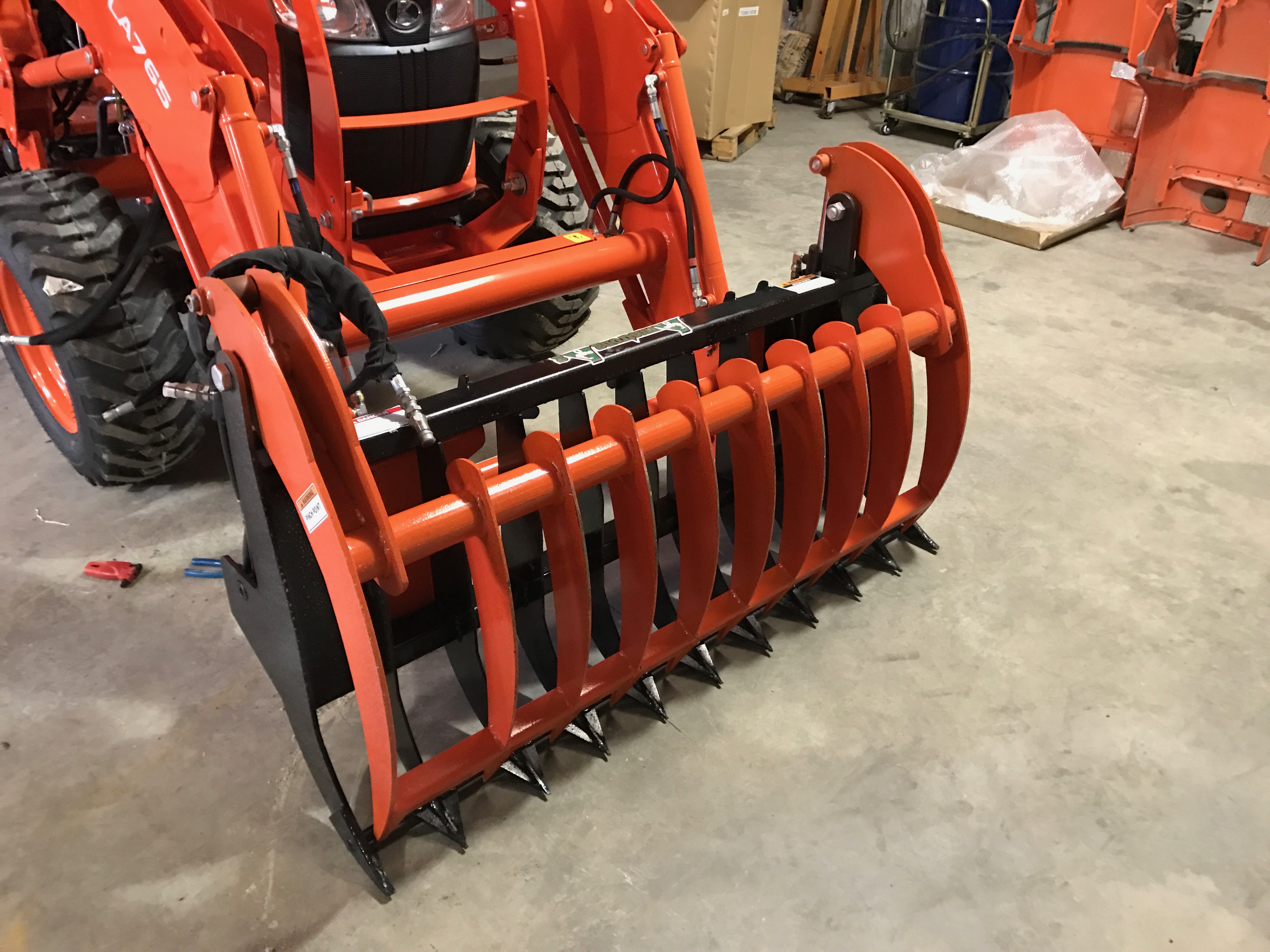

It looks like you have a closer to root grapple instead of the claw grapple the others have. Do you have any issues, difficulty picking up rocks with yours or do you do that? Did you make the specific decision to get your "root" vs "claw" grapple and if so why? I'm torn between the two and can buy either one from different place for about the same price with both of them being about the same weight and appear close in quality for price.

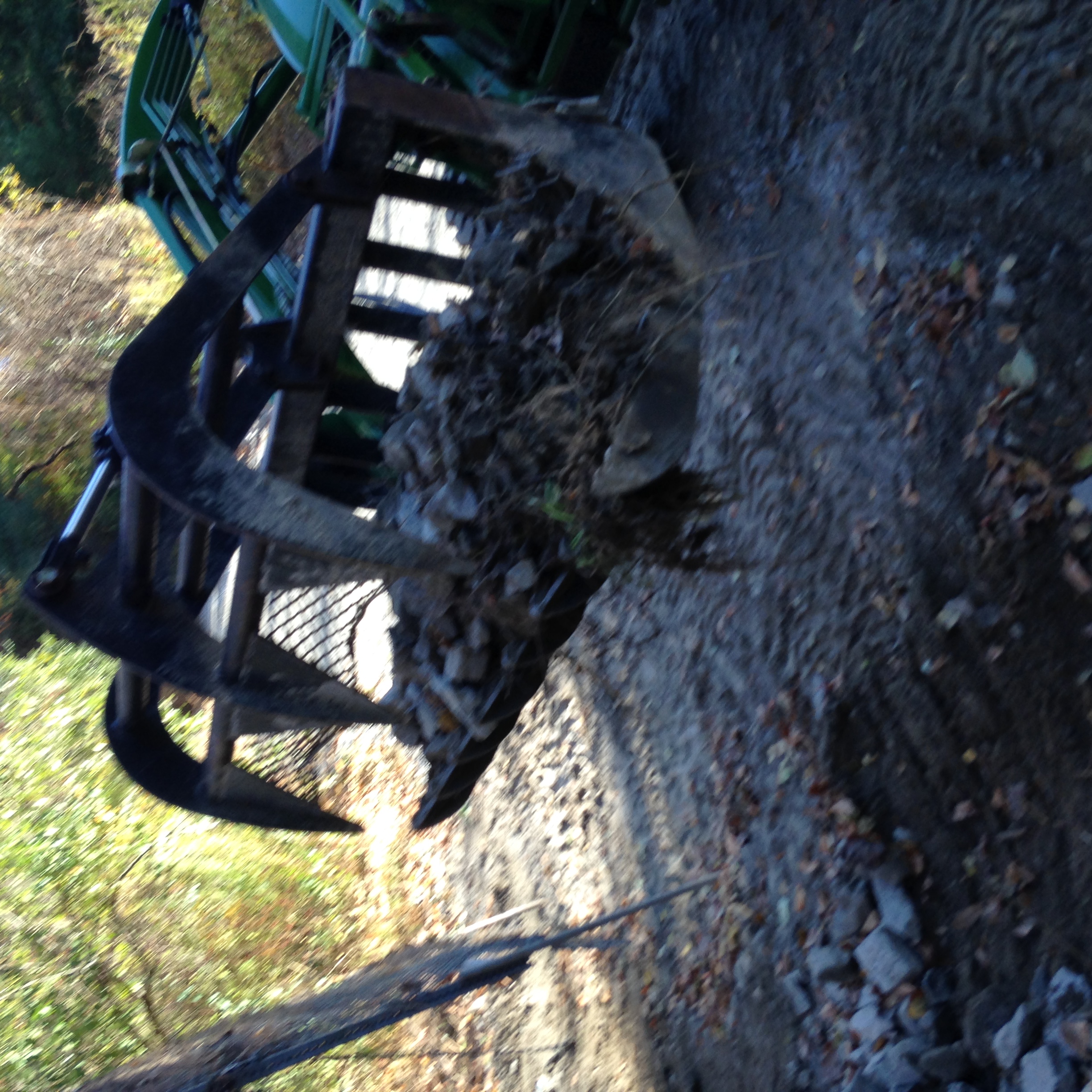

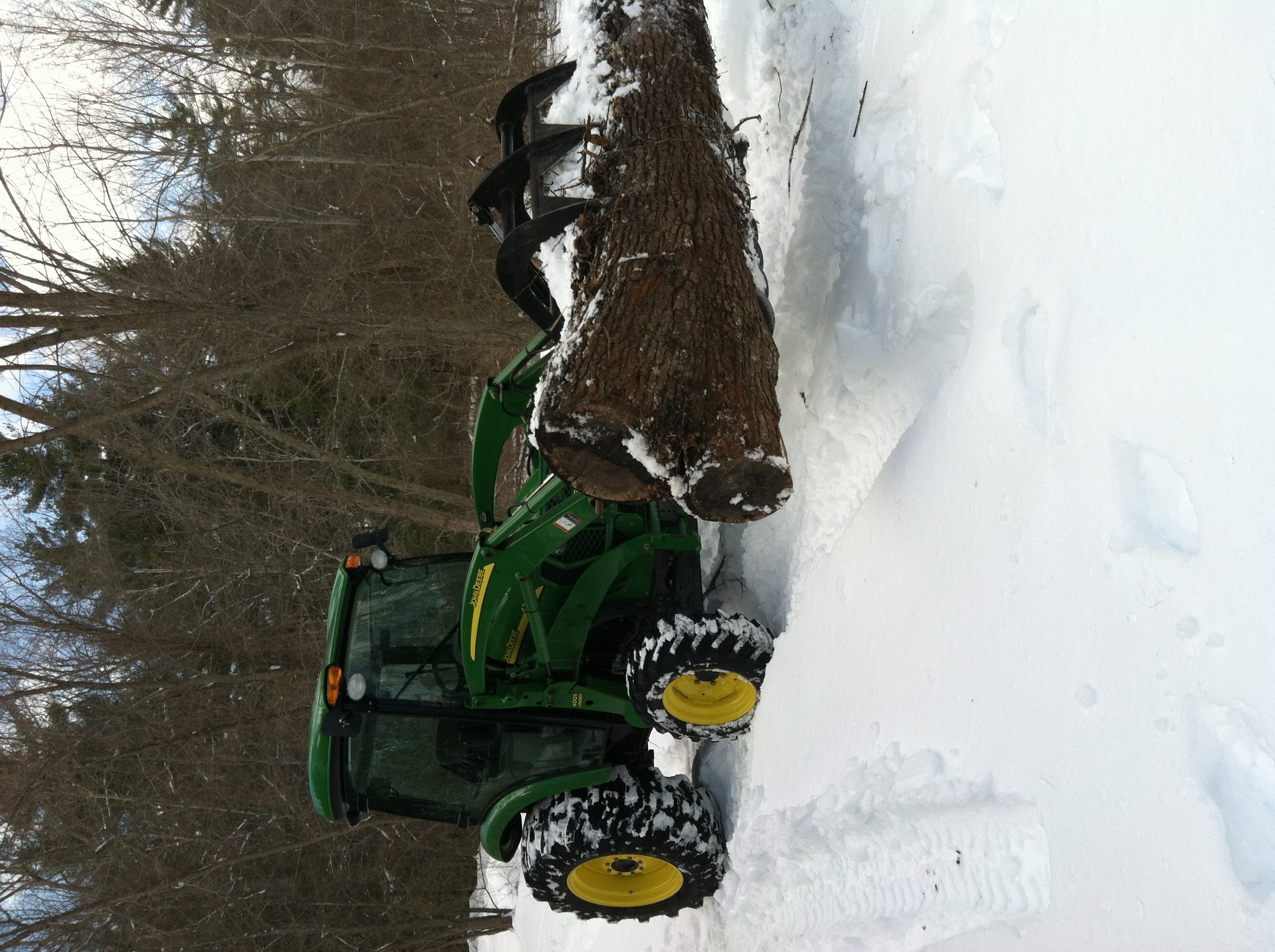

Yes John I have done my share of handling rock with this thing. IMO, very versatile. I don't see how these "Root" grapples with their short lower tines/teeth can effectively get significant rock out of the ground. Also as for stump removal I find the long lower tines are very effective for getting under stumps and their root mass. Again to emphasize-this thing is 1000 bucks-I don't thingn anything else comes close in terms of value Couple of more shots- one is one significant piece of oak- second shows it full of 4"-6" rip rap. This stuff was all silted in a drainage swale and I pulled it out.I had tacked some old chain link fence across the bottom tines to keep the smaller stuff from falling through IMG_0664.JPGIMG_2584.JPG

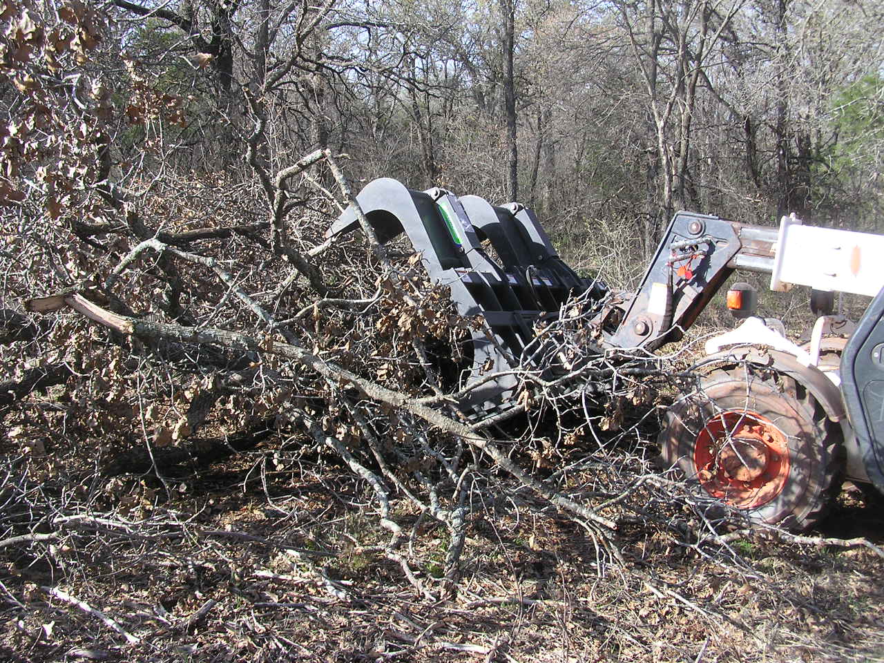

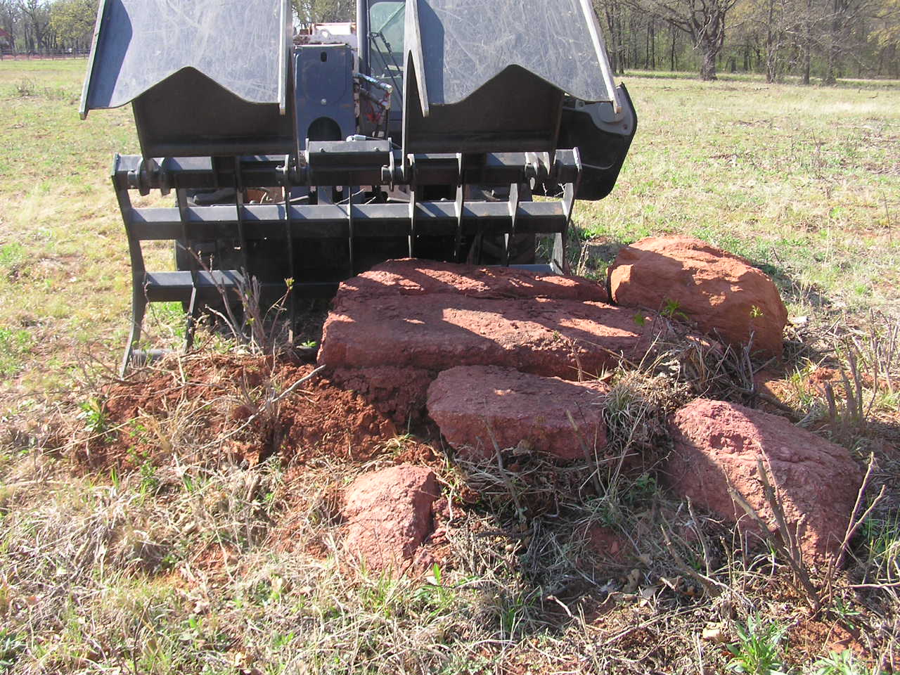

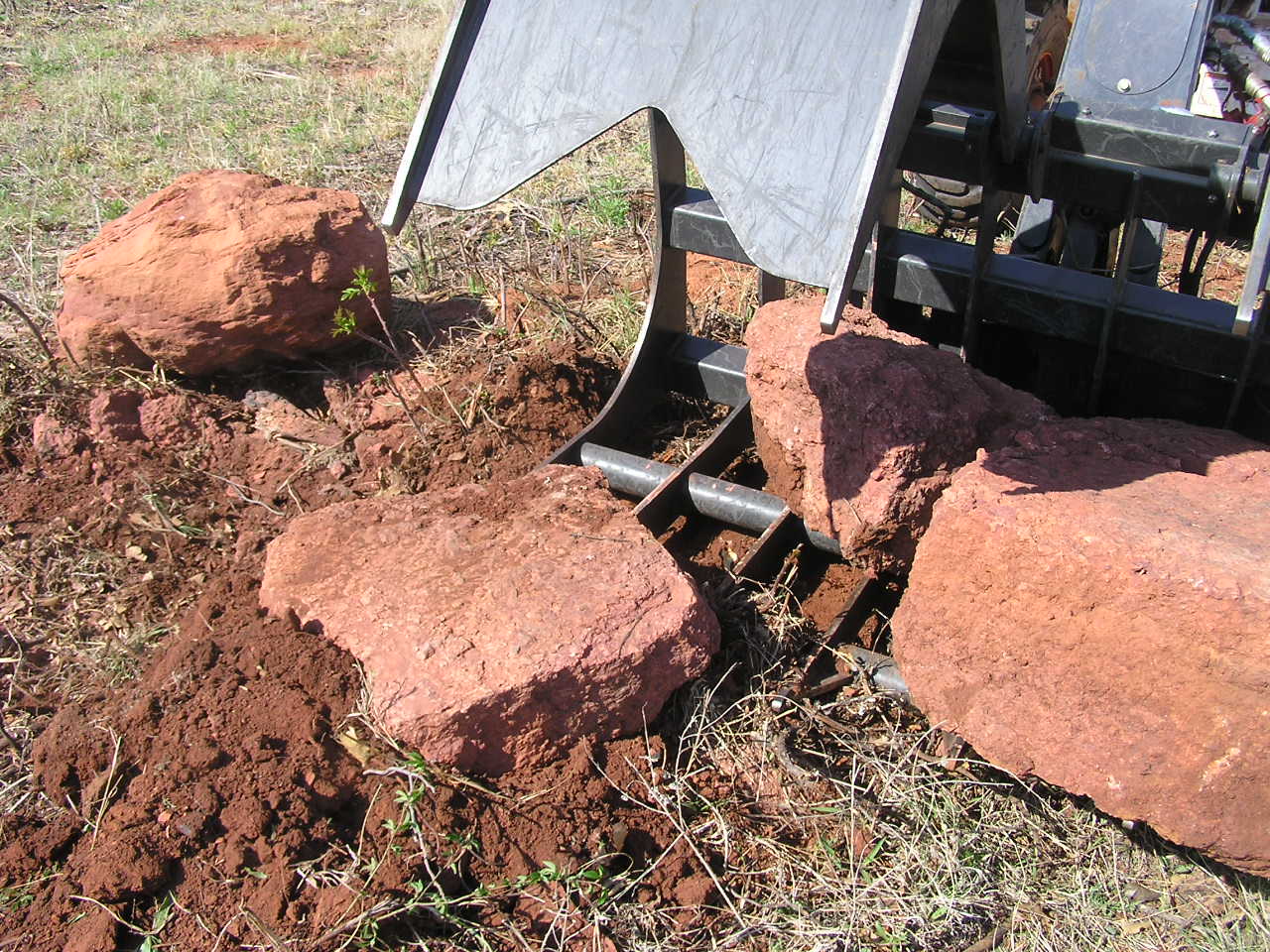

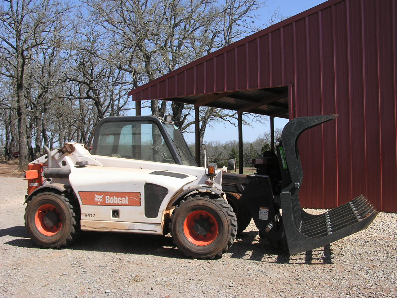

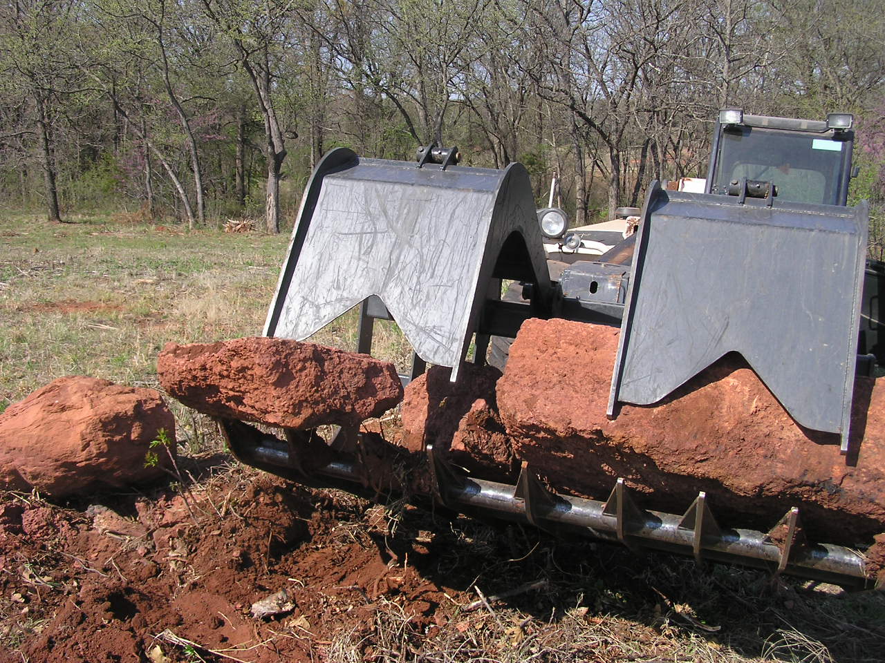

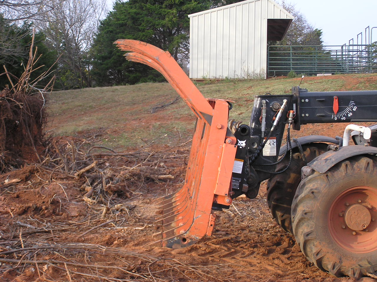

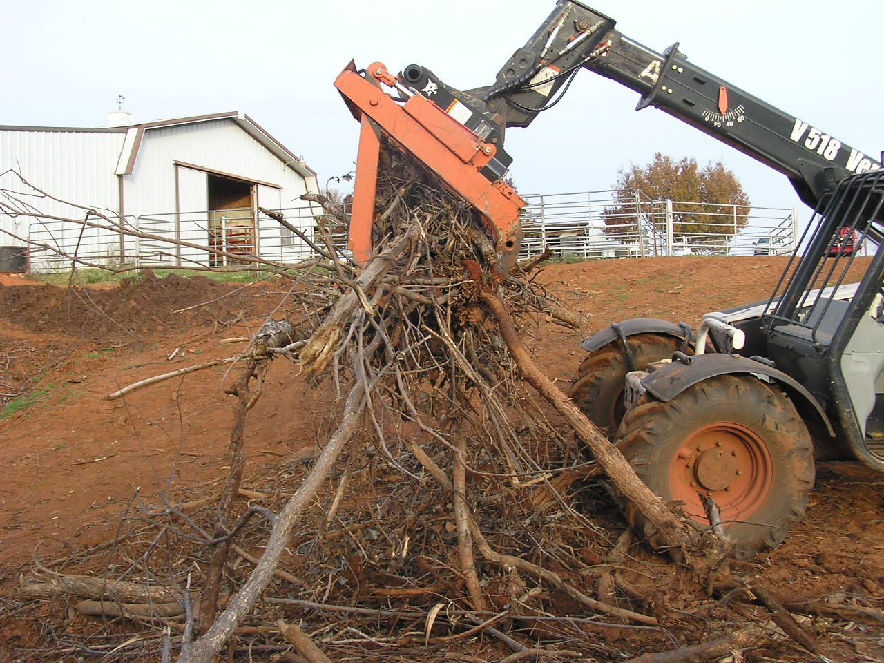

I have used both styles, and like the L bottom root grapple style best for brush and rocks.
Either one is better than none.
My first grapple:
My favorite style:

Thanks everyone who responded for info, opinions and pictures. I was and am still leaning toward the L shaped root grapple. Seems like it meets my needs the best with level to the ground, or slight tilt down, go forward, get under and then clamp debris or rocks. Maybe even furniture and lots of other stuff I move and carry around.
Would like to trade some of my gray limestone rocks for those (sandstone) red rocks!!!
I have some rocks the size of old Volkswagens and then on down to many 10'x3'x5' and then mostly 3' around round to flat and then the many basketball sized ones. I have shared some with my brother next door for yard landscaping, not the hugh ones!!! Had a dozer clear and level my homesite and he continued cursing my rocks and wanted to bury all of them. I told him no way!!! I did let him bury a few to build up the bank in front of my house where I had to get a septic tank in.

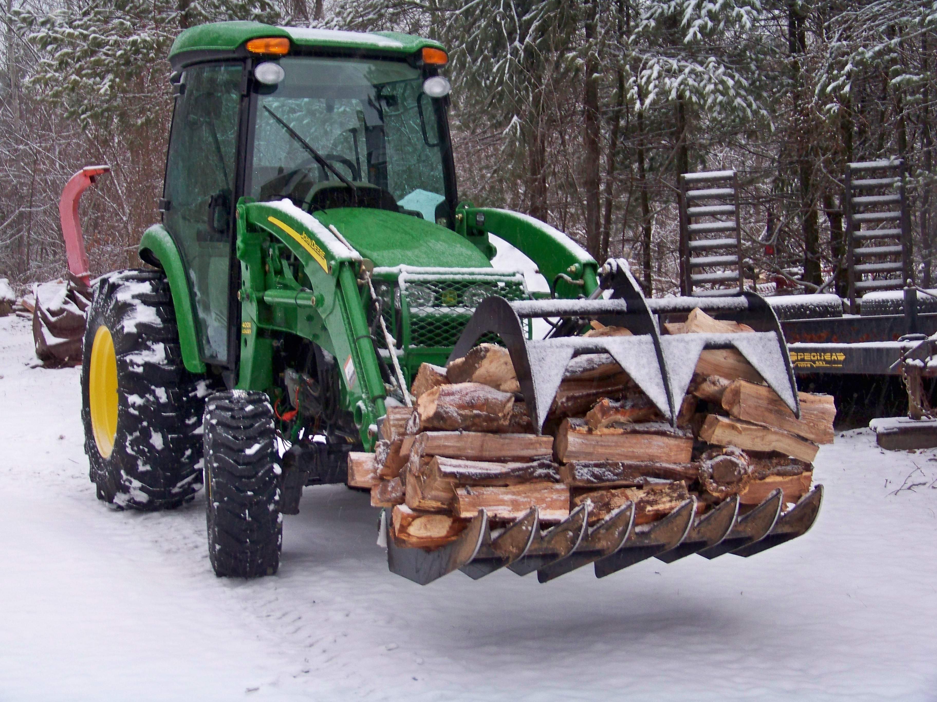

an opinion guys. Now that Landpride has ben purchased by Kubota, any price advantage they may have had is gone. I have had a Wildkat 48" Mini E series for about 4 years and I have to say to me it is the best value out there. check it out at MSattachments.com. One of its advantages IMO is you are not using a lot of loader capacity in excess steel in the grapple.
I have a Deere 4720 cab, loaded R-4s and about a 550 lb weight block. This "mini handles that power with no difficulty. Its a single center mount cylinder (less weight, fewer hoses to snag/break) but plenty of clamping force. The tines are very rugged and trust me-the width is not an issue-unless you are using it to pick up leaves! I paid under 800 bucks when I bought mine and I was jusdt on their site-now 999 plus freight.
Avoid the dealer mark up and save your self a few bucks.View attachment 490045View attachment 490046
