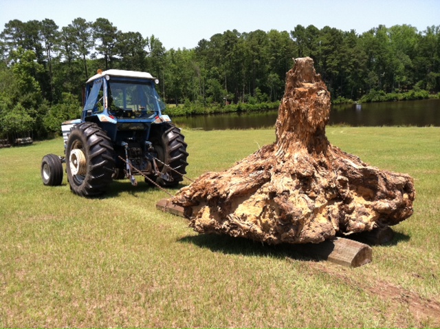

Here's how I moved my stump. Backhoe/loader dug it up but couldn't move it out of the pasture.
I'm pulling it with my TW-30 Ford. My 7610 Ford pulled it initially but I switched tractors to get better tire traction and not dig up my pasture.
The two sled runners are log flitches. It scuffed the grass less tha I thought it would.
I rocked the stump over one way and then the other way to get the flitches positioned underneath it, then tied a chain to each one and started pulling. It was easier than I expected. Took me about an hour to do it but it took a lot longer to get the inspiration for how to do it.

That's kind of like an improvised stone boat. I'll have to remember that technique, if I ever get a stump or rock too heavy to lift or haul to usual, brute-force, way.

well atleast you got it, that is a big stump (looks tiny compared to the old growth douglas firs we have here, but so does everything else)

put it pointy side in the ground and you have a huge table top.
