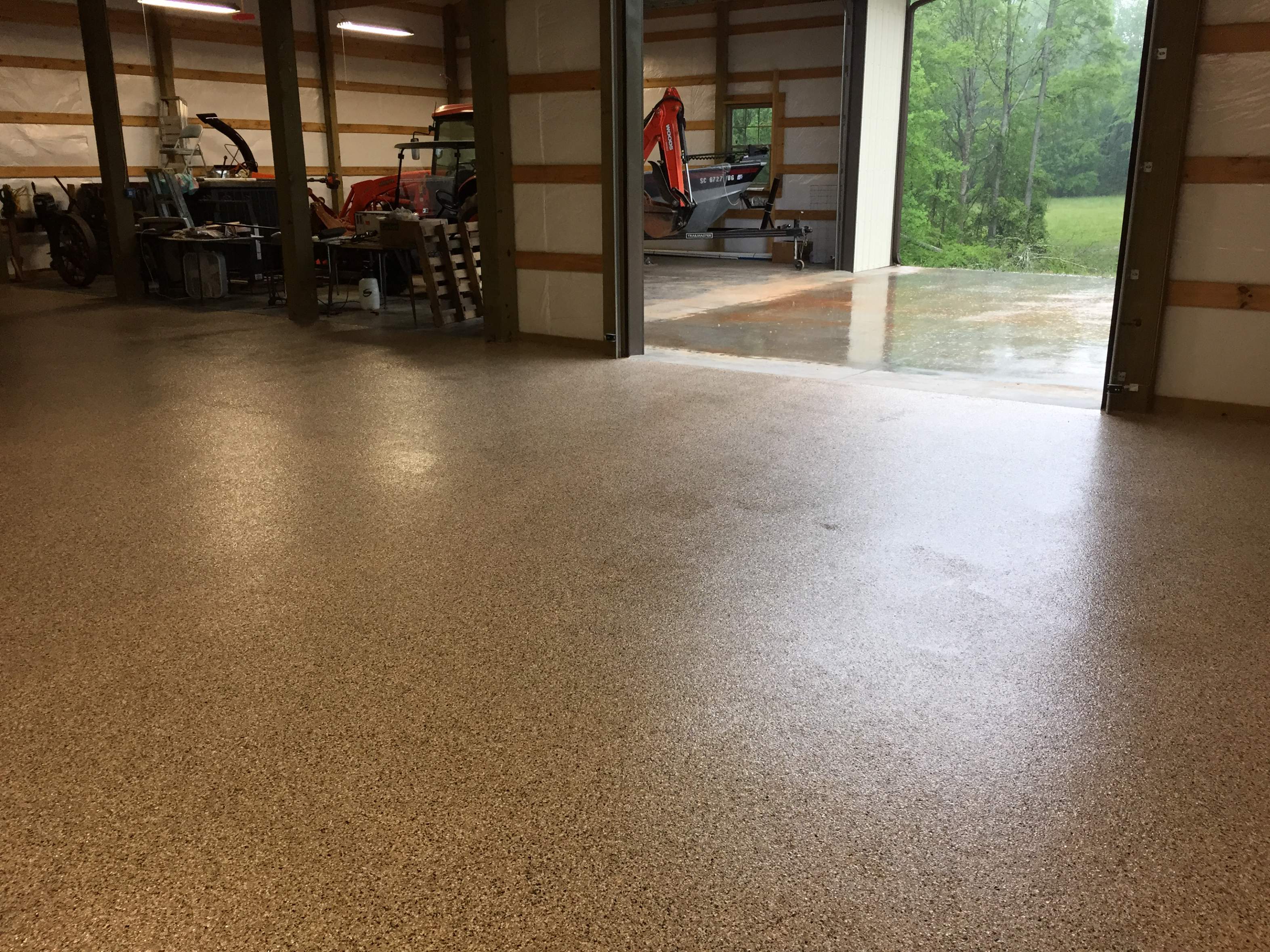

I'm considering putting down an epoxy coating on at least part of my barn floor. Considering whether to do myself or hire out. Seems a bit complicated to get surface pretreated correctly and everything so that you won't have chipping, or problems later, but maybe I'm overstating the complexity. Need to do about 3000 sq feet of floor. Quotes are coming in around $3 per square foot (for pretreating floor, epoxy, flakes, additional sealer over epoxy to strengthen and add additional vapor barrier). Anyone have experience good/bad/otherwise they can share?
Thanks

For $9000, no way would I have anyone do mine, unless I cyphered your post wrong.
I did my 22 x 24 approx. garage with Rustoleum about 14 years ago and love it. I had a breathing mask for laying down the etching acid, which was just mopping it on, neutralizing with baking soda and rinsing it off. Study on the safety precautions first though. When it was dry I got a two foot roller for the epoxy because you need to move to keep a wet edge. I added a little sand so it wasn't slippery. I would consider putting two coats on, even though they advertise it as one coat coverage. There were quite a few lighter spots that didn't cover well. Then after the second coat which covers very well,you just stand back and throw flakes up in the to the ceiling where you generally want them and they will be dispersed quite well.
I can't believe it will cost over $1000 and will really look nice.
I would just do a corner with the sealer to try it out because you shouldn't need any with epoxy. An additional vapor barrier doesn't make sense to me; it's just sealer.
I just want to add, I did a 4 car garage but only put on one coat and the owner was happy, but if it was mine I would have put two coats on.

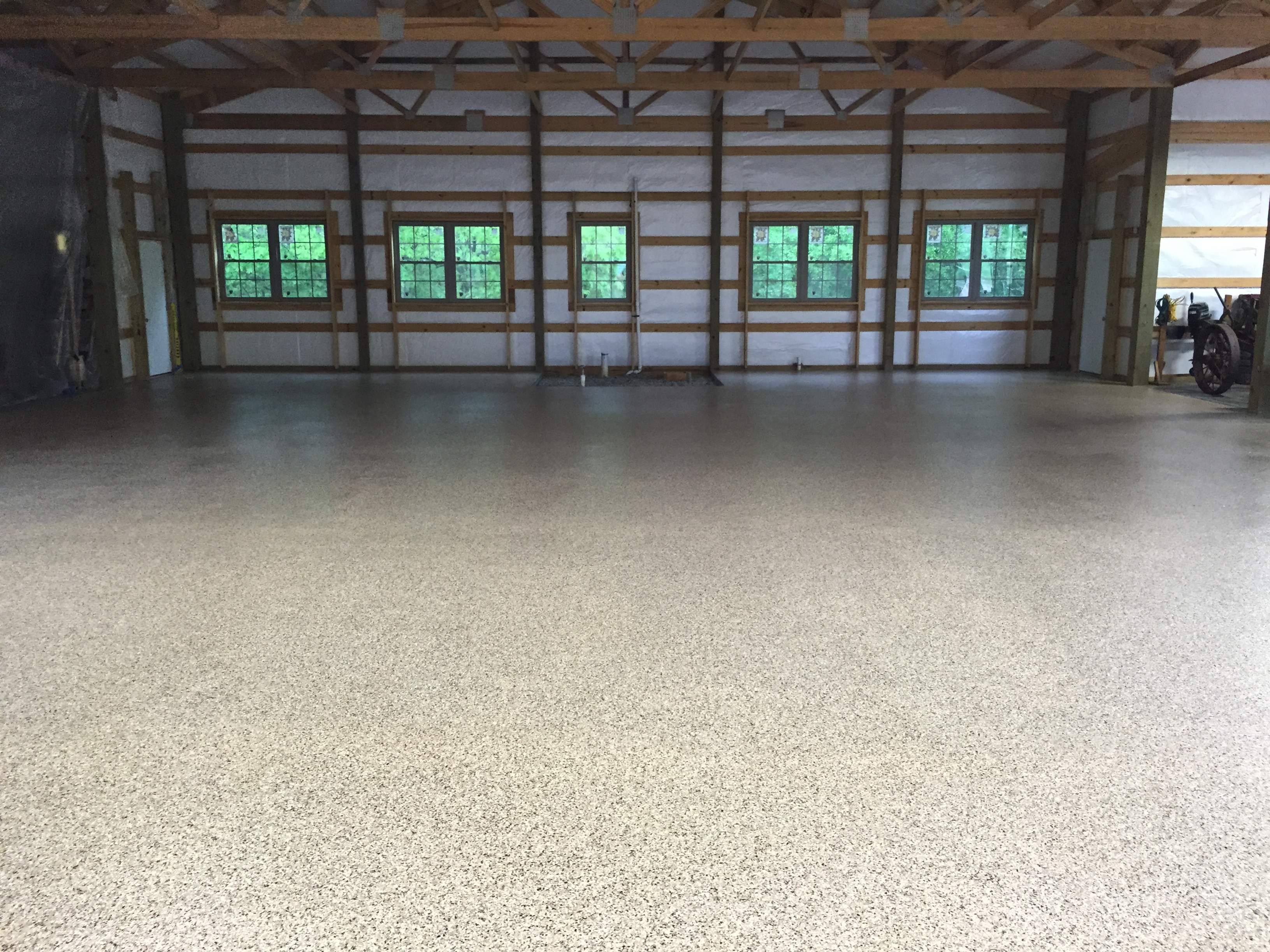

Jump over to the Garage Journal forum on flooring. Lots of free advice and days of reading to educate yourself. If you have a new floor, you are ahead of the game and can DIY for much less.
I did my 24x24 garage 8 years ago with Sherwin Williams brand materials. All in cost of time and materials was $800. I didn't etch, I did a diamond grind with a hand held grinder. Next time I'll rent a machine from Home Depot and be done with prep much faster.
