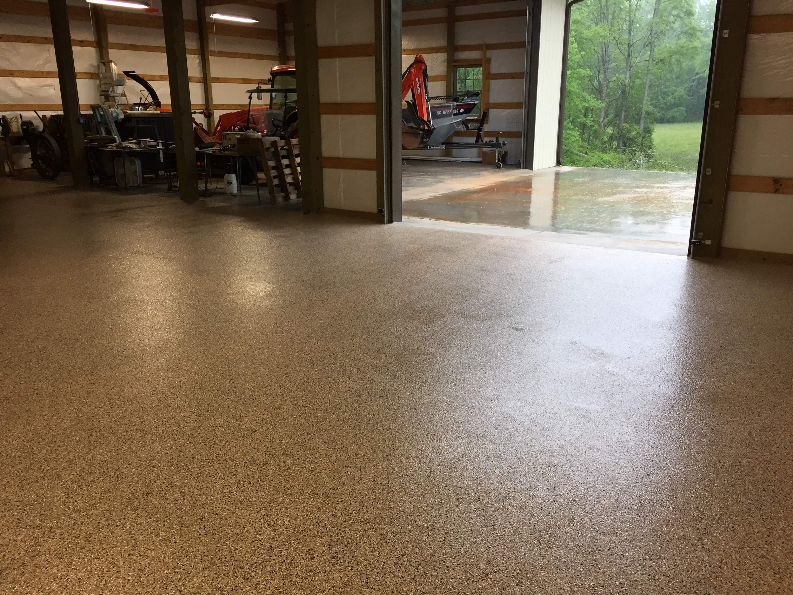

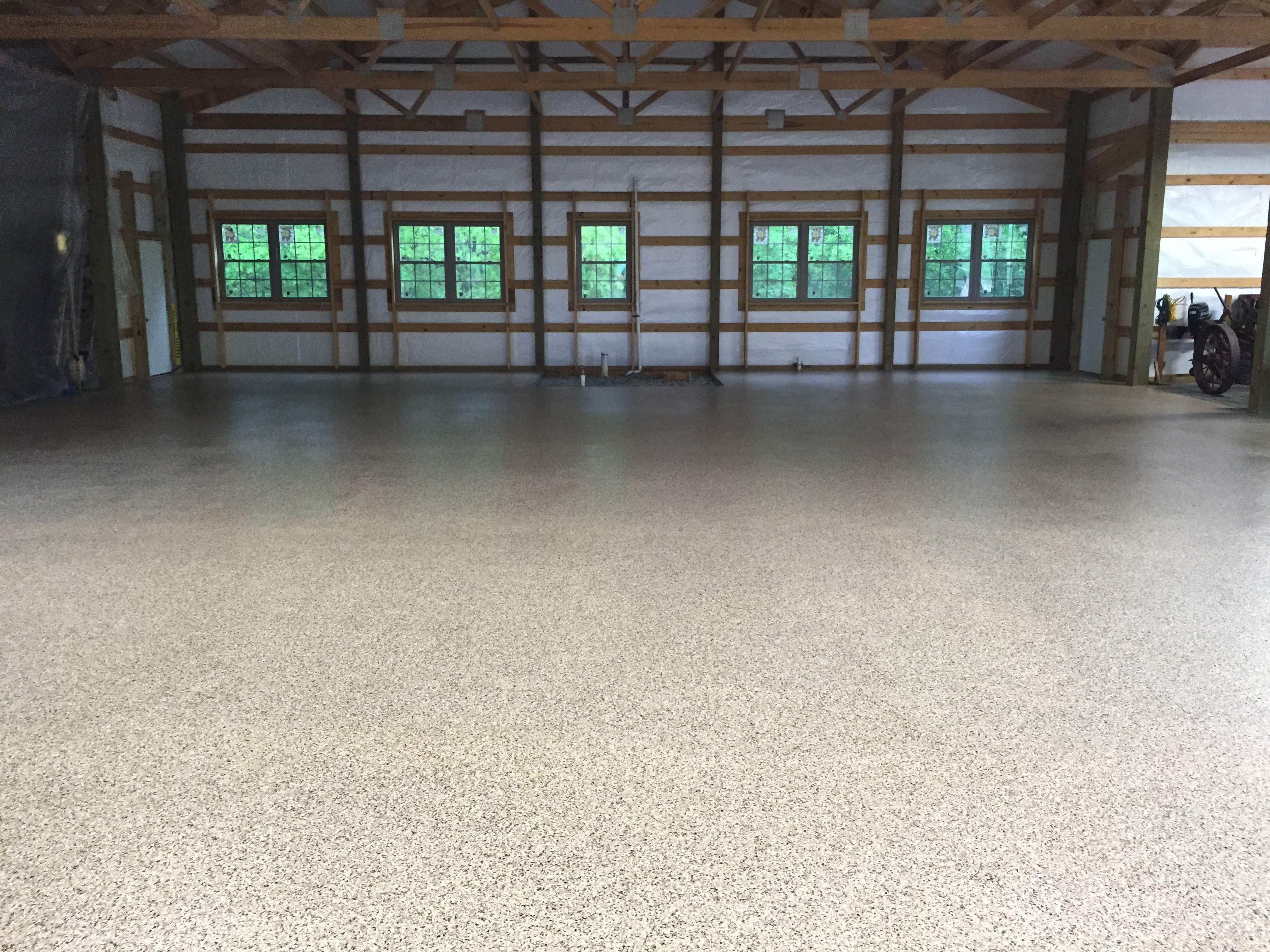

I decided to hire it out after getting some advice from the garage forum. Attaching finished product. I was very pleased with the outcome. Epoxy1.jpg
   / Epoxy Coating for Concrete #15
Looks nice. I hired out our first garage. Then did some smaller spaces, then did the shop myself. That is a large space to do yourself the first time. It is a lot like concrete, when you mess up it is not good. And I have made mistakes. Thanks for updating.
