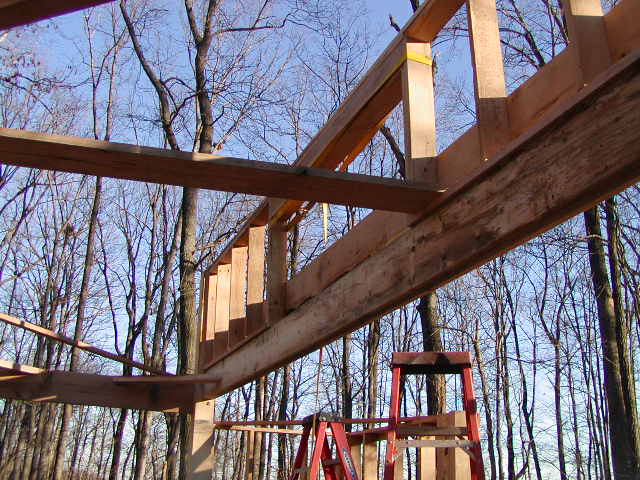

Some detail on the upper portion of the barn. This is where the louvers will be and where I plan to air dry wood.

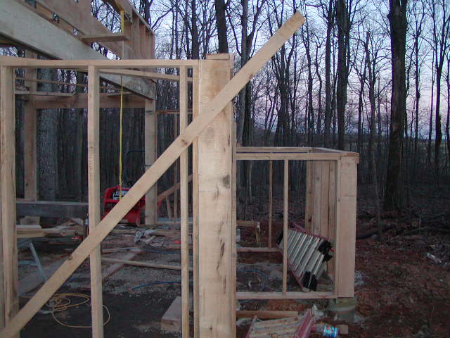

On each side of the barn, there will be a 4'X8' bump where I will be able to sit implements for the tractor like a rear blade, box blade, etc. that will get them off the main floor. The backhoe should sit in one of these as well.

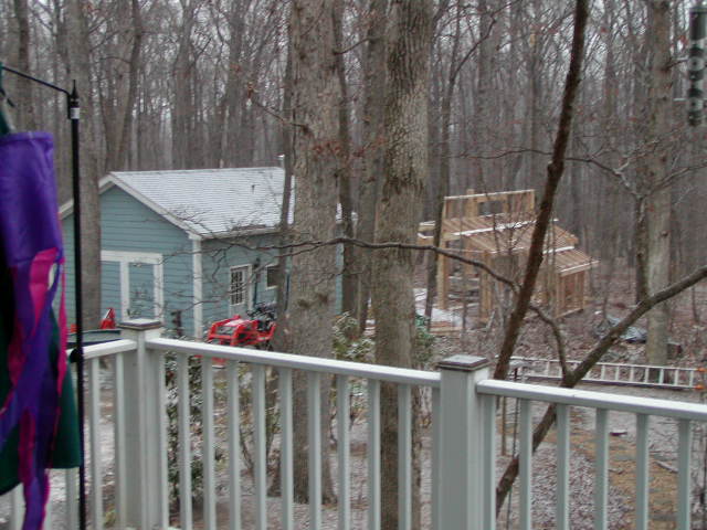

Here's a shot from the deck showing the barn structure about halfs completed. Have to built out the left side to match, then the upper structure, and then will be able to move to roofing/siding.
May lose a couple of days, calling for 6-10" of snow here today through tomorrow morning so Monday might be a bit of a challenge to get any progress.

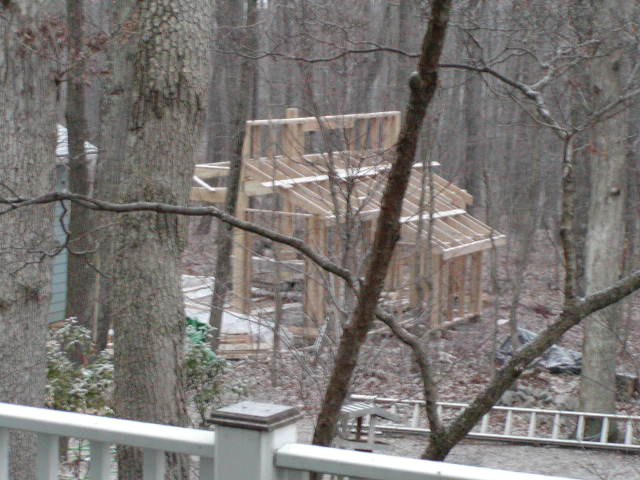

A wider perspective to show where the barn sits in relation to the shop.

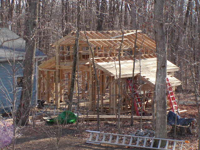

Still moving along slowly- framing is all up and starting the decking for the roof. Probably will have to mill a couple of more logs to have enough to finish the decking, plan is to do that this week. One new picture attached.
