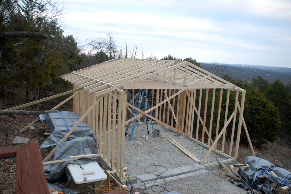

The summer of 2020, my youngest son and I put up a 12x40 loafing shed with a 2' overhang. It was our first scratch-built building and I was happy with how it turned out. It needs to last me about another 15 years and by then, I probably won't be using much of what is stored in it. I'm confident it will go longer than that. It's already too small....no one told me my nephew was going to park his 4 wheeler in it.

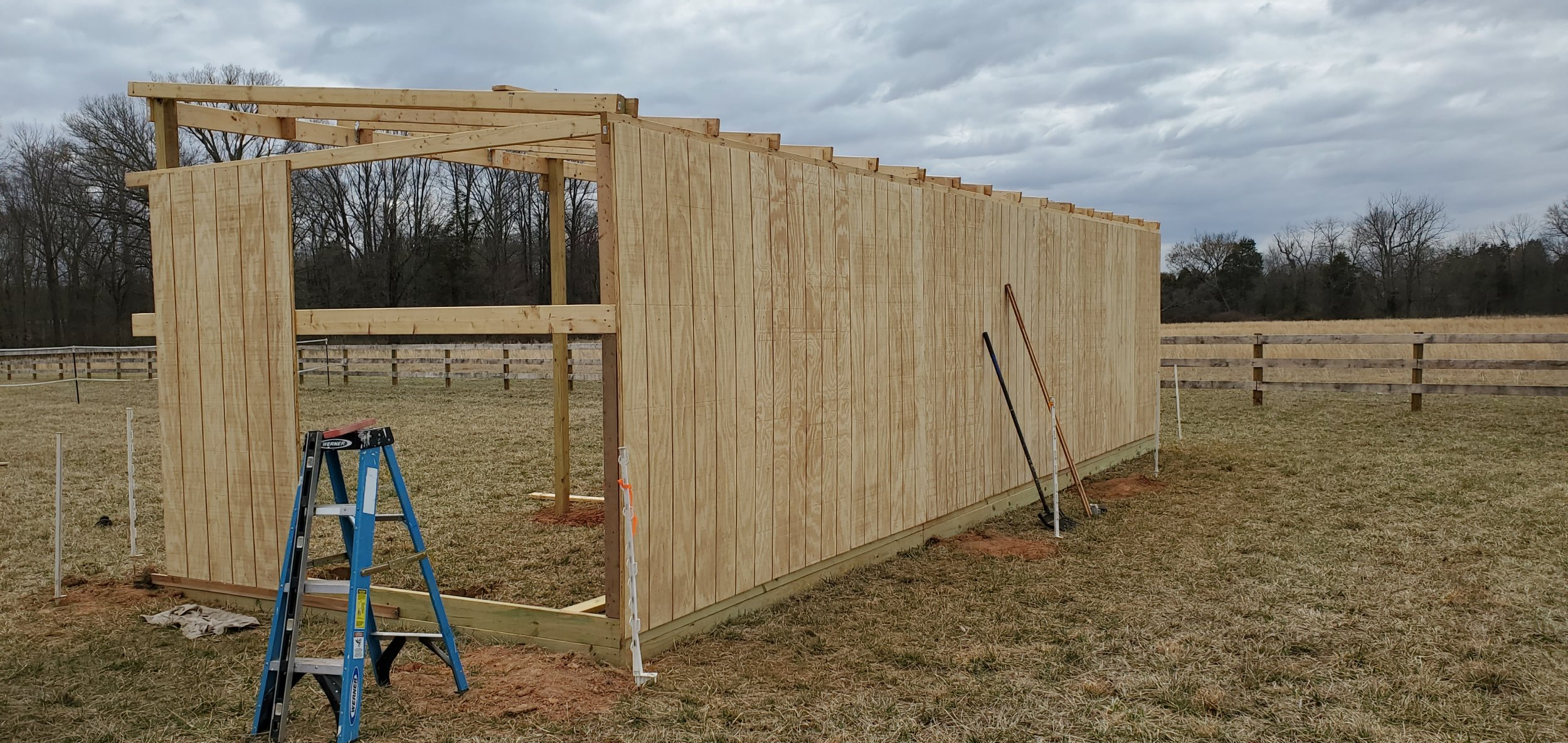

Over the years I have gotten really good at building quick/cost effective and durable sheds and run ins.
My latest was a 12X36 run in, in a back pasture.
I used the standard lumber dimensions and if I am successful, don't cut anything, anywhere. That included metal roofing. I start with a 12X12 frame and just keep adding on. I don't go by plans, and the size is determined by the SO. I am just the day labor guy. I use screws for everything.
This is the fourth run in on the property. Even with the "lumber" price gouging, this particular shed probably saved me a couple of grand.
I only bled once on this shed, so it was a good build.

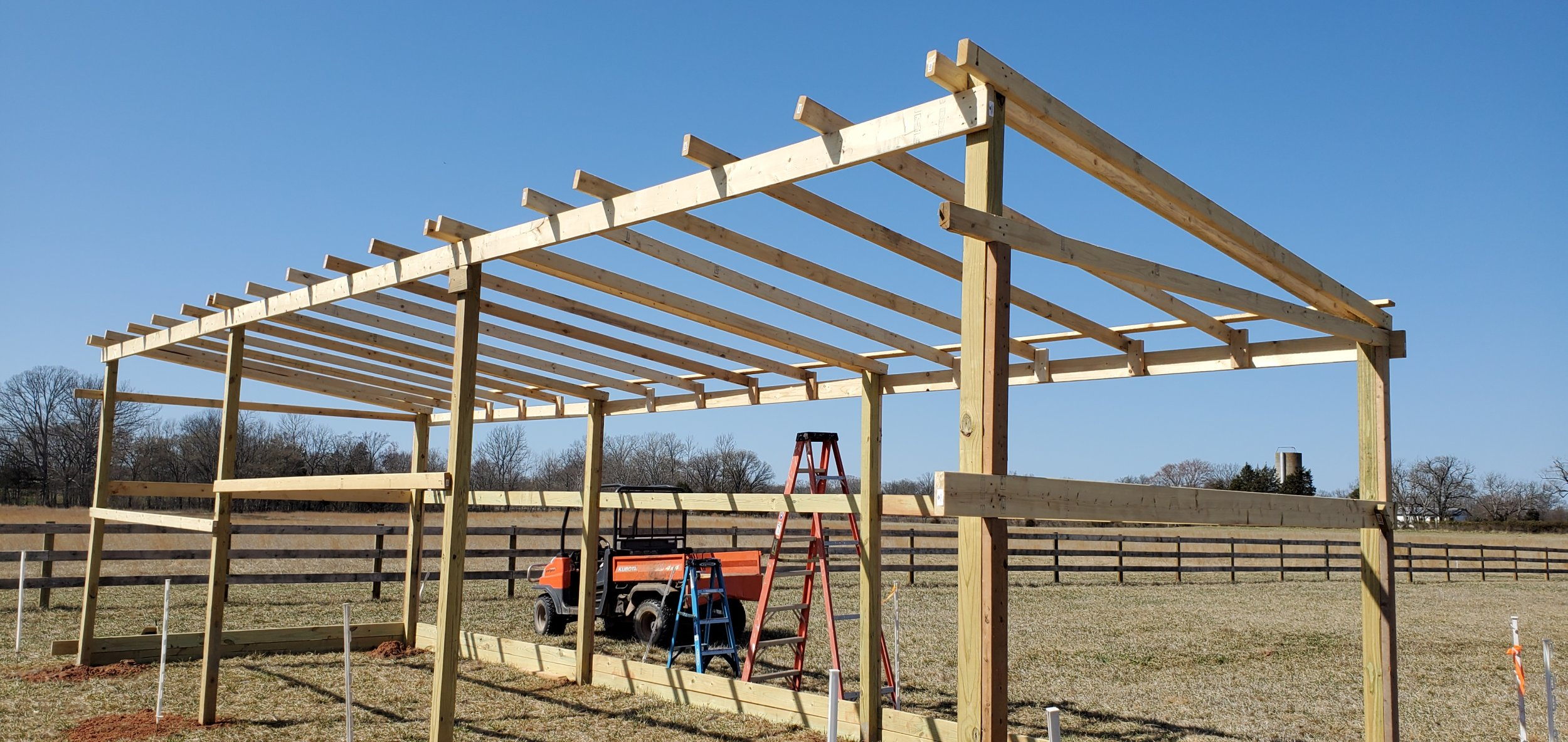

@riptides I would love to see more photos of the shed farther along/completed. I'm curious how you keep the horses off the metal sheets, and the length of your pressure treated posts for scale.
All the best,
Peter

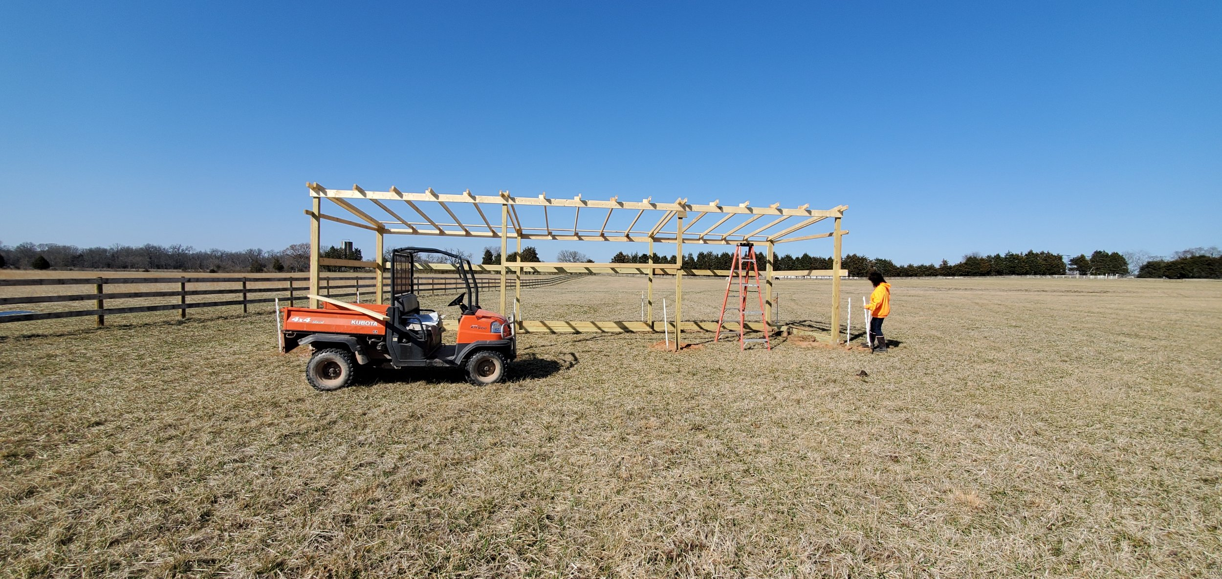

   / Equipment shed - I remembered I don't know how to build one... #18

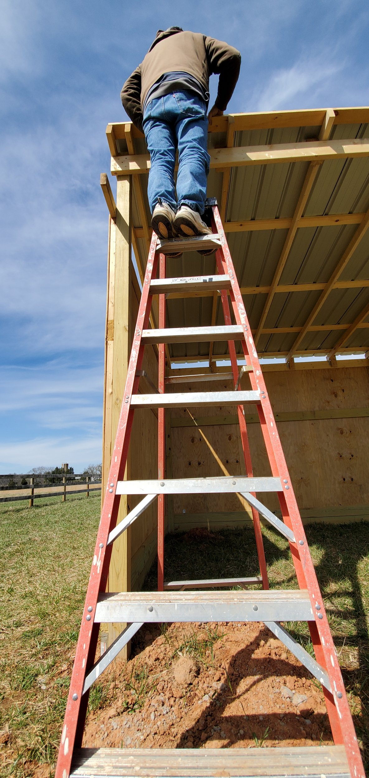

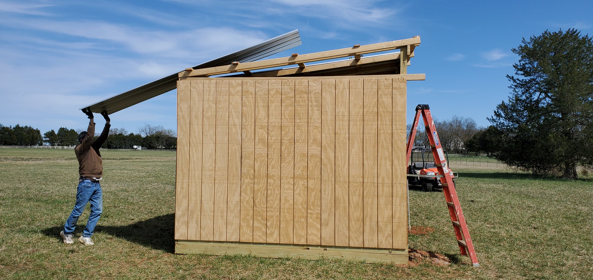

See attached. Our horses are pretty docile. No kick boards in this one. If needed, they can span the inside since the posts are 12 foot on center.
Wife says should be at least 12 foot high in the front and 10 - 11 high in the back. I am six two and really don't like ladders, so this is as high as I go. Was a one person job, since it is out in the middle of no where, volunteers are scarce. LOL.
All the best,
Peter
