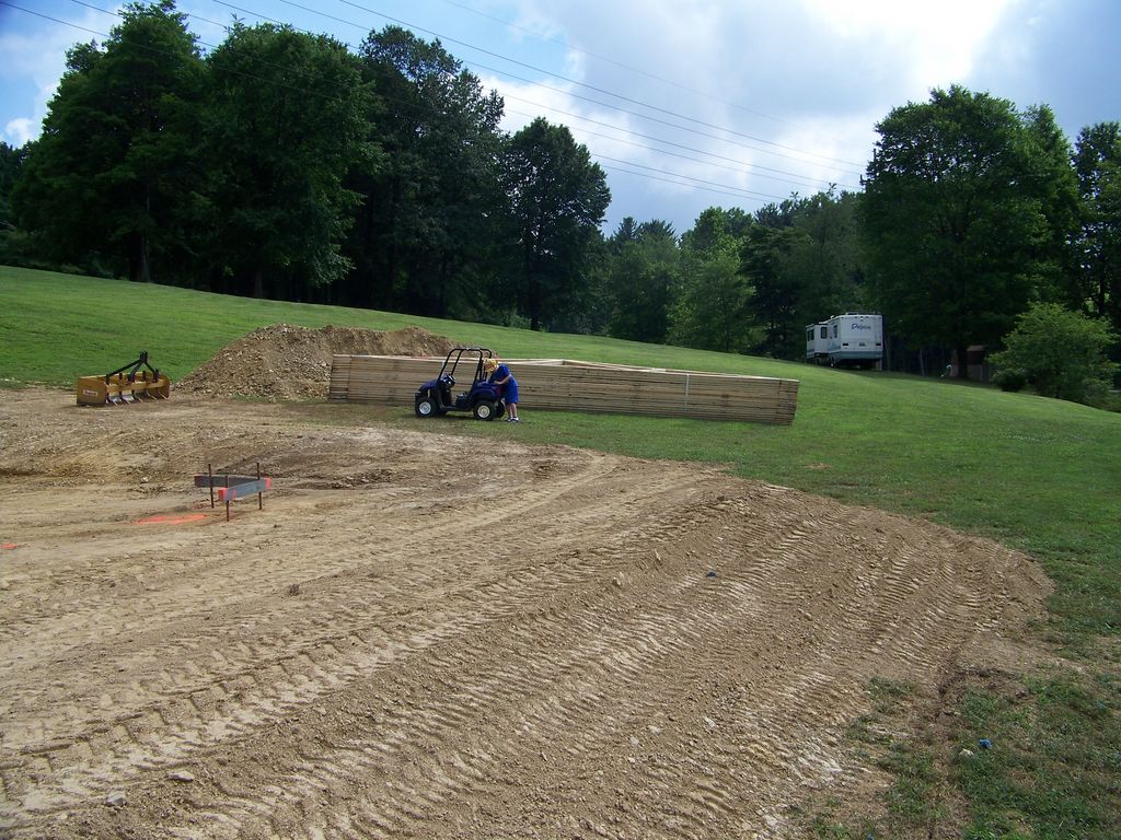

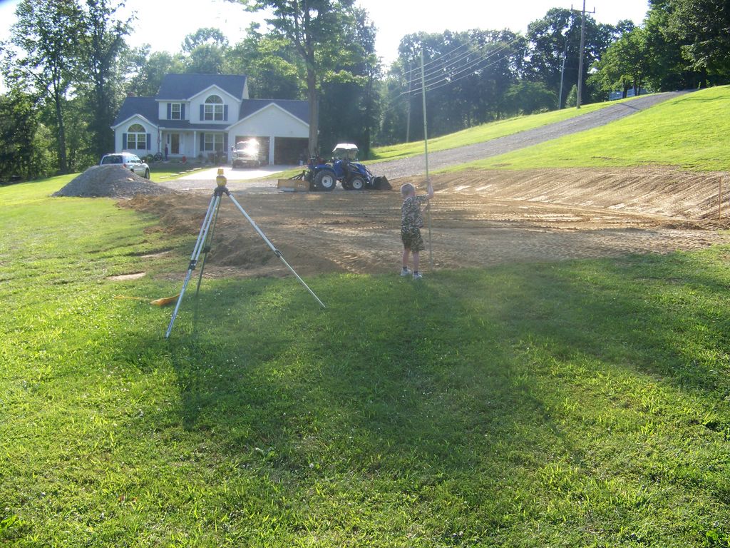

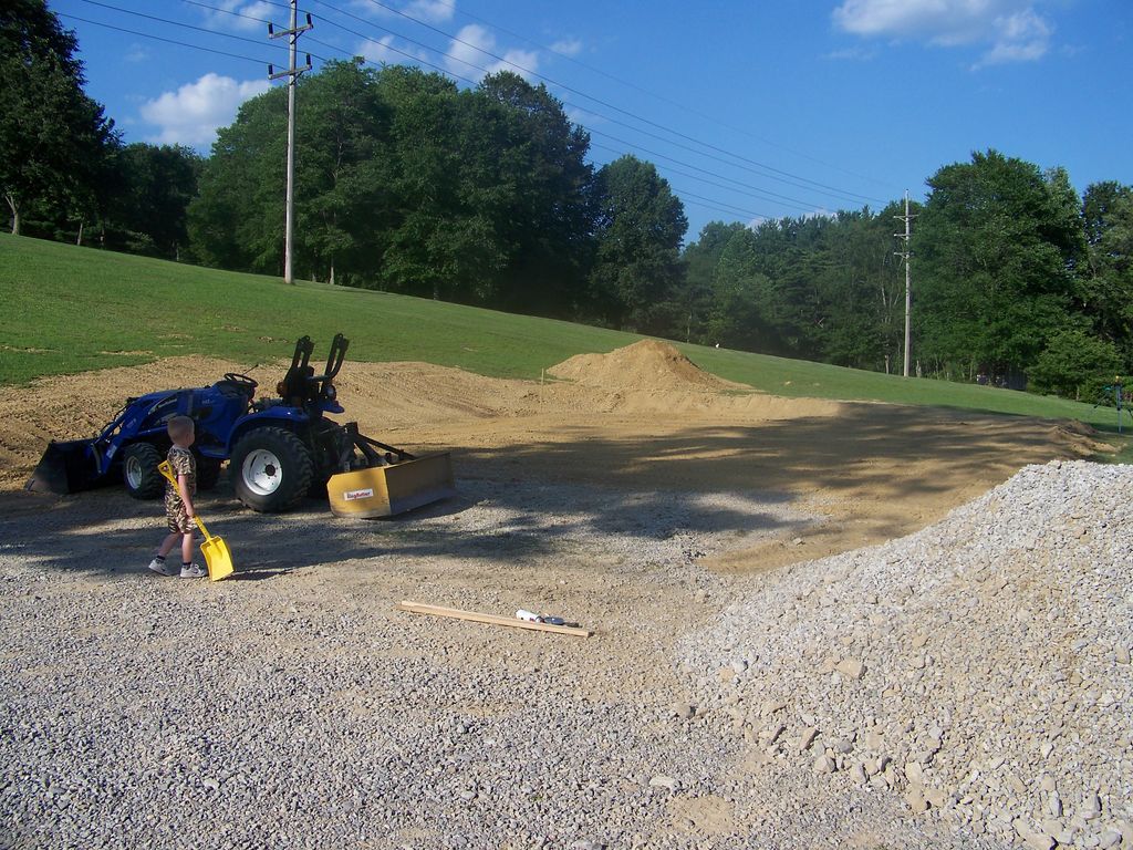

When I built my pole garage I needed to build a pad. I used a laser transit and my tractor with a box blade. I have a hydraulic top and side link so that helped a bunch. When do you stop? Who knows, whenever you are satisfied I guess!
If this helps, here is what I was able to do with my 24hp tractor and box blade. The first pic is what I started with.

Since some of the gravel will sink inot the mud, I'd make sure I put in 8 to 10 inches. If that is going to be more than 1 load, and I'll be it will be, start with big stuff and graduate to smaller on top.
