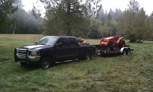

I have the CK30 which I believe is the same tractor as your bobcat. I use a 16+2, car hauler (low boy), with slide in ramps, 6" channel frame, 10k rated, PJ brand trailer. It is perfect and has been a great trailer. The empty trailer weighs 2500# with 250# on the ball for a nice distribution.
The CK30 with an implement on the rear, loader on front, and non-filled tires is right at about 4500#.
When loaded to mow with the FEL on of course, the rear trailer axles on one scale pad weigh 6600 plus at least 700 on the tongue.
Here's a picture.
If I could do anything differently it would be to get a longer deck. The mower hangs off the back.
