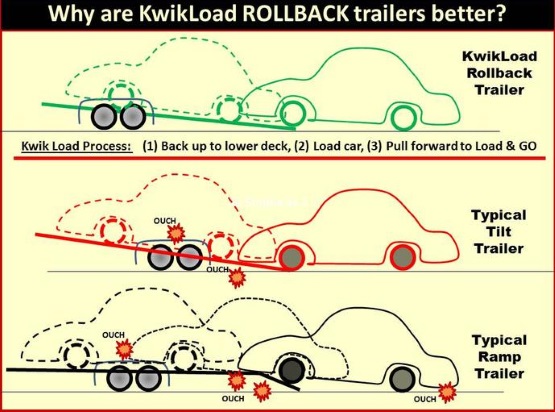

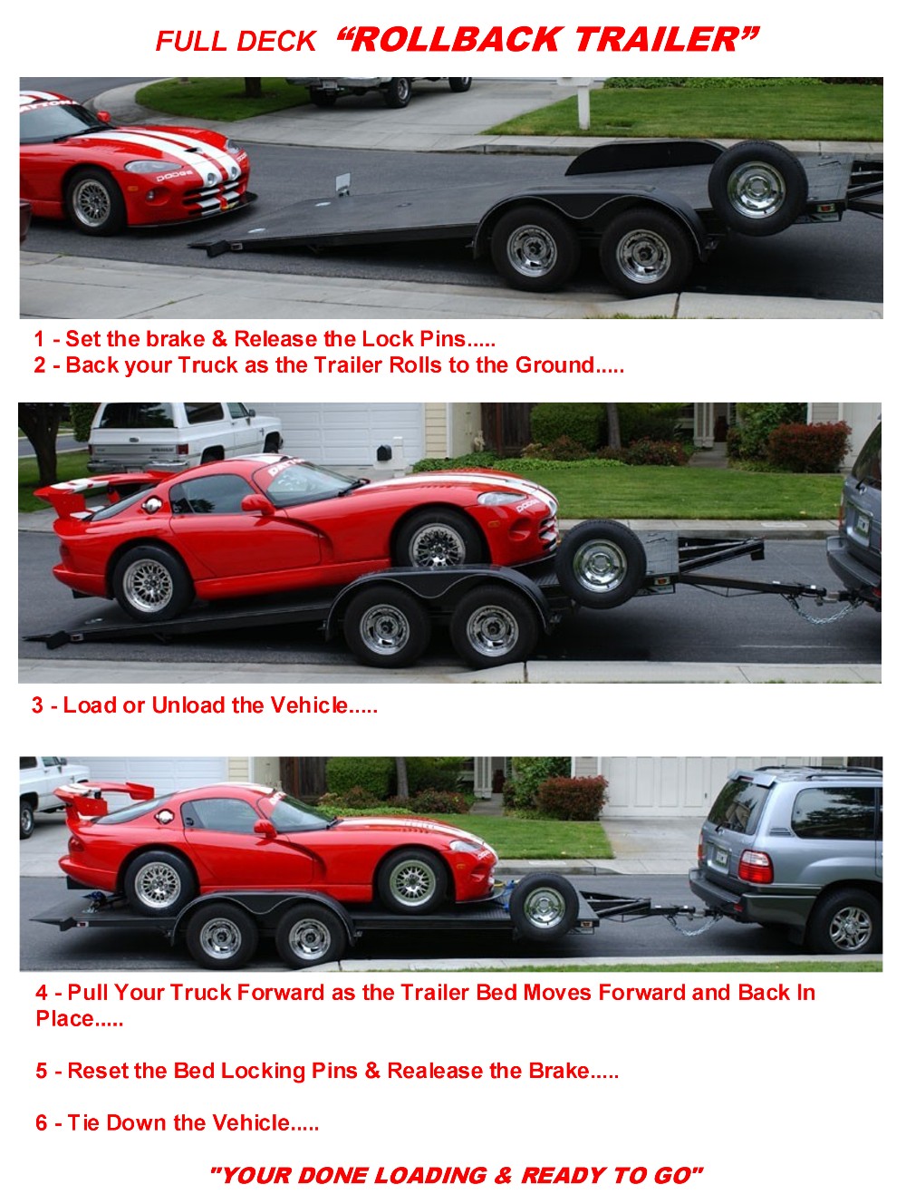

They are called Rollback Trailers and you don't need a semi, a pickup will do just fine: Rollback Trailers, Tilt Trailers & Heavy Car Haulers in Texas | Kwik Load Trailers
The trailer axles are back farther than a same length tilt trailer.
BINGO! This guy has it down. My buddy has one of these trailers and they are the cats meow. Phenomenal! Its way better than any other tilt trailer. Lower angles as well, for those sports cars...I'm ordering one of these in a 20 footer in the summer.
