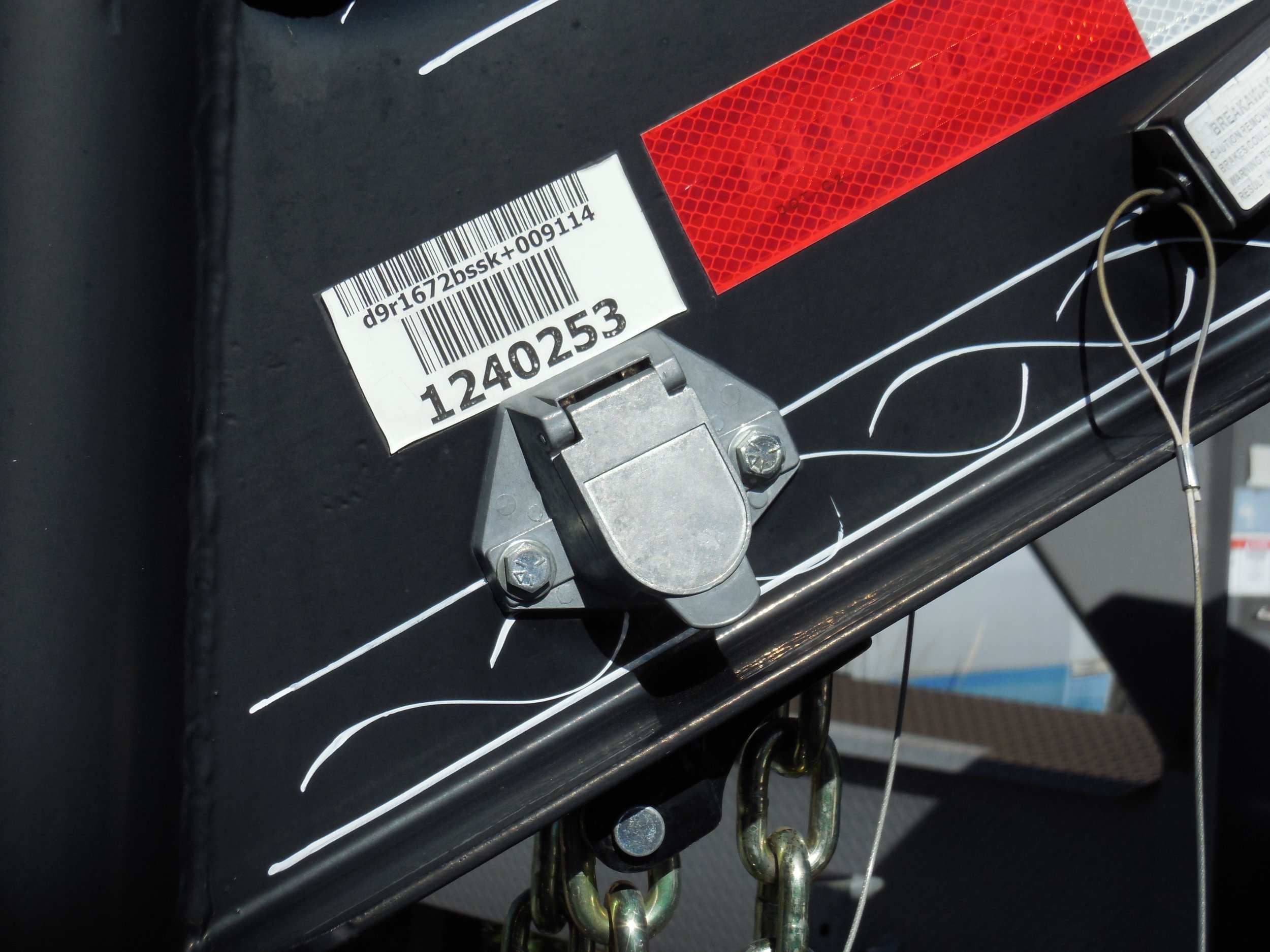

I'm Also wondering why they have the clearance/side markers and the tail/running lights tied together by that jumper wire.
That's because in commercial applications (Class 8 tractors and trailers) the taillights and marker lights are on separate circuits. I'm guessing so that there will be some lighting left if one of them craps out.
Anyway, my larger dump trailer rarely leaves the property, so on that one I removed the cord and installed a Class 8 connector. Now there's no dangling cord.
Wired up a standard Class 8 cord with an RV connector in one end for when needing lights and brakes. Now the colors were helpful. Not because of what they represented, but to keep track of which wire was what.
I really do like the Class 8 stuff as it's affordable and made to last. One of these years I'll convert the other trailers, too. Should I ever have to leave a trailer on the side of the road, chances are good that a potential thief would give up when there's no way for him to connect the trailer electrically.
