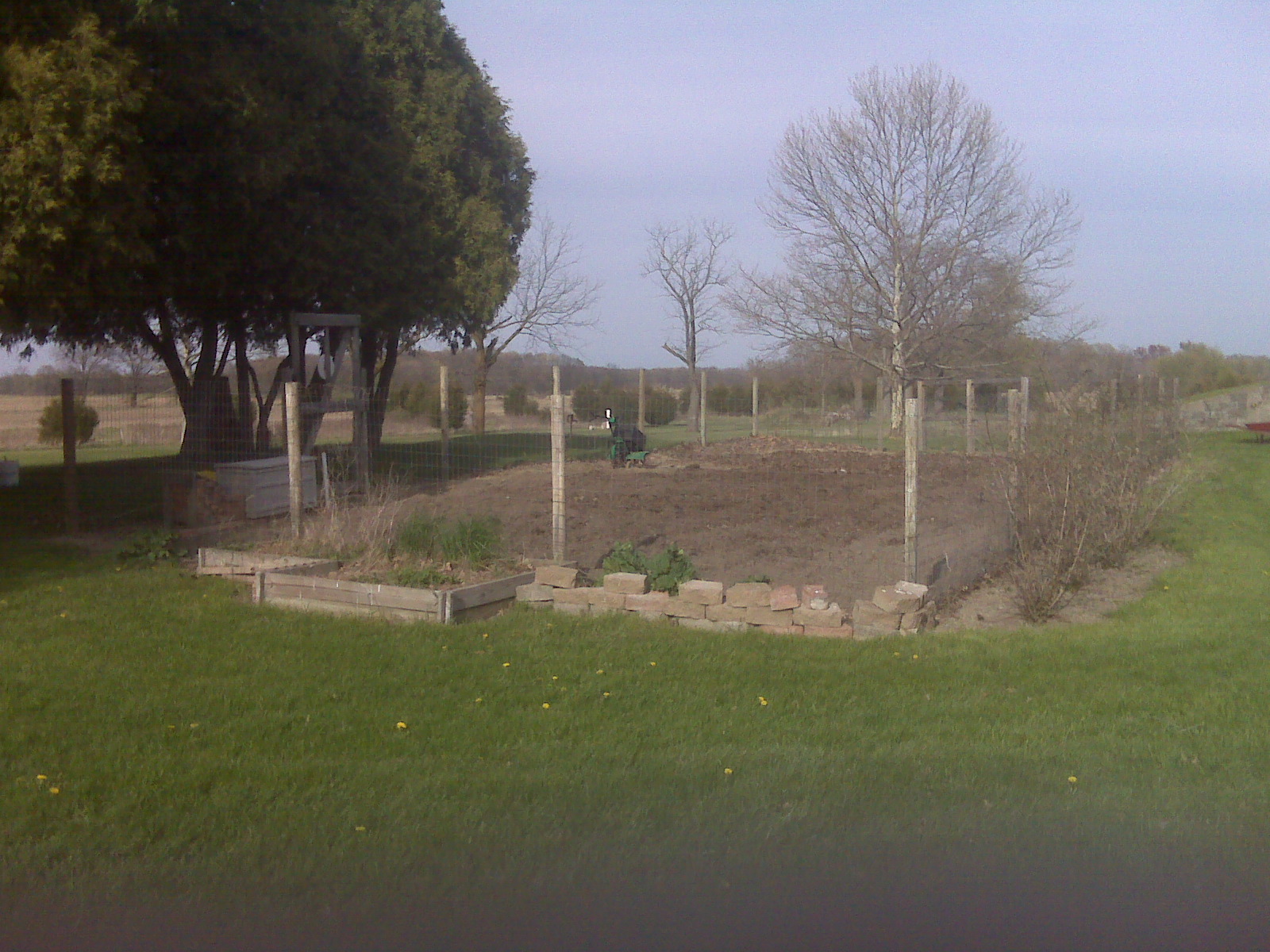

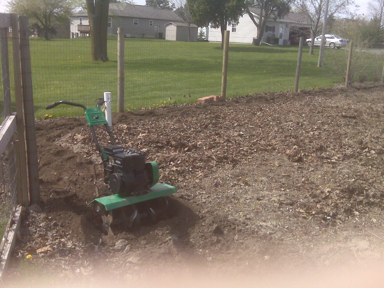

I currently have a 28X60 garden plot, It uses (for the fence) treated 3X5 landscape timbers that are 8 feet long and are buried 3 feet deep, set in a bag of redi mix for each post. The 5 foot high fence is simply 2X4 mesh with a second 2 foot high rabbit mesh at the bottom. We have deer everyplace but they never seem to care about what I have planted in the garden. Sometimes I wish I had used T-posts instead of landscape timbers as I could have just driven them into the ground vs. digging a posthole.
