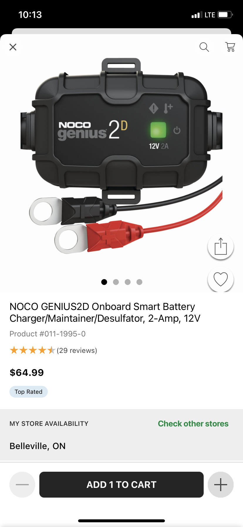

I have a NOCO 2Amp smart battery maintainer on my 2014 CK30HST tractor and it’s plugged in 24/7 when parked inside the shed. My tractor can sit for several weeks sometimes, but there’s 535 hours on it. The oem battery is 8 years old…and cranks like new, hopefully I didn’t just jinx myself 🤞
/ ERROR CODE 010H #34
View attachment 761269I have a NOCO 2Amp smart battery maintainer on my 2014 CK30HST tractor and it’s plugged in 24/7 when parked inside the shed. My tractor can sit for several weeks sometimes, but there’s 535 hours on it. The oem battery is 8 years old…and cranks like new, hopefully I didn’t

Great idea but you just jinxed yourself.
