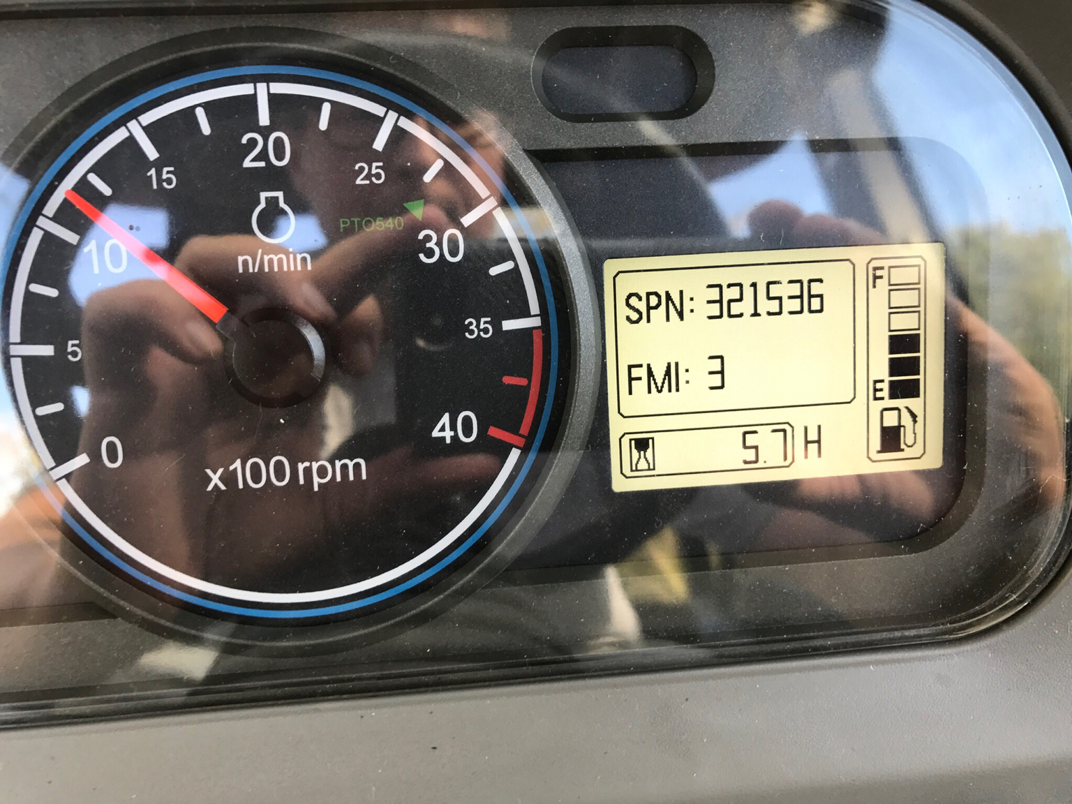

I started my tractor and saw the following codes show up on the dash:
SPN: 321536
FMI: 3

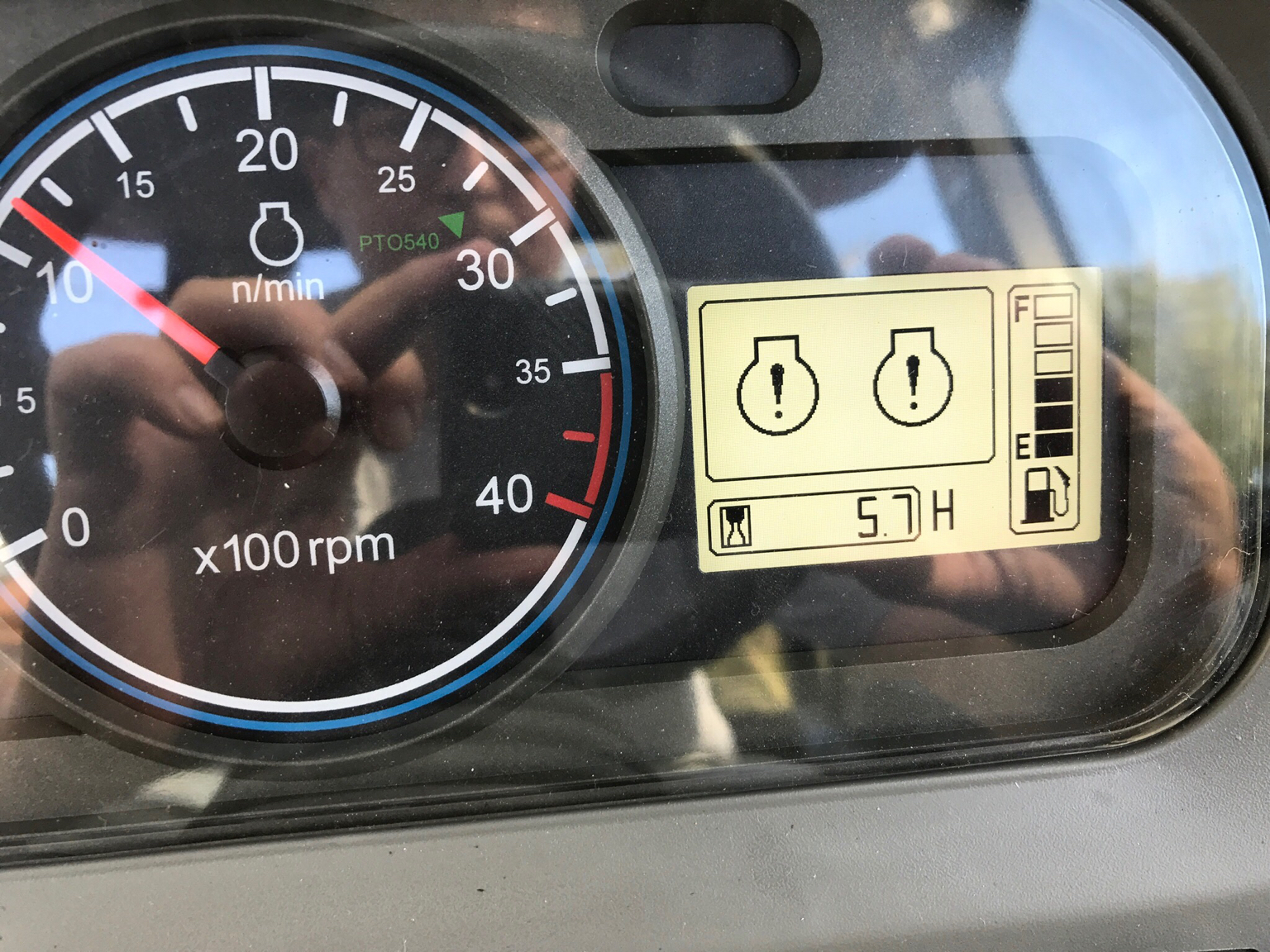

This flashed alternately with two warning symbols:
I can't find anything in the user manual and my dealer is also stumped. Does anyone know what these mean?

After several go arounds with the dealer and TYM, the techs at TYM said that the code on the dash can be corrected by cutting a wire that is not needed for the new dash panel (which I have). The wire is part of the engine harness. I have not done this yet. Once I do, I'll report the outcome.

Before cutting the wire, I started having another problem where the RPM won't go above 2000. I cut the wire and the error code went away. I'm still getting the two warning (!) symbols, though, and the RPM issue still remains.
I asked the dealer about the RPMs. After talking to TYM, he asked me to check several fuse connectors in the engine bay. He thinks that one of them may have come loose while brush hogging in the woods. I'll do that tomorrow.

Update: After checking the fuses, everything seems fine, at least to me. The dealer now has the tractor in his shop.

The dealer still has my tractor. After going back and forth with TYM, TYM is sending them a diagnostic computer to figure out what's wrong. They've been waiting on the computer for two weeks.

Resolved! My dealer had to get a diagnostic computer from TYM to determine the problem. After waiting a few weeks for the computer, it told them that the error code was due to a fuel pressure sensor problem. Part ordered. Another few weeks pass. After sensor was replaced, same problem. Yanmar called in. The sensor was the problem, but something had to be reset to enable the tractor to achieve the desired RPMs and eliminate the error code on the dash. Now, my tractor purrs like a kitten. I'm happy now, after two months of my tractor sitting in the shop.

I know this is an very old post but I have into this problem with my 454 HST. It has my dealer stumped.
Left engine warning light (right side cluster as shown in your image) comes on initially with key turn.
It then shuts off (normal action) once the tractor is running.
Both engine warning lights then come on, the left one flashing. They stay on and don't shut off.
Tractor seems to be running just fine. No other code shows up on the cluster. Code reader is not identifying the problem. Fluid levels are fine.
Is that similar to the issue you were having?

The left engine light indicates low oil pressure. The right is the check engine light. Low oil pressure would trigger a check engine warning. And both would illuminate.
Try changing the engine oil. If that doesn’t work try pulling the sensor of the idiot light and hooking in a guage, to see what the pressure actually is.
Sometimes the sensors go bad, and send incorrect signals to the engine management system.
