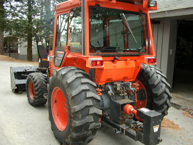

Hey Matt - I looked at your band saw mods and the snake pit on Bambi - wow, now there's some fluid power choices! What tools do you plan to drive with the new SCV's? When I added new 2-spool valves I used three 1/2" lines with daisy-chained PB's and tee'd returns so there's full flow to any valve, or independent sharing without disabling the PB to the 3ph. But it's a lot of plumbing! Happy Holidays - DickB
Thanks. When we bought 35-acres at the end of 2007 just before the economy took a major nuclear dump; the thought was to upgrade the tractor in case I needed the outlets for something or another while building the new house. Now the outlets are just there with one running a top-link. I also wanted to get the kits while I still could.

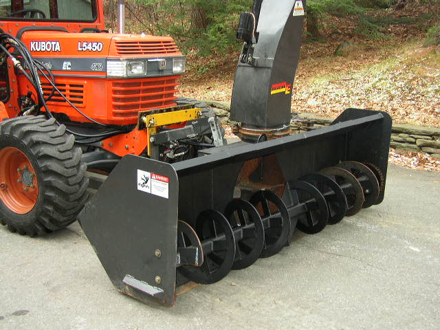

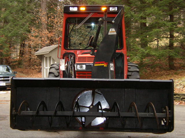

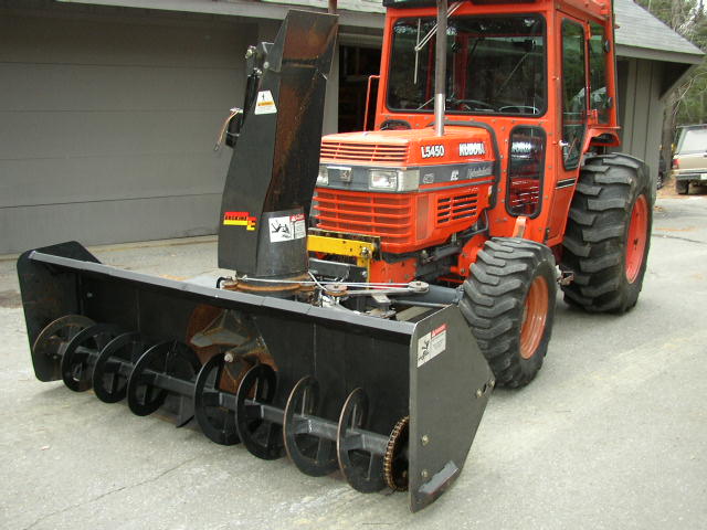

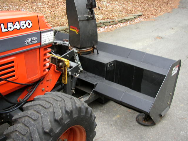

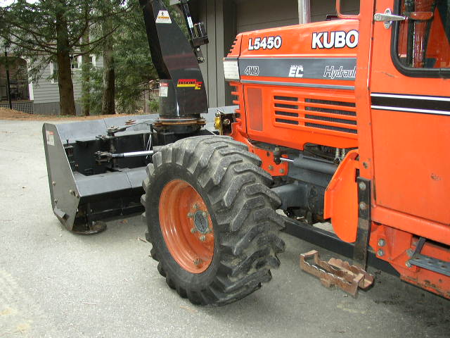

Well it did itself proud, passed the test with flying colors - we got less snow than some nearby towns at higher elevation, but 6"-7" is enough to check out blower function. The wider blower head is much better. You wouldn't think a few inches on each side would be that big a deal but it is - I'm no longer driving over un-blown snow with my rear tires, and it's easier to do around mailboxes, parked cars, and near buildings.
It's cool to have a one-of-a-kind attachment too. The blower looks like hundreds of other seven foot machines - except that the chute is on the right and the fan turns ccw.

Hey Tom - Thanks for the thumbsup. I've been clearing out some drifts and moved one pile the town's plow left. It was good to see the new longer auger is reasonably matched to the fan - it doesn't over-feed it or leave a center pile.

We finally got some real snow in western MA ! I don't have any action pics but the wider blower works like a champ in 12+ inches of snow. The chute deflector now has an up/down switch on the valve handle - very handy item. A cup holder for my hot cider & scotch is next !

Hi Willl - the answer was in post #12 above - the new flights are made from flat rings cut by a cnc plasma torch unit - I bought them from a local steel shop and bent them into right and left spirals. The spokes are 1/4" x 2" x 3-5/8" flat stock. Hope this answers the question - take care, Dick B
