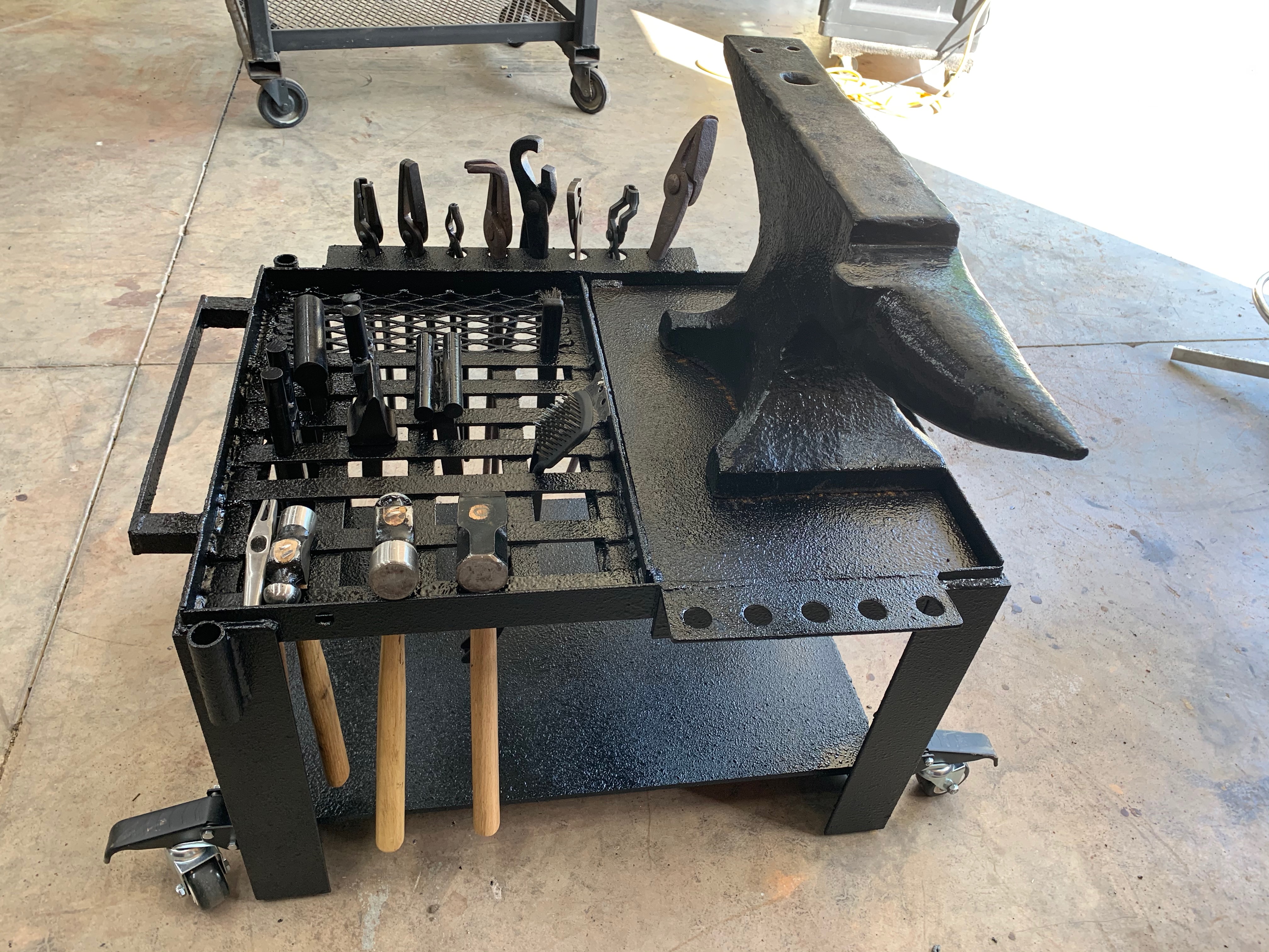

For those who asked.....
Here is the first project - my anvil and tool stand (with lift up wheels for easy moving in the shop). It is heavy, ス" steel plate under the anvil, bottom shelf is 3/16th, and 3/16th angle for legs so it should hold up!
Next project is a stand for my small gas forge.

Nice... and you even have room for a BBQ brush! :D

One word of advice...put that anvil on wood. They shouldn't be mounted on steel, especially for use.

Nice!

Vibration damping and it will feel a whole lot better.
Thanks guys! I was sort of wondering about that - I was thinking about putting a piece of horse stall Matt under it - would that work ok?
Like that BBQ brush huh - LOL. I had it laying around and thought it would work for the time being for a quick clean off of the anvil.

If you plan on using it for actual forging, wood smoke will smell much better when you drop hot steel on to it than melting/burning stall mat will.
