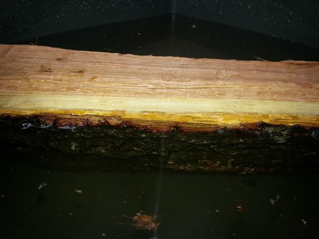

If the log was just cut it could have weighed about 3075 pounds as I figure it.
