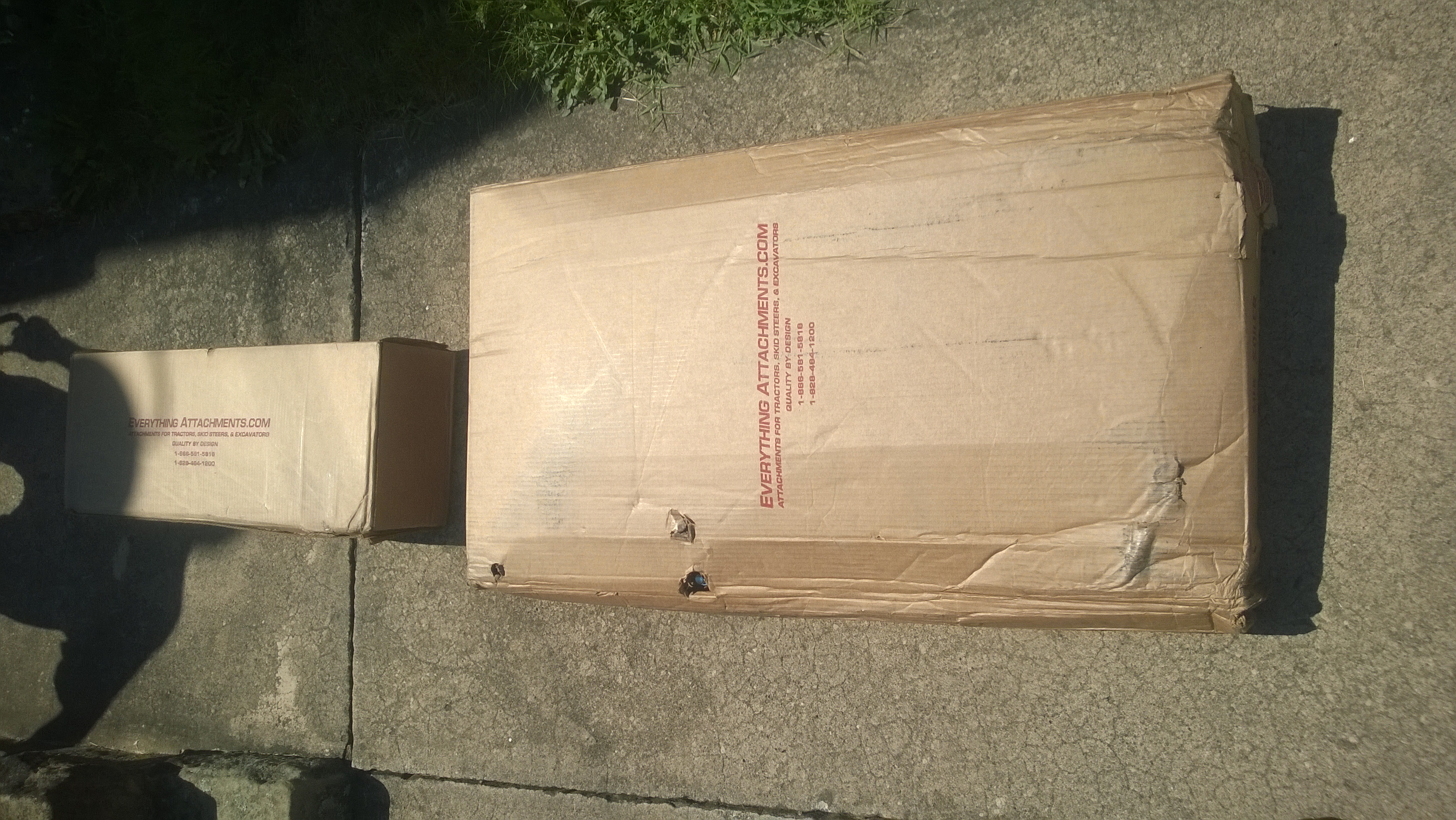

Well, it arrived fine. FedEx apparently banged the boxes around a good bit and the box the blade was in had a couple small holes and the foam filler was partly in pieces, paint got a little chipped on a few things, but no worries; it is nothing any worse than I have intentions on doing to it during normal operations. Here was how it arrived:

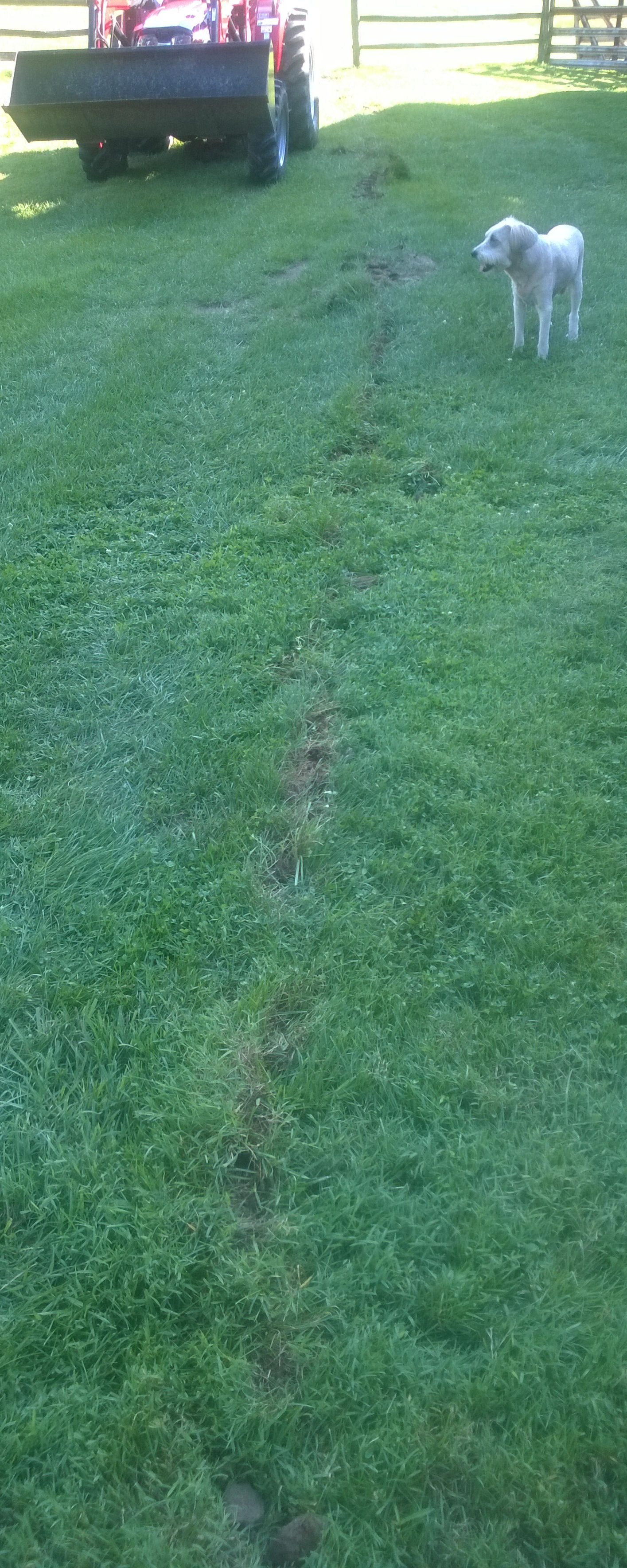

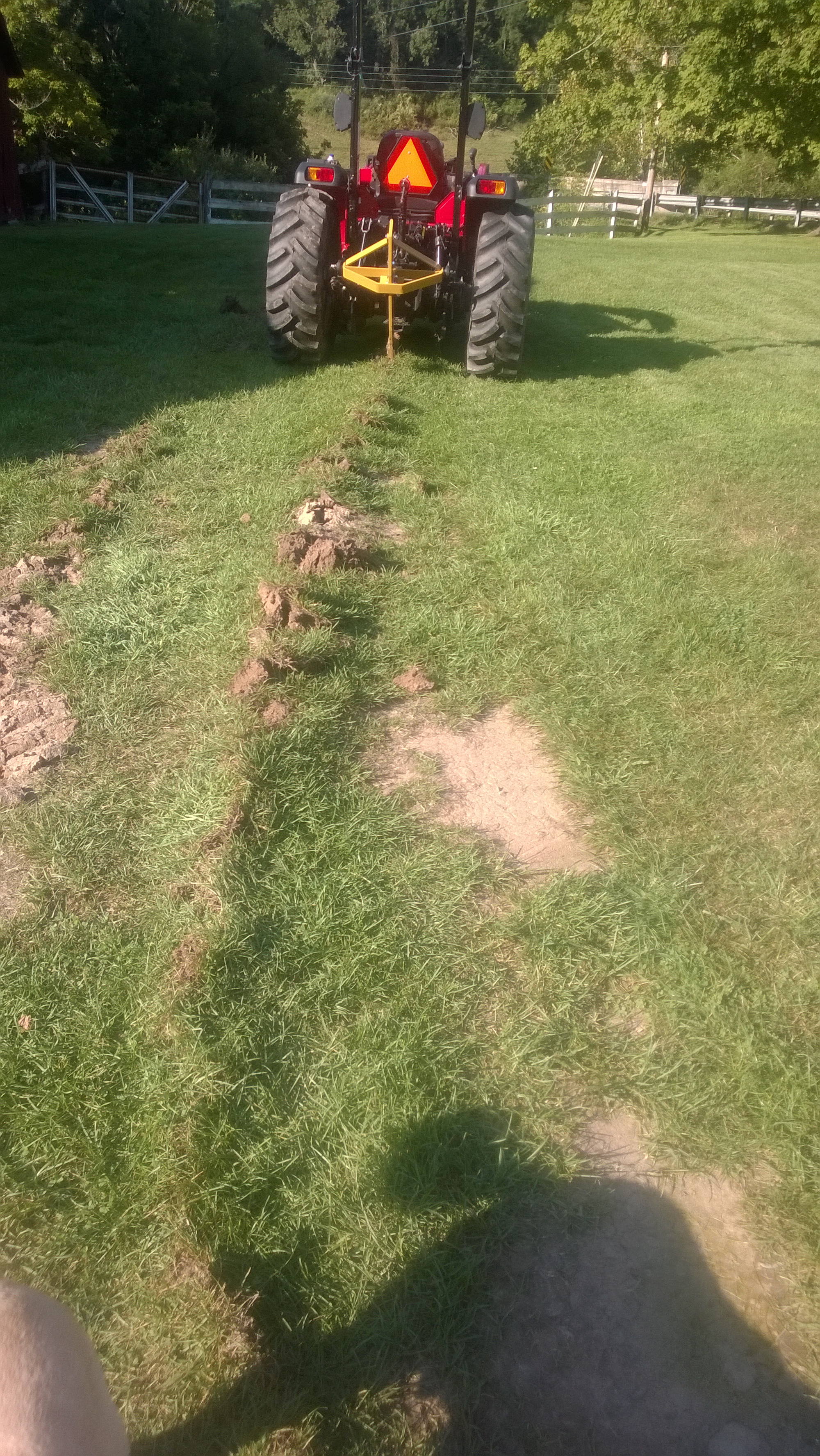

After assembly (which was a breeze), I thought I'd give it a whirl before putting it in the barn. One of the places we drive by the barn has quite a bit of compaction and water stands when it rains, so I thought I'd test it on that. Knowing that it will probably be the hardest part of my land I figured it would be a good test.
Made one slow 60' pass just beside where the tires of our vehicles compact, awesome.
Started to make another pass a few feet from it and made it about 30' and bang went the sheer bolt. Knew I needed the sheer due to the rocky soil here, thank goodness for it or the whole thing would have been a pretzel. I was in low range at 1500RPM and hardly moving, so pretzel may be an exaggeration, but needless to say I'm tickled to have spent the extra on one with a sheer bolt design. Here is how far I made it on the second pass:

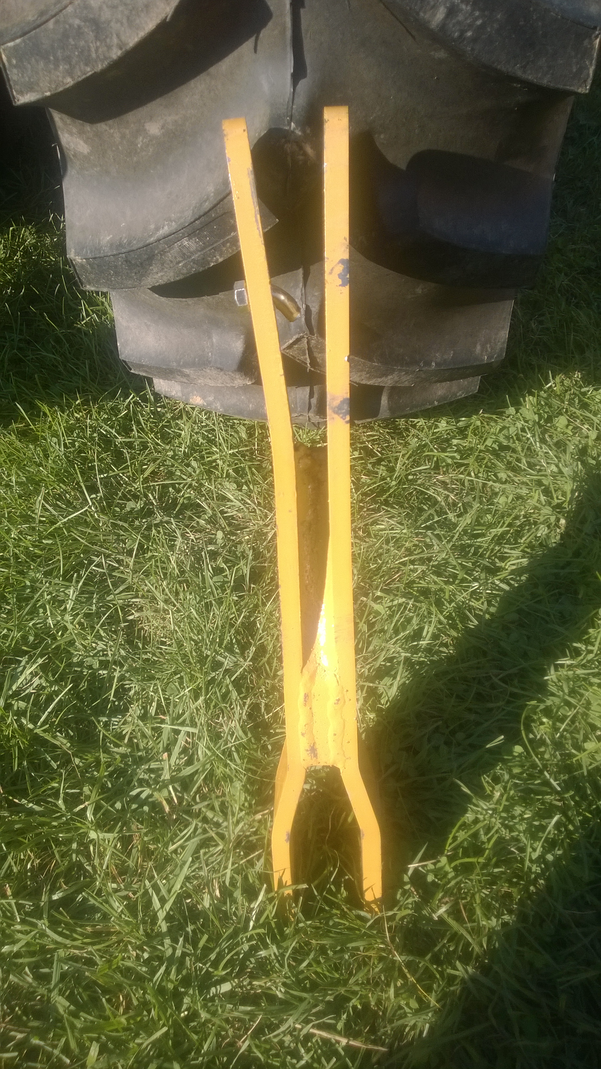

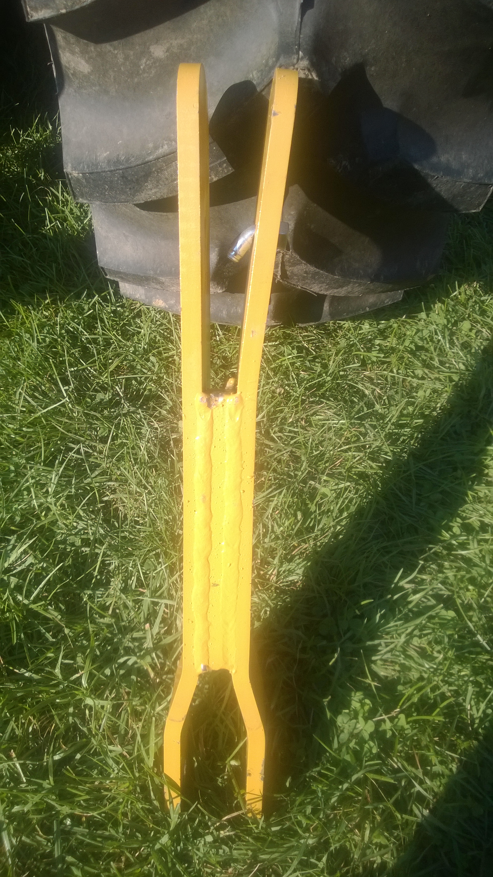

I fully expected if it was going to sheer, this part of the land would be the place it would sheer, so no big deal. The only concern I have is when the sheer bolt sheered, half popped off, the other half bent and acted as a wedge that bent the bracket slightly.

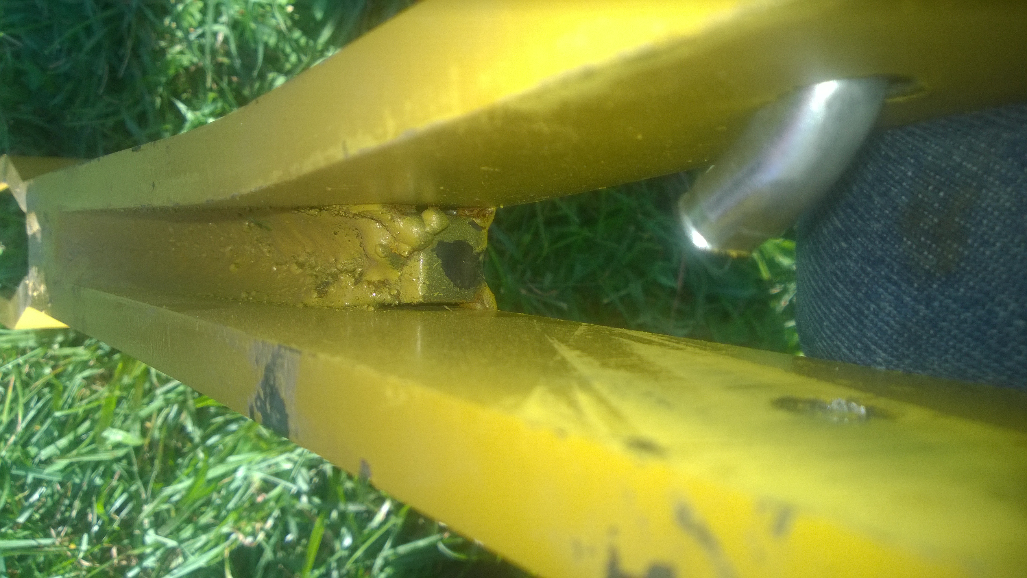

Upon inspection, I can see there are masses of fill weld between the plates that make up the bracket, and none at the tip of the square rod spacing the two plates apart. I'm thinking if I straighten the bend and put a little more weld at the tip of the square rode spacing the two plates, it may provide a bit of extra support (since the bend occurred at this exact spot).

the welds in the last pic don't look real good. I would grind part of it out and then weld all the way around

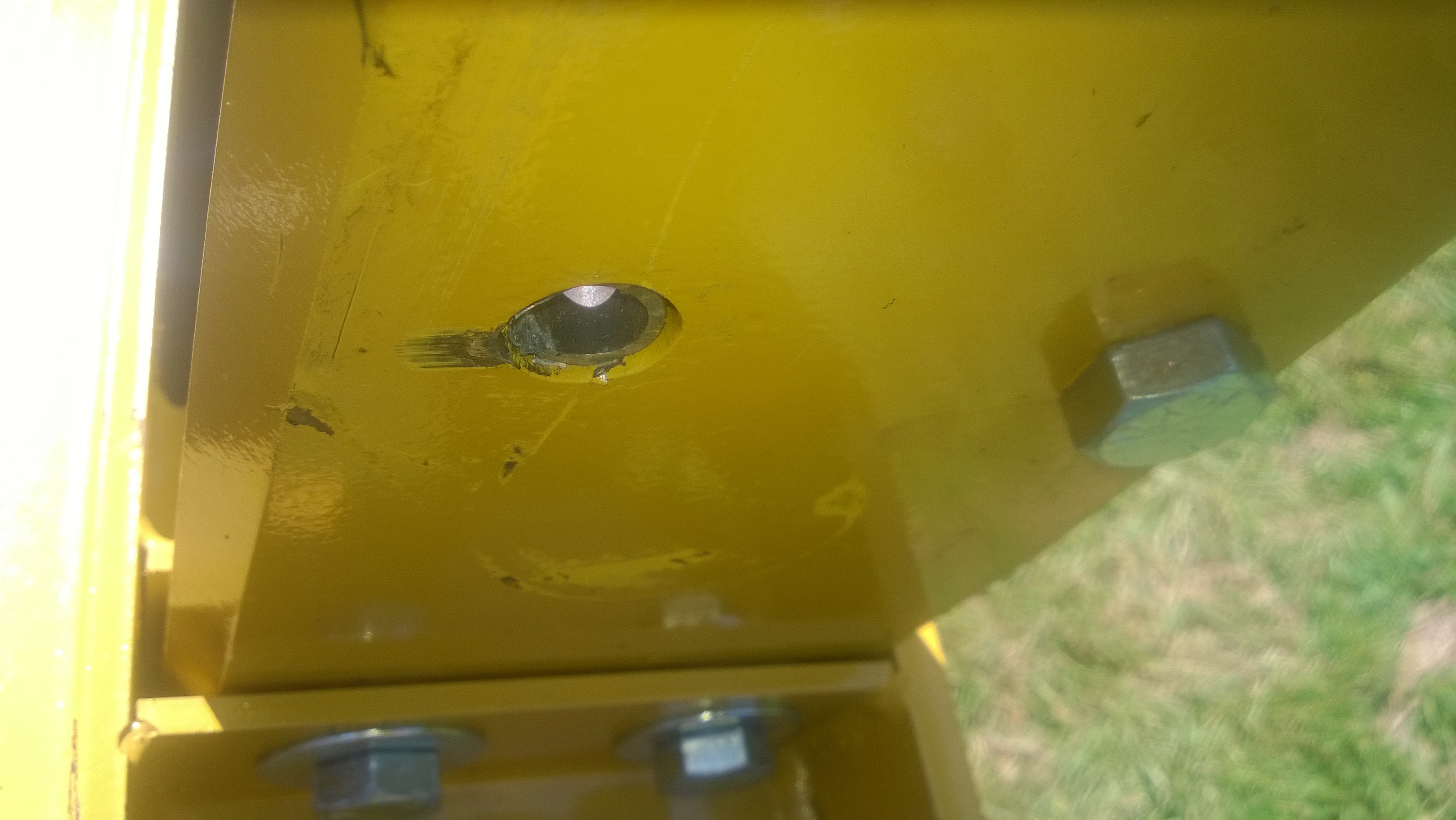

Woke up to a PM today from Travis concerned about the issue I experienced. He asked for some additional pictures, asked if the bushing around the sheer bolt was in place properly, few other things. Was concern perhaps I had the top bracket upside down, I don't think it was as I understand by the geometry of it, the slot formed in the one side of the bracket is made to allow full motion of the main upright blade plate. Not saying I didn't have a brain fart, but I don't think I put it on upside down...
When he had asked if the bushing was in place, he'd mentioned they sometimes will come loose in transit and the sheer bolt relies on it to sheer properly, if it wasn't installed that could be the reason the bolt bent rather than sheered. I had recalled that the bushing was partly out, and when I tapped it back into place I had noted that it wasn't as long as the thickness of the plate and when tapping it in I made sure it was centered. Upon going out and taking the additional pictures, I noticed the bushing was off center, and the side that wasn't filled with bushing was the side the sheer bolt had bent on.
I sent the additional images, he called me, we discussed the bit about the top bracket, they're sending out the needed parts to get me back in operation and I'll send the old parts back to them. Another reason to go with Everything Attachments, they care. Impressively good bunch of guys.

My boxes looked the same I think it's just the weight and awkward size.

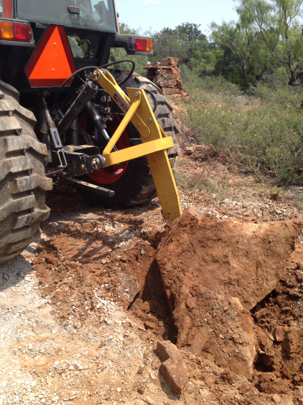

I'm surprised you sheered the bolt, I got a few spares but haven't sheered one yet.
I use mine to pop rocks out of the ground, and has worked beautifully. Once I hit the rock, extend my top link and up 3pt and there's the rock.
