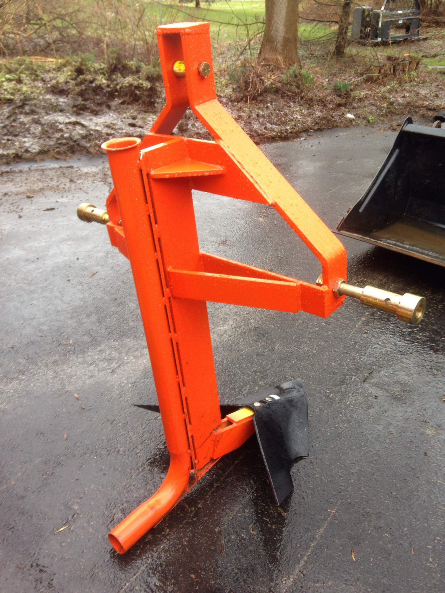

Hi Guys
I am new here and I am just wondering if anybody had any helpful information on how to make an ethernet/coax cable plow for like riding lawn mowers? I would like to bury the ethernet/coax at lease 3-5inches in the ground and I dont know what would be the correct way on doing this the cable is only 1/4in cable. I seen some pictures on here but I really dont want to rip up peoples yard when I do this.

Anything you build plow like and pull is going to rip up a yard. I just had a thought though, if you could find a way to use a coulter off of a breaking plow and hitch a gauge wheel to it to control the depth. Then it would slice the dirt rather than plow or rip it.
Another idea - the fellow across the road installed one of those wireless dog fences and used a concrete cutter to cut the trench in the grass to bury the wire.
On a different note, you are aware of the problems direct burying Ethernet and coax cable in climates where cycles of freezing and thawing occurs, aren't you? Contraction and expansion of the ground can cause the cable to break. If possible it is much better to direct bury the appropriate size sched 40 pvc to help alleviate that problem. Plus if you ever have to go back and add a cable you don't have to dig again.

Welcome to TBN. You need to go at least 18" deep to bury Cat 5/coax minimum. Best case is bury conduit and pull wires through it to point A & B.

I'd be surprised if a riding mower could drag anything capable of slicing a trench. My riding mower, with turf tires, loses traction if I have a heavy breakfast. Another option would be to use a gas powered edger to saw a slit in the ground and then push the cable down. Or use a shovel or hand edger to cut a slit and push the cable down in.
