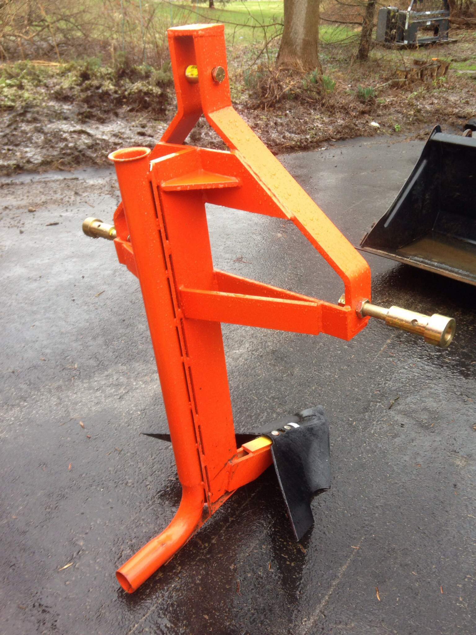

On the miller welder forum, in the projects users section someone made a cable plow. It had a colter to cut the sod, then a shank like a sub soiler with a curved pipe welded to the back side. The wire is held on a spool above the top of the curved pipe, and the wire is feed into the pipe as the plow is pulled allong. With the addition of a small wheel to push the sod down, you might hardly know it was there.

Here's what I had made up with a sub soiler. (It has a new wide point on it for drainage ditching and I can change the point back when done)
The tube needs to be flared at the top or you can strip cable if you are not careful. (Don't ask me how I know) Also there is a piece of angle iron welded to the back of the sub soiler to protect the tube in case you hit a large immovable object.
Works great and there is a little bit of tearing up of the lawn but it's a heck of a lot easier than digging a trench!
