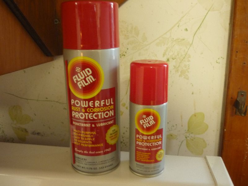

You wouldn't believe how many people tell me they like that smell. Hmmm.. maybe we should develop a Fluid Film men's cologne ? ;)
I thought that was what the cute little cans where for. :confused:
attachment.php
:D
