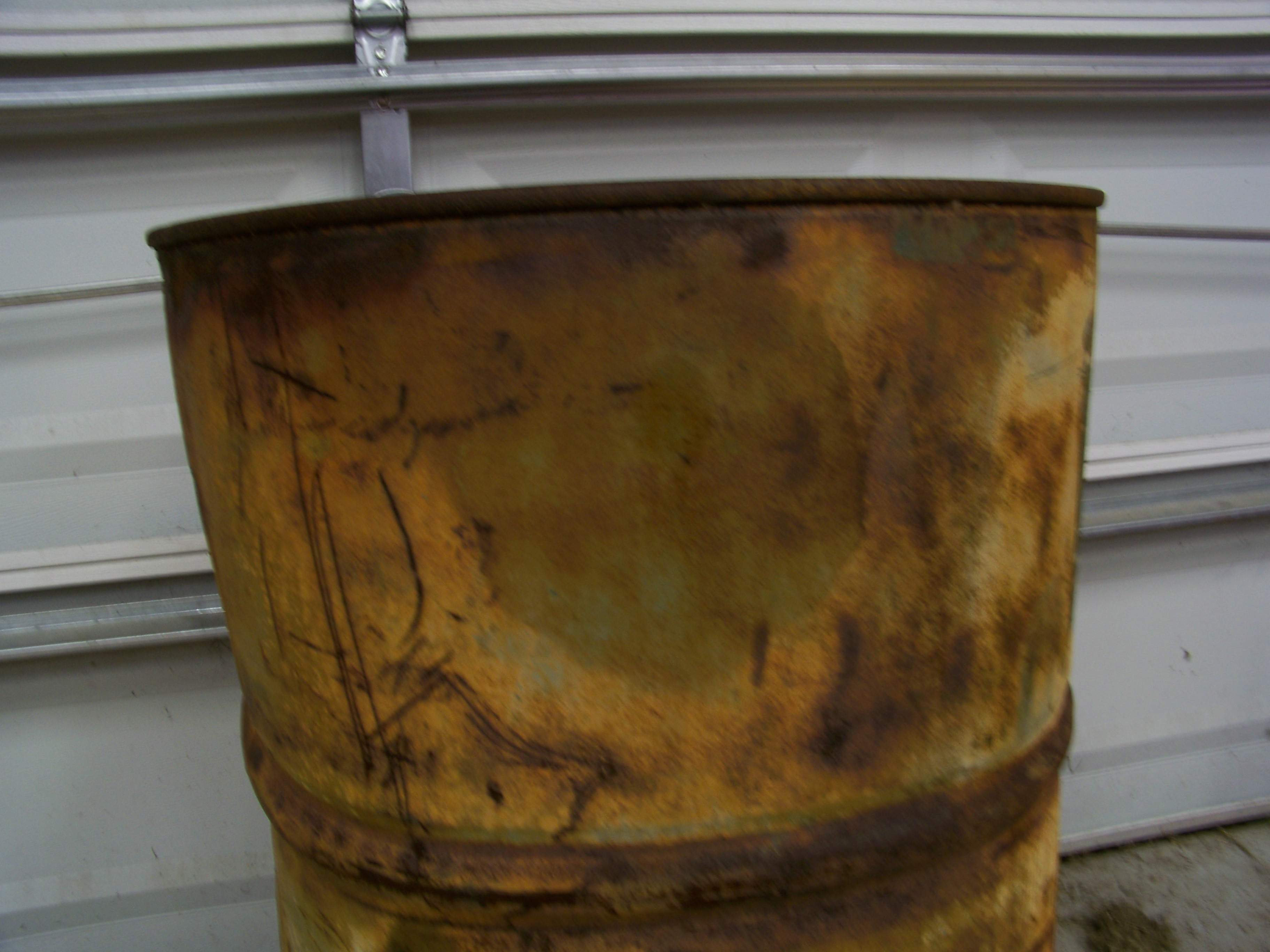

FF ability to wick and spread on metal has been most impressive. We are now in the middle of a nor'easter so I will have to wait until saturday and see how my test barrel looks. I sprayed a single 1X1 spot and it has spread beyond 9 inches horizontally. The FF has wicked upward aproximately 3 inches. I've been most impressed this time around, I think I was not liberal enough when applying the product in my previous testing.
Jim,
Let us know the results when you find out. Fluid Film has a tremendous ability to migrate quite a distance.

After 3.5 days of constant driven rain we finally started drying out on Sunday. I did find time to check the penetrating ability of FF on Saturday. The last spray I gave the exhaust clamp was on friday. On saturday I took a wrench to the clamp and both nuts broke loose easily. I was actually interested in seeing if FF had penetrated the threads under the nuts and to FF credit it was wet all the way allong the threads.
My test barrel has shown me that FF needs time and temperature. When it was near freezing at night I observed little to no growth to the application site. The temp has actually risen and held in the 60's and 70's and the area seems to grow each day. If it was summer I think it would have A) grown much faster and B) become much bigger then it is now. I'm going to run a similar test on the same barrel in the summer time to see if this holds true. I have a bunch of plastic and metal barrels so 1 more year before this one sees a fire.

I moved my test barrel to my garage so I could take a couple quick pics of it. Originally I thought the test site was 1X1 it was closer to a 2X2 circle. I'll be honest I was excited it was a new can of FF and I was a bit to close when I applied it. The FF has migrated to 7 inches side to side horizontally and 8 inches top to bottom vertically. The vertical expansion from the top of the spot appears to be around 2.5 to 3 inches. Its a little hard to tell now as my original application site is fading as the product spreads. I took 1 with a flash and 1 without for comparison. Its important to note that this is after the barrel sat outside for 3 days of 60mph wind gusts and driven rain. Link below to images from a local TV station showing what the weather was like.

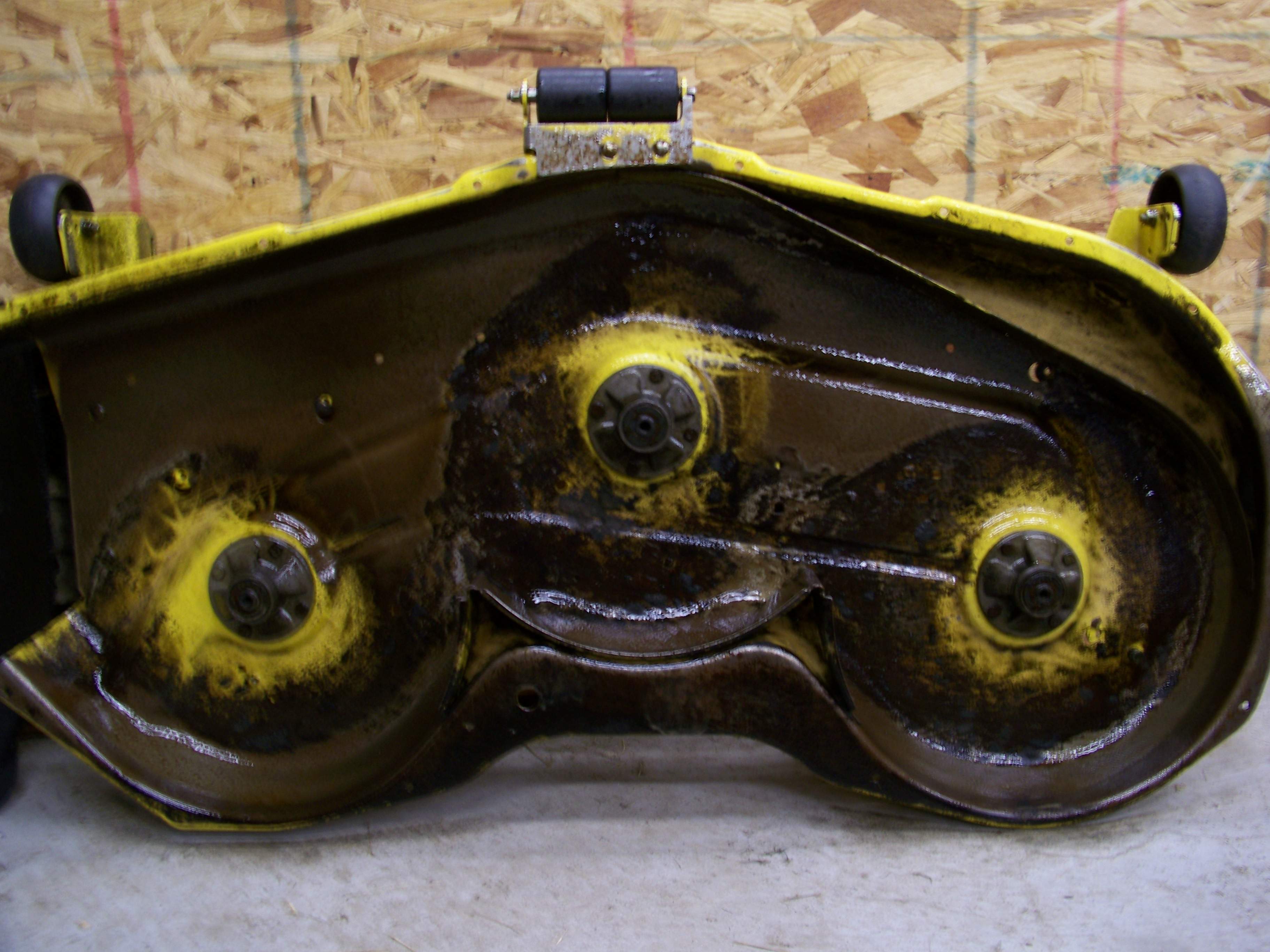

I also took 2 similar shots of the deck from my Z445. Its only 2 years old and honestly I am very surprised by the level of corrosion I found once I cleaned it of all its build up. This deck has a washout port that I use after every mow but there is still a bit of build up as the season progresses. I removed the deck pulled the belt and blades, then pressure washed the entire unit spending most of my time on the bottom of the deck. These are from tonight, I had applied FF to the deck yesterday once the deck had dried in the sun. My garage smelled like a little slice of heaven to me.
