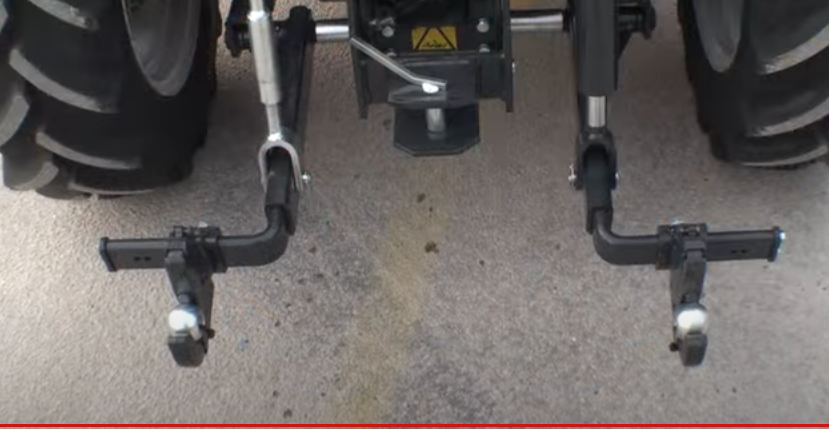

Photo is taken from the timeline at 3:45 of the above video. It caught my eye having seen nothing like it previously. Is it made to handle CAT1 and CAT2 or is the idea to not allow any side sway?

That's another characteristic of the specialized tractors for orchards and vineyards. It goes along with all the other stuff we discussed on another thread that got closed.
Some of them are so narrow, that there is absolutely no room for stabilizers. So they came up with that design. Some are like the ones you showed, with no side play. While other actually have hydraulic stabilizers incorporated in the rear end housing, a more expensive solution usually available on higher end tractors. As you mentioned, it also gives the ability to use Cat 1 or Cat 2 implements. Top and Tilt setups are also a common feature on these tractors.
European brands like Same, Deutz, Antonio Carraro, Lamborghini, etc, will offer models with this style of 3 pt hitch.
With that fixed design, there is no need to have side play because of the way the arms are built and come out of the tractor in a straight line. While on the common 3 pt setup, it needs side sway to accommodate for an imperfect linkage movement going up and down cause by the bent design of the arms.

Thanks for the feedback from across the pond! I'm trying to visualize the "imperfect" component of the conventional 3PH. I can see it if the front pivot point of the side stabilizers isn't in line with the front pivot of the lower arms.
   / European Three Point Hitch 3PH? #6
Yes, I should I added that part. Usually the pivot point of the lift arms and the pivot of the stabilizers is not actually in line, so it can cause binding if the stabilizers are adjusted too tight and there is no side play.
