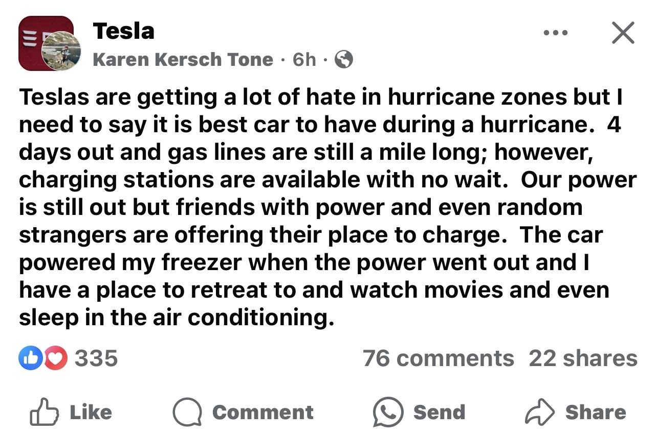

It was really hit and miss. It depended on where the storm rolled through, and how much damage it caused.
I've been through some storms where we didn't lose power, but had a gas shortage for a week or so because the port was in the path of the storm.
I've been through other hurricanes where we were out of power for a couple weeks. But there wasn't really a shortage since the storm was never near the port. So fuel deliveries were only delayed for a day or so while the storm went through the area.
