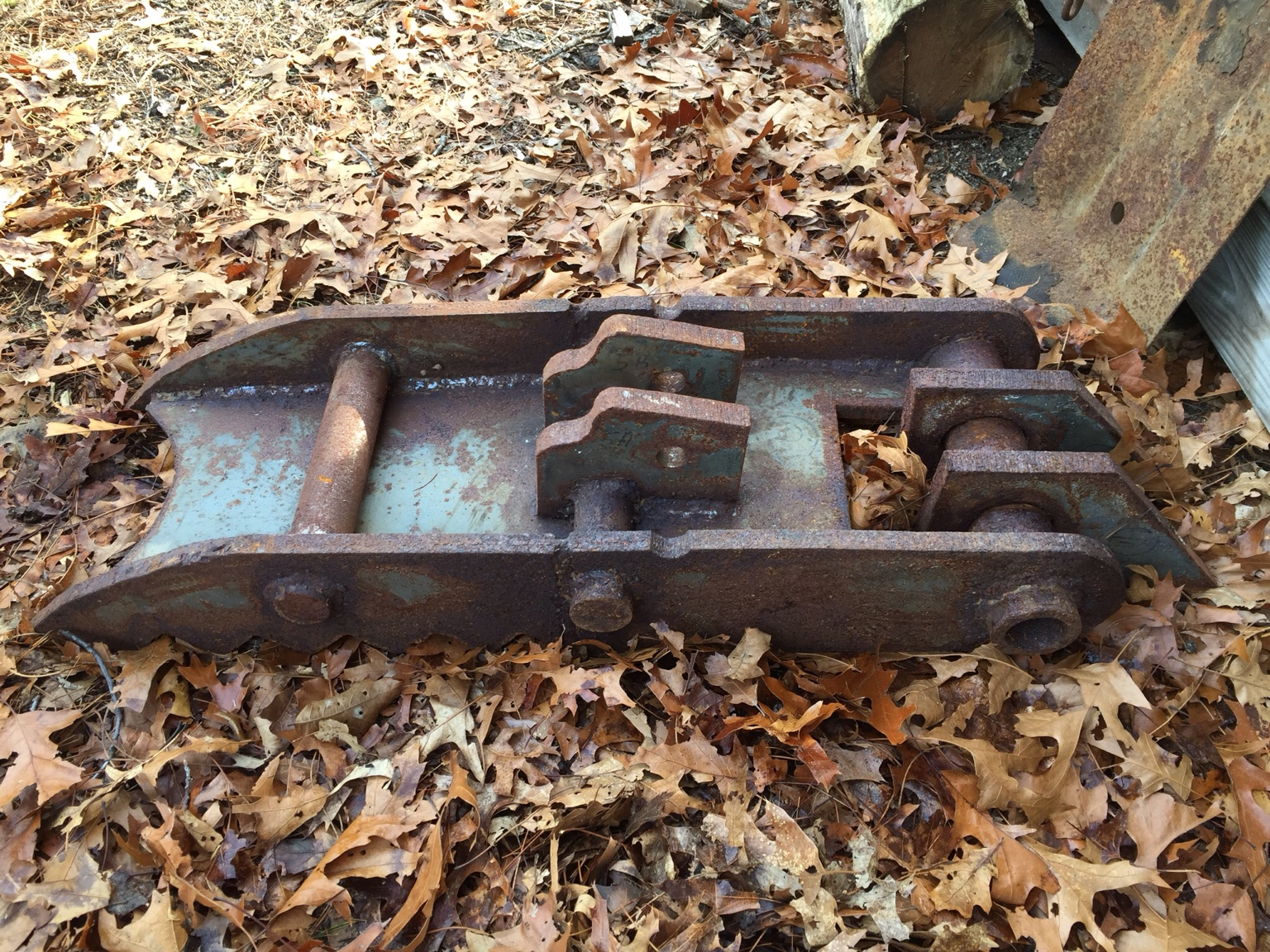

I'm gonna look more into what's involved with the thumb, and adding hydraulics. I don't know how much different this project would be than adding a hydraulic thumb to the 410, but that is what I originally built this thumb for, but never ended up installing it on the 410 since I never trucked that up to NH.

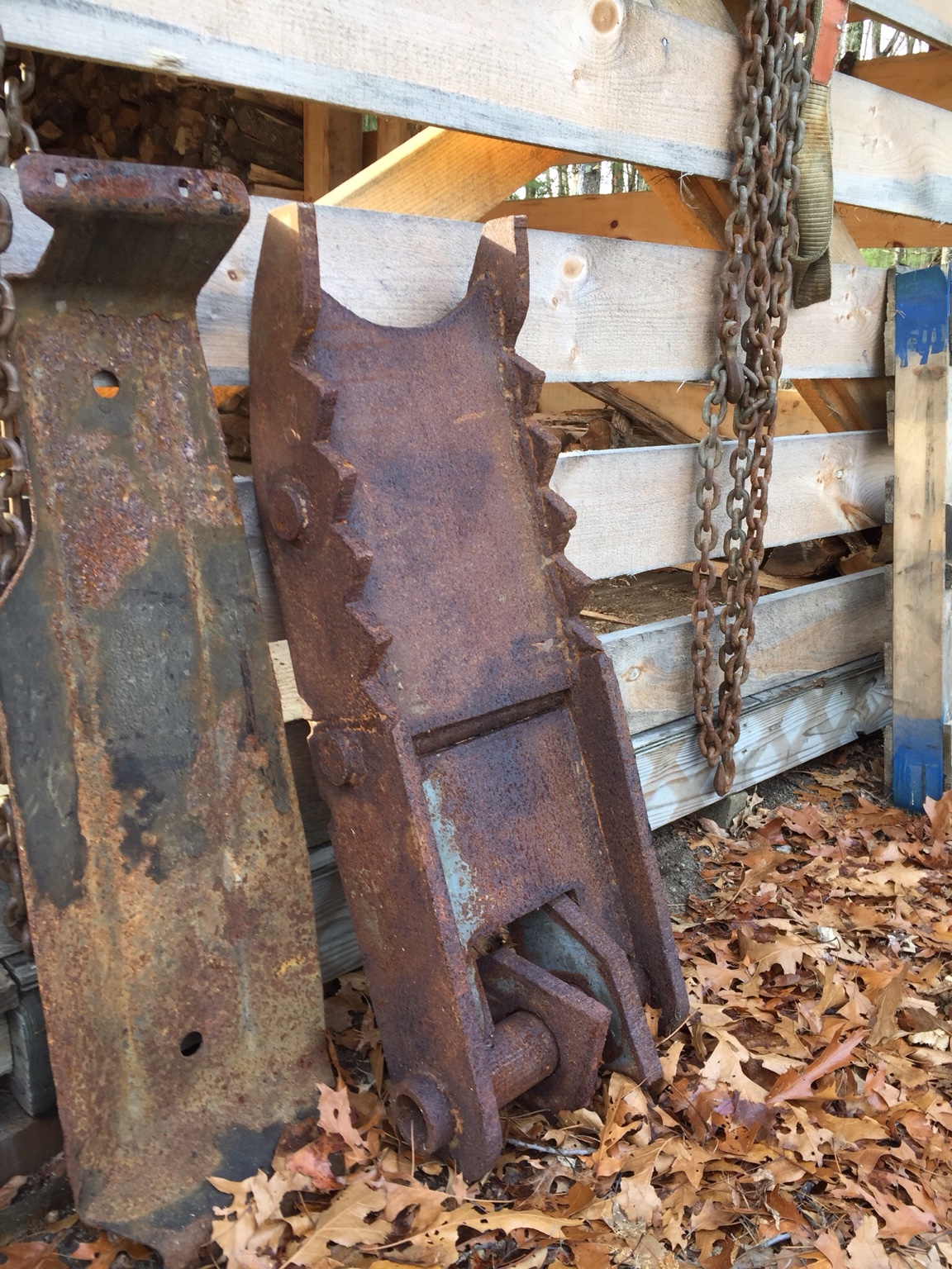

Anyway that you could add side plates to extend the thumb to the right length for the excavator bucket
This is the thumb I made. It would be a little short, but it's made out of 1" steel and 3/4" steel.
Also, I already have a selector valve that I purchased for the 410 project, I think it's 15 gpm, not sure if I'd be able to use it with the excavator but I'll take a look.
Yes it should work, make sure you get a good 4 way cushion valve, and remember to curl the thumb to the bucket into squash the bucket int the thumb, at least not with full pressure.

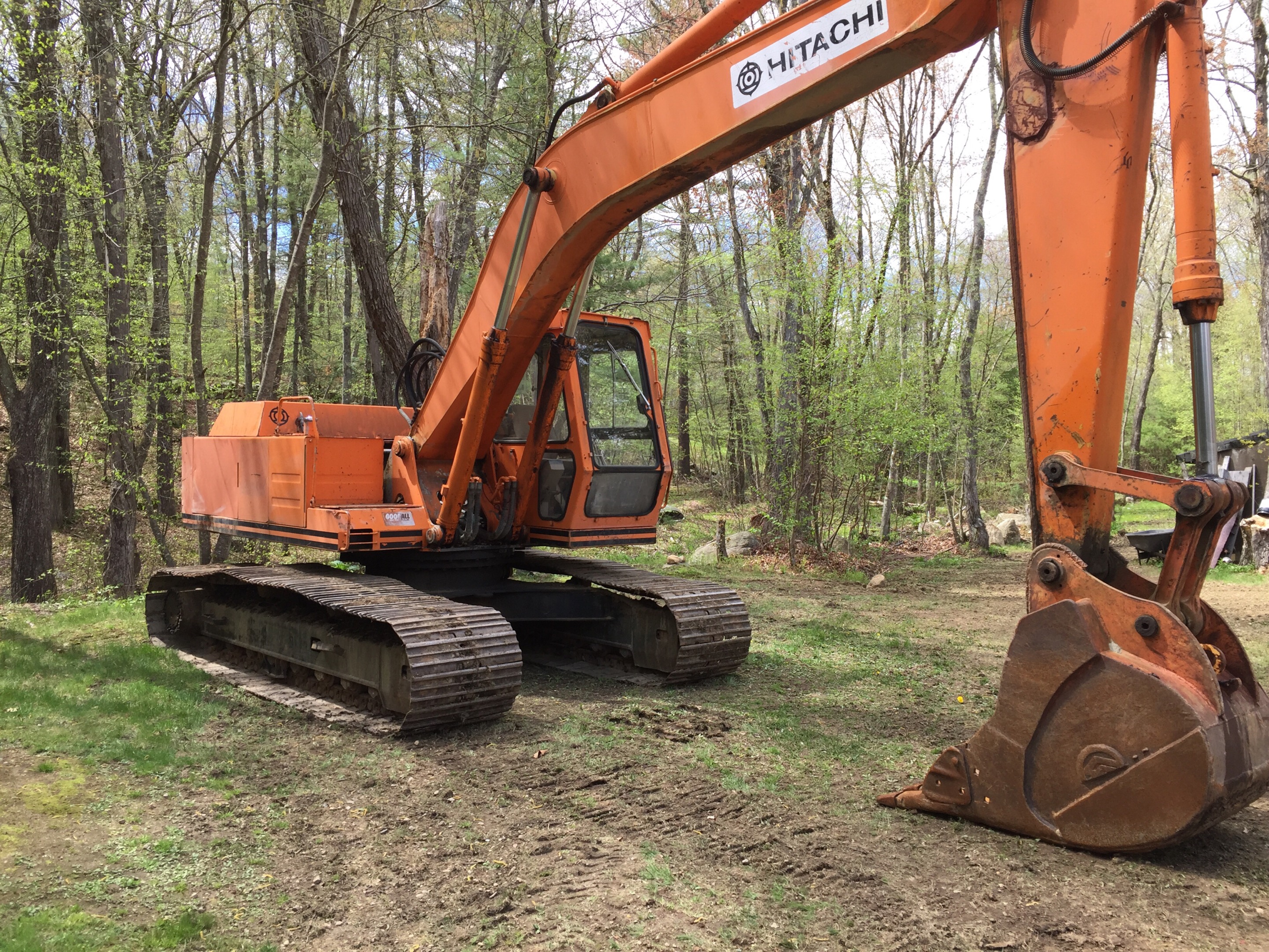

Is there an adjustment for the track motor speed that could just need fine tuning?
Pressure in the drive valve can be adjusted. Check seals on valve.
He told me that I need to put some grease in the track adjuster on the loose track to tighten it up. Is there a rule of thumb as to how 'tight' you want to make it? He mentioned putting a 2x4 along the track and measuring the distance of sag, but I don't recall how much sag it should have.
I run mine tight, don't do this at home. You should be able to stand on track and bounce.

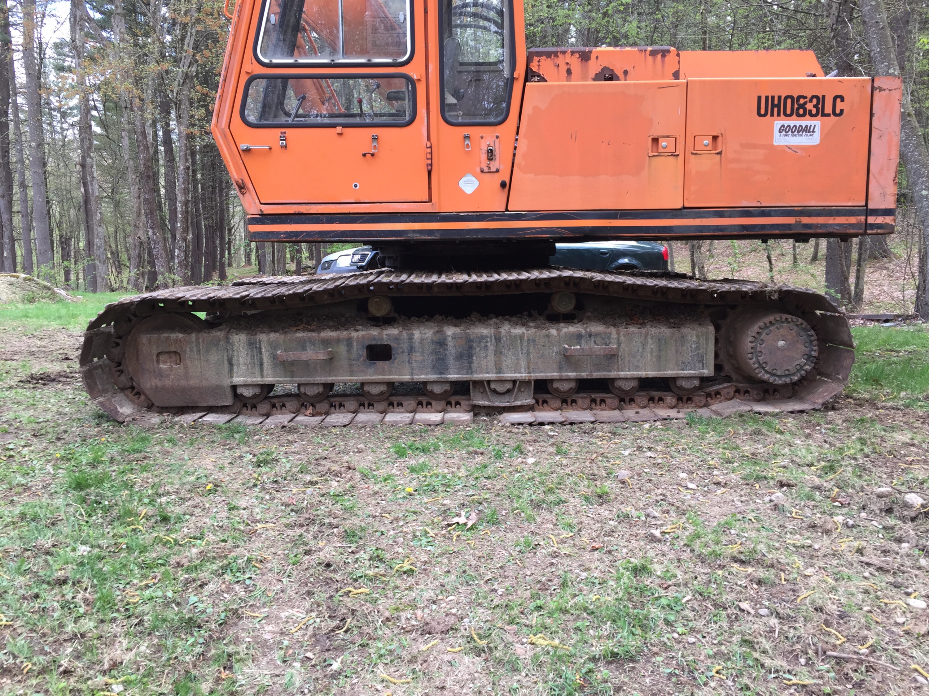

I've seen worse looking machines for more $. If it does what you need right out the gate, $10K is a good price in my opinion. As with anything, there could be a multitude of things that are failing or about to fail. The undercarriage is not horrible by any means, but it might need the track adjusters rebuilt to keep the track tight. One of the travel motors could be failing since it won't drive in a straight line, those can be very expensive to fix. The biggest fear I have of older equipment is the lack of parts.
I agree with this post^^^.
Depending on condition this may be a $20,000 machine. Track and undercarriage repairs if needed can be costly. Waiting to see what his selling price is. Overall it appears to be in good shape and has been well cared for considering it is over 30 years old.
   / Evaluating Undercarriage and Overall Condition for Purchase (Hitachi Excavator) #14
Looks like the sprockets could use a little love, along with the track chains. There also doesn't appear to be much adjustment left as far as track tension but I could be wrong. For the right price it would otherwise be well worth it knowing it will need some track and sprocket work down the road. Also look really close at the pins and bushes, make sure they aren't in need of line bore if they have worn past the bushes. That can get a little pricey to repair

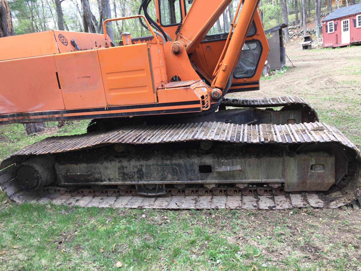

#15
I have a question for all you experienced "track" guys. The tracks were a little loose, so I added some grease to tighten them up a bit. I was a little concerned of overtightening them so I want to get some opinions.
One track is a little tighter than the other, does one look a little loose still, or does the other look a little too tight?
   / Evaluating Undercarriage and Overall Condition for Purchase (Hitachi Excavator) #16
I'm not sure on your machine, but on my Case dozer the tracks are suppose to sag 1" between rollers. So you have to have tension on the bottom from moving forward to get that measurement properly.
Again I have no idea what your machine specifies.
   / Evaluating Undercarriage and Overall Condition for Purchase (Hitachi Excavator) #17
Piston,
Did you buy the old girl? The tight track is ok, looks a bit tight not bad, Loose one is loose.
