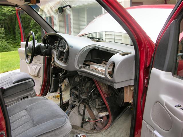

I'm going to have to try your method GIJOE because my way isn't working at all, nosirrebob. Thought I had it when the PVC valve wouldn't rattle and the hose connected to it collapsed flat with vacuum when the engine was running. The short hose connected to it was soft and made me think for a minute that the job was done.
If I ever get another vacuum leak in my lifetime it will be too soon. :(

pineridge: good to see ya posting here again. it is one of the most nerve racking things finding vac leaks. my truck (also a ford) has one someplace too only a few years older than that pic. :( otherwise it runs like champ
propane an or starting fluid works best that i've found as long as all the factory air box stuff is attached, (I used small rag and or cotton balls coated it the stuff to keep it close to the line and work way around)

Hey Spiker how ya doing? Had to put the van back together since we're taking it on a jont pulling an enclosed trailer the 3rs and 4th of this month.
Once we return guess I'll have to take it back apart and get back in the "find the leak" mode once again.
This Ford van has less than 100k miles and really is a sweet driving van. Just has that blasted nagging vacuum leak.

Mike, I would look real hard at those hard plastic vacuum lines that go into the rubbery joints especially where they go through the wiring looms into the dash area.
I have some now on my 96 Ford that need changing.
I would go with the propane and tubing for what you are doing.
