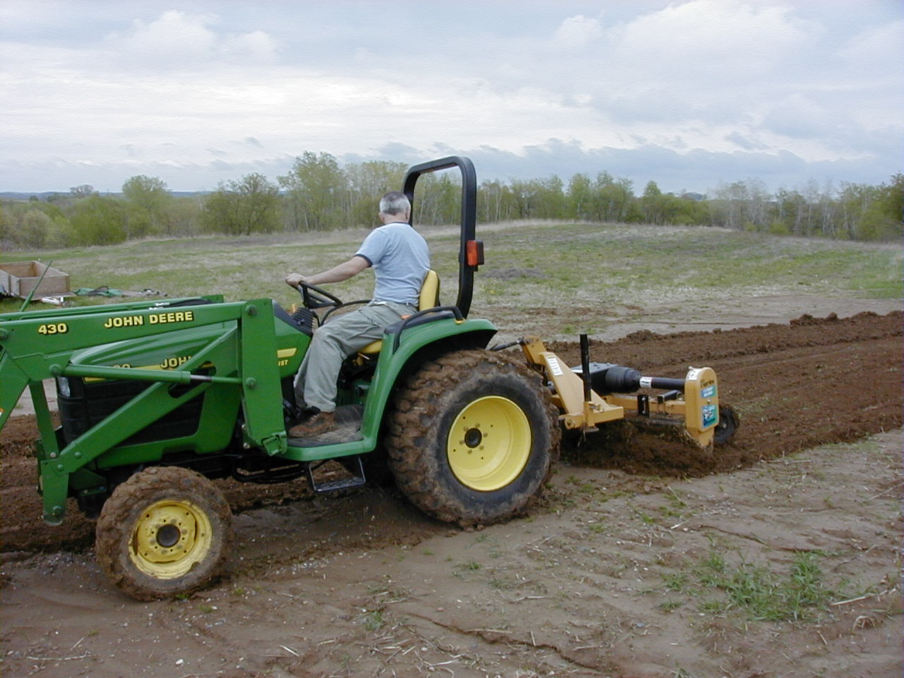

Used to have a JD dealer that would rent a Harley 3 pt rake, and they are priceless for the few times one needs it. But to own one, would have to go into business to pay for it.
They won't do well tearing up sod, but if the ground has been recently tilled and needs grooming, they can't be beat. Even do pretty well when the ground is on the wet side, but helps to dry it out for a second pass couple hours later. Great for ground with building debris and rocks (within limits).
Local IH dealer has a HR to rent for a skid steer and is quite reasonable, even if one has to rent the skid steer for a day.

It looks like a good and expensive tool
