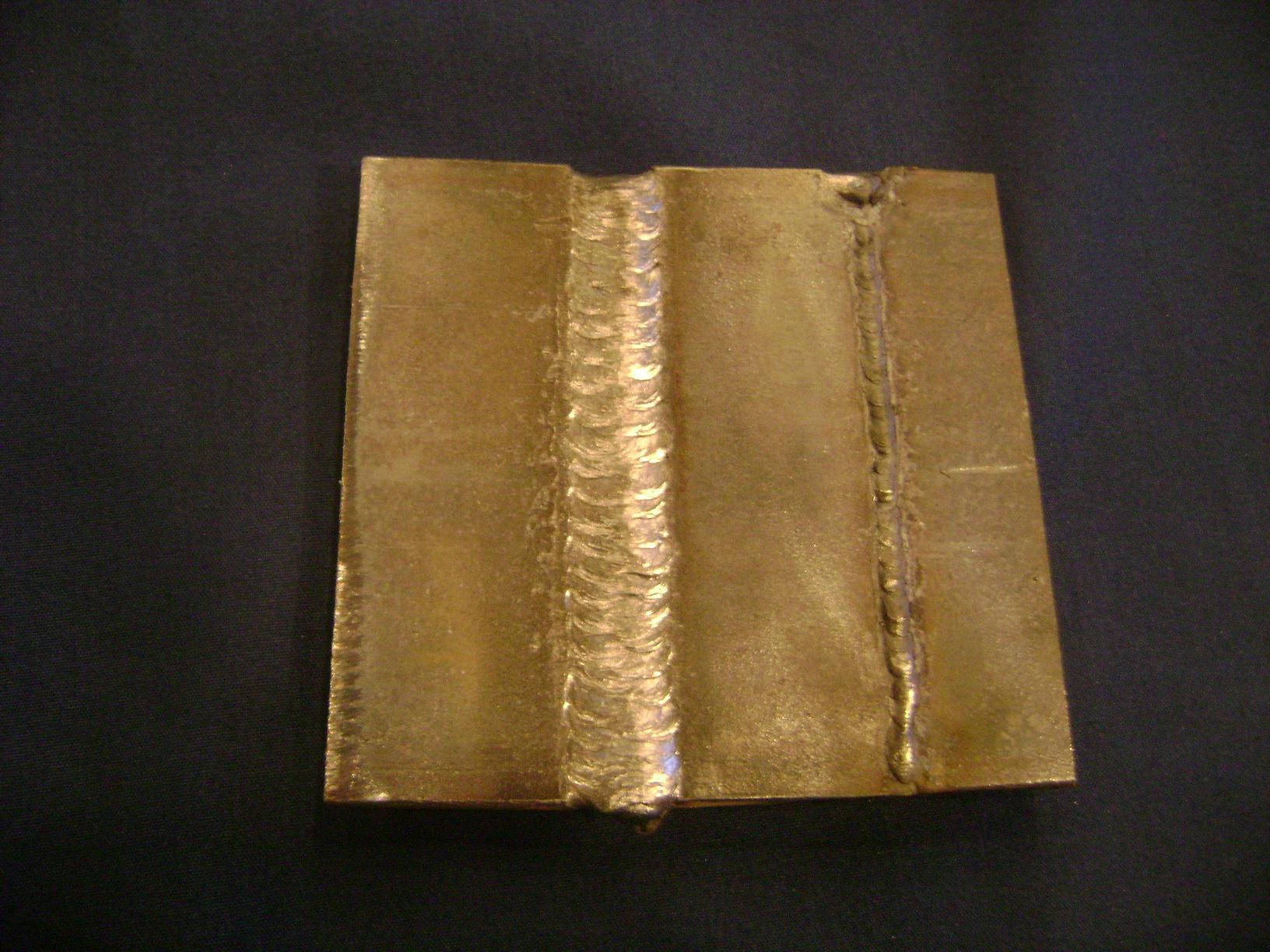

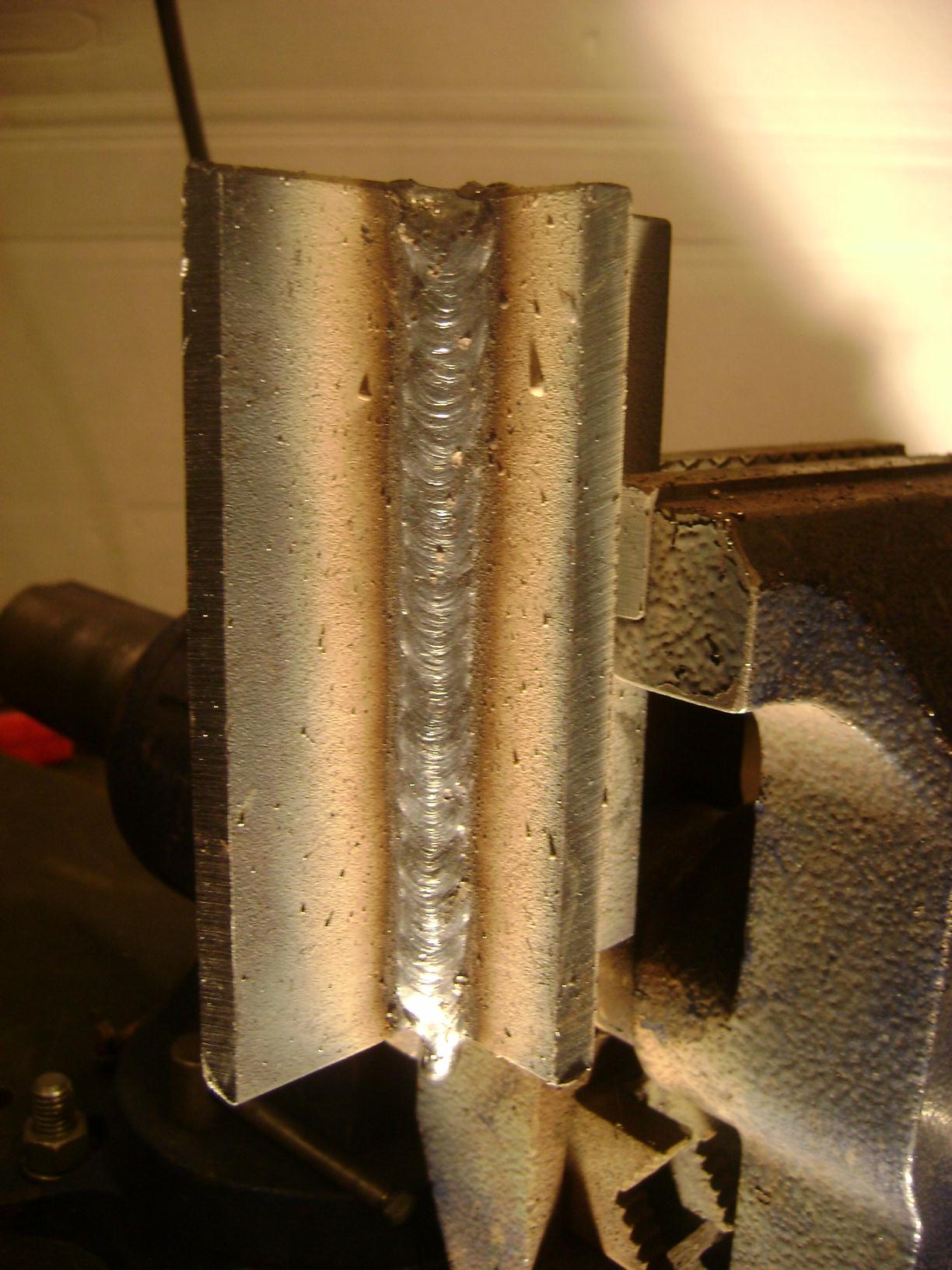

Somebody more knowledgeable might have more to say but that second try look like good welds to me. (I would be proud of them if I laid them down.)

I'm convinced these inverters like specific brands of rod. My PA-200 seems to do best with ESAB's Atom Arc 7018, same with my V350-Pro. But Furu's Longevity Stickweld 250 likes Lincoln's Excalibur 7018 best.:confused3:
Here is some vertical up Atom Arc 7018 run with my PA-200.
   / Everlast PA 200 ST arrived #35
Wow, They are beautiful!

Thank you!;)
But it's not me, it's the machine. I think Mark screwed over SSdoxie by talking him into the ST model.:D
:laughing: :laughing: You want to come out and try it? Heck, you probably teach how to use it at the same time. :cool2:

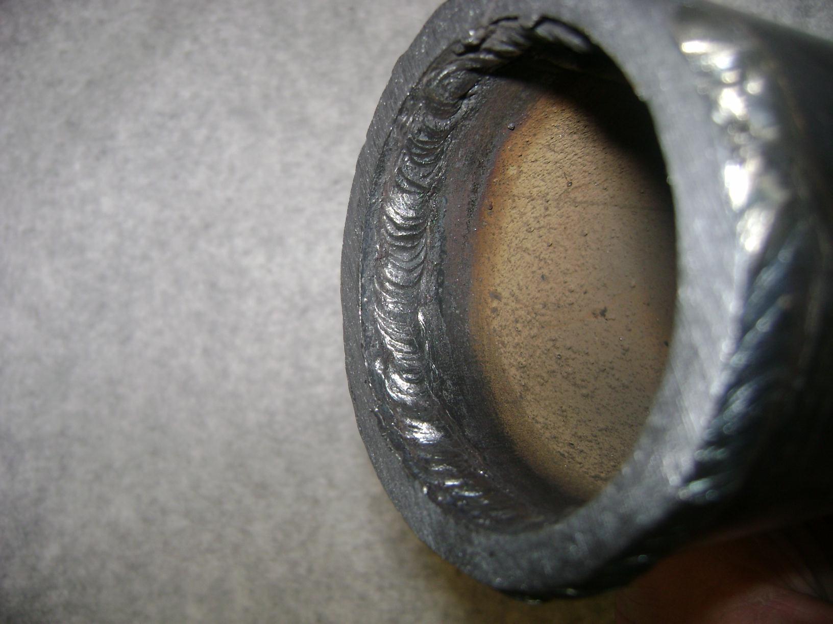

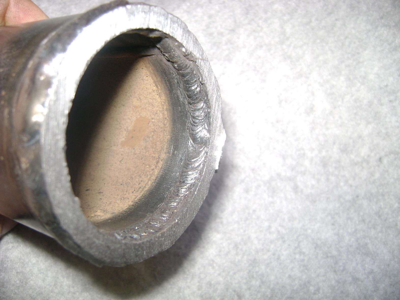

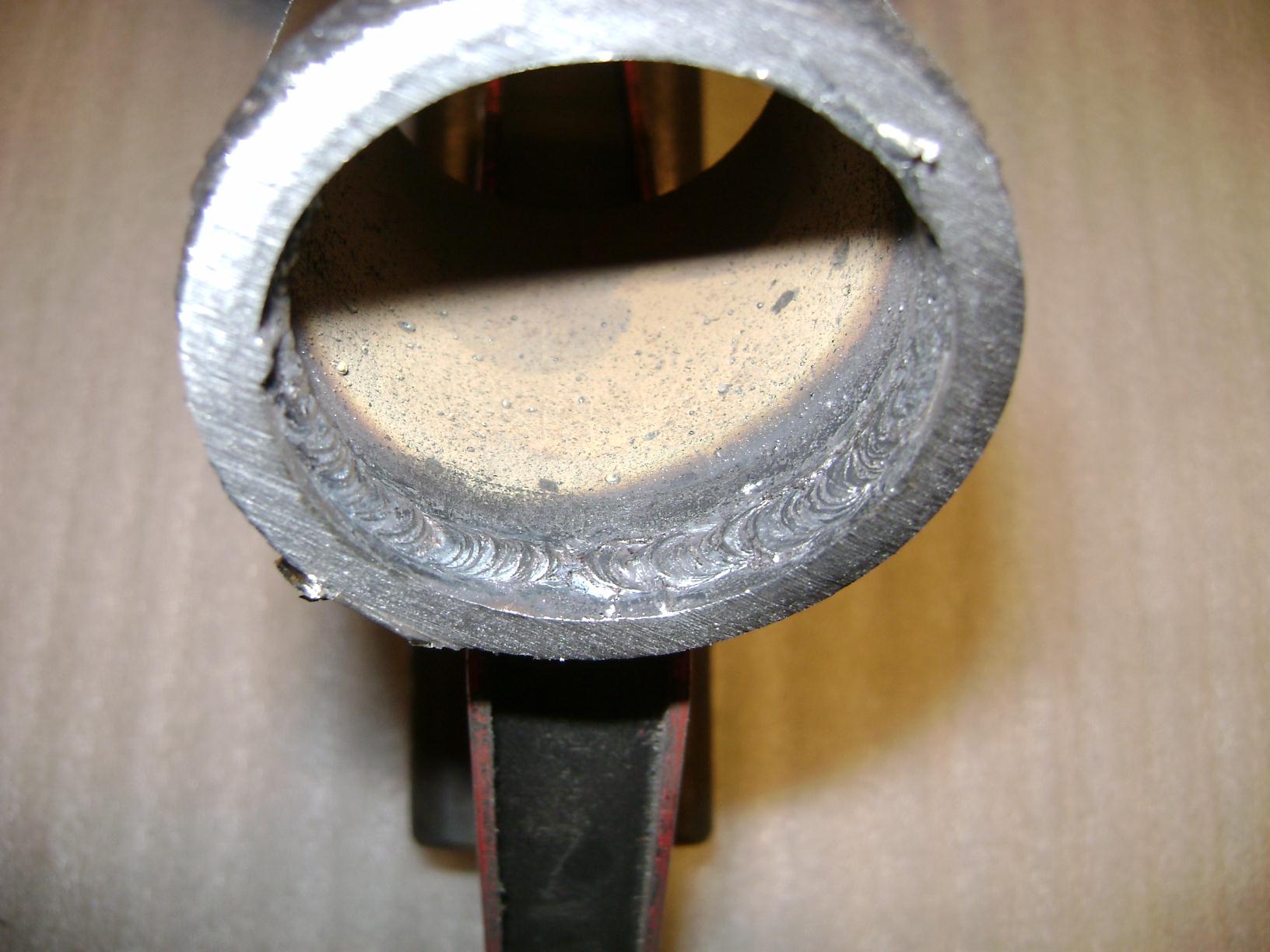

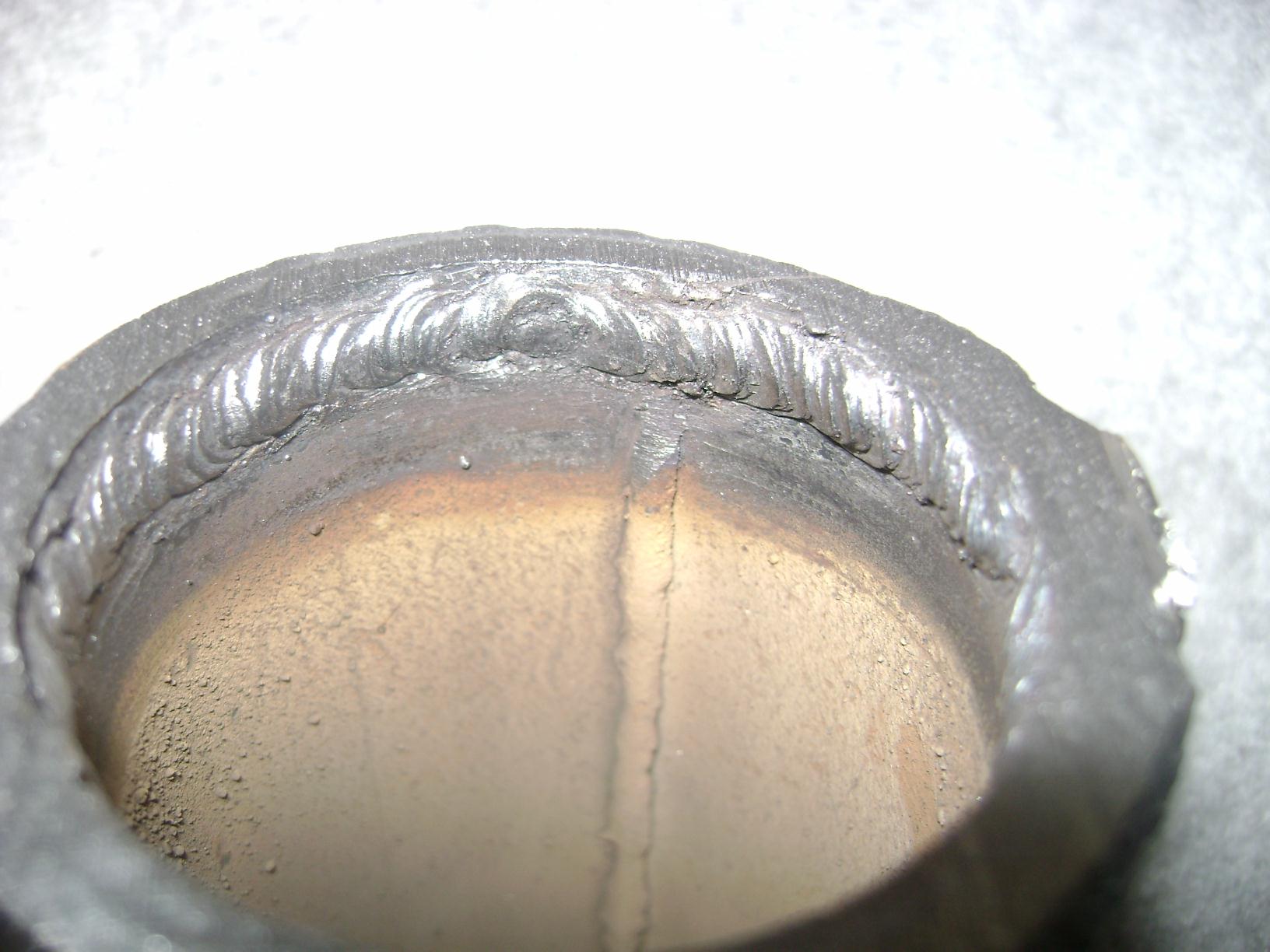

Like I said my PA-200 likes ESAB's Atom arc 7018, and ESAB's 10P-Plus 6010. Here is what they look like on pipe. I've also had good luck with Hobart's 335A 6011.

Oh you'd probably be teaching me.;)
Now that impresses me [not that the other ones didn't] How did the root pass look? Lots of experience with the excaliber 7018 and the 5p+. Didn't really like the + at first but it grew on me after I got used to it. CJ
