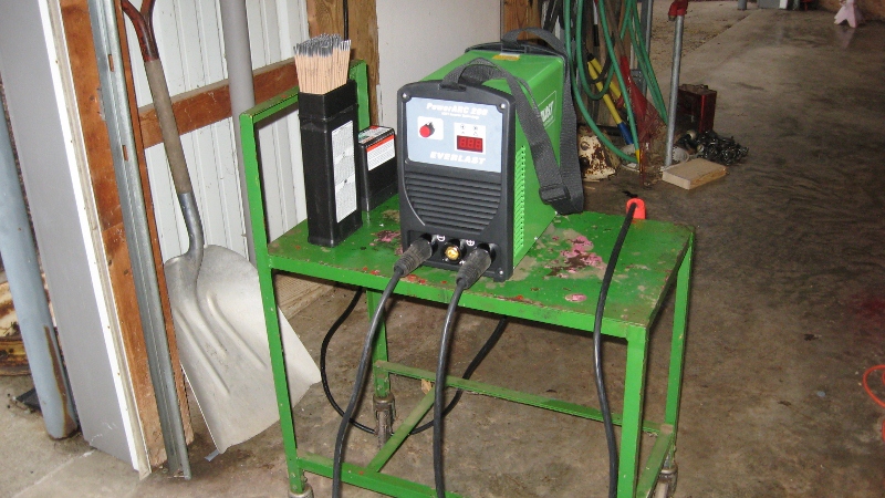

Everlast PowerArc 200 Arrived Today

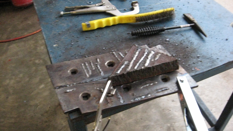

I finally got to play with the PowerArc 200 today.:) 039 (800x450).jpg
037 (800x450).jpg I am a very amature welder but I really enjoyed running some beads with it.:thumbsup: I think the first project will be making some custom kidding pens for the goats this spring.:D

Hey Hoos, What rod is that you are running?
   / Everlast PowerArc 200 Arrived Today
#16
1/8" 6013.

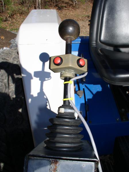

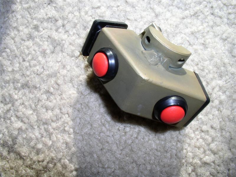

Made this loader 3rd function switch box from a piece of 1"x1" tube. Cut a pie shape out and welded it back. Welded on a split shaft collar for mounting.
