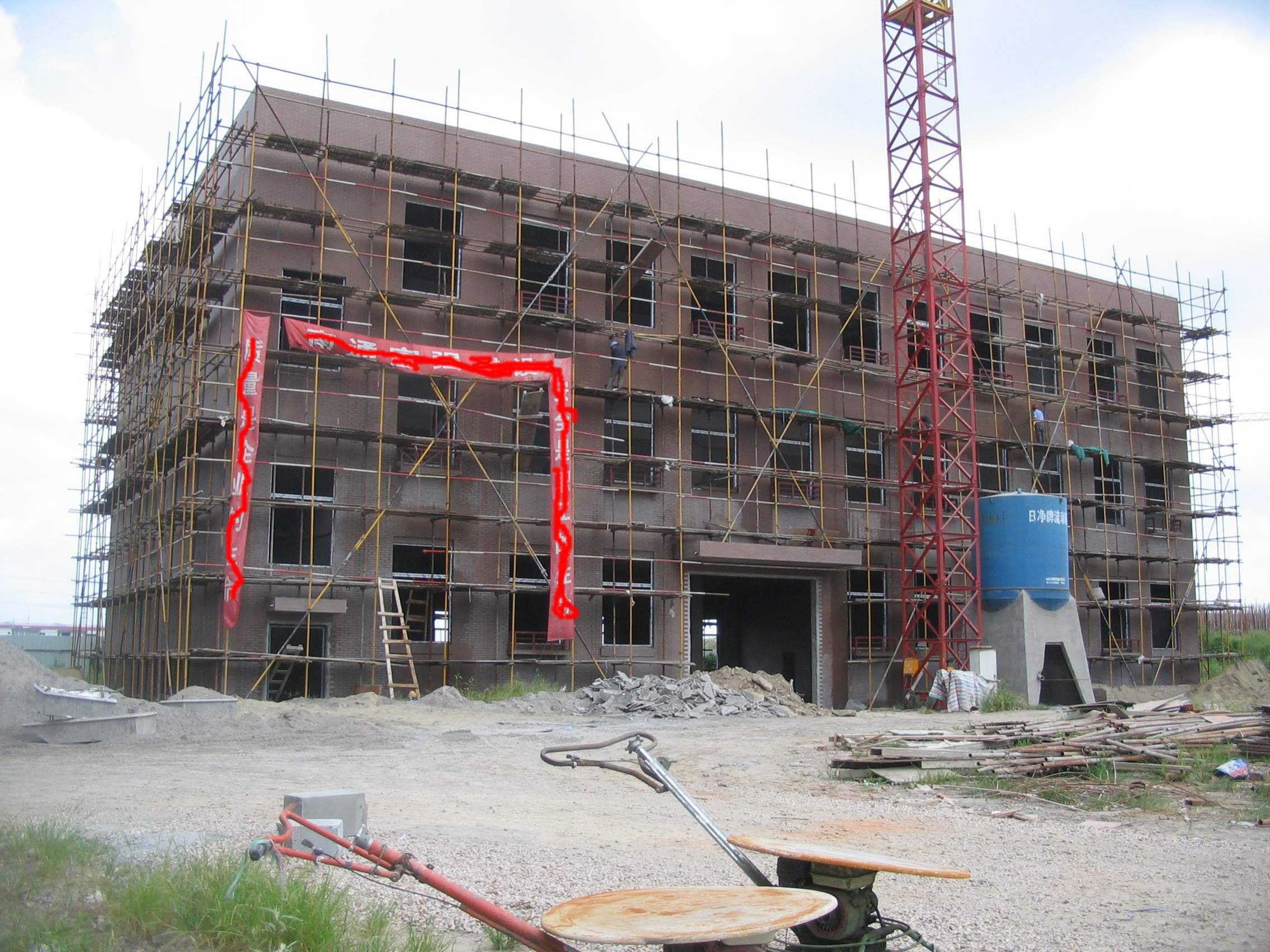

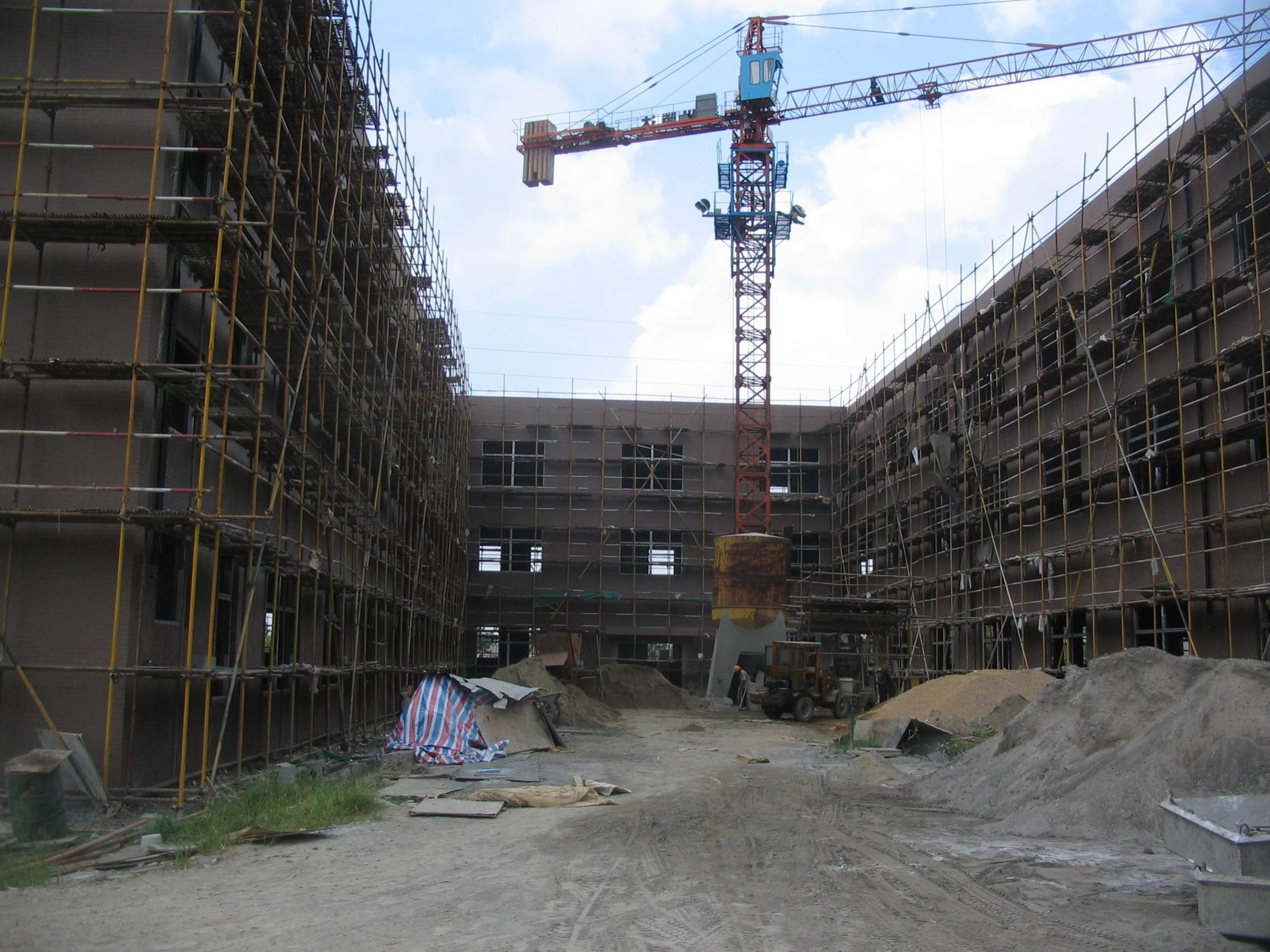

Here's the pictures of the factory in progress from last year. One thing I did fail to point out, is that this is a "private" factory, not run or owned by the Chinese government, and has been in business since 1994 producing welders.
