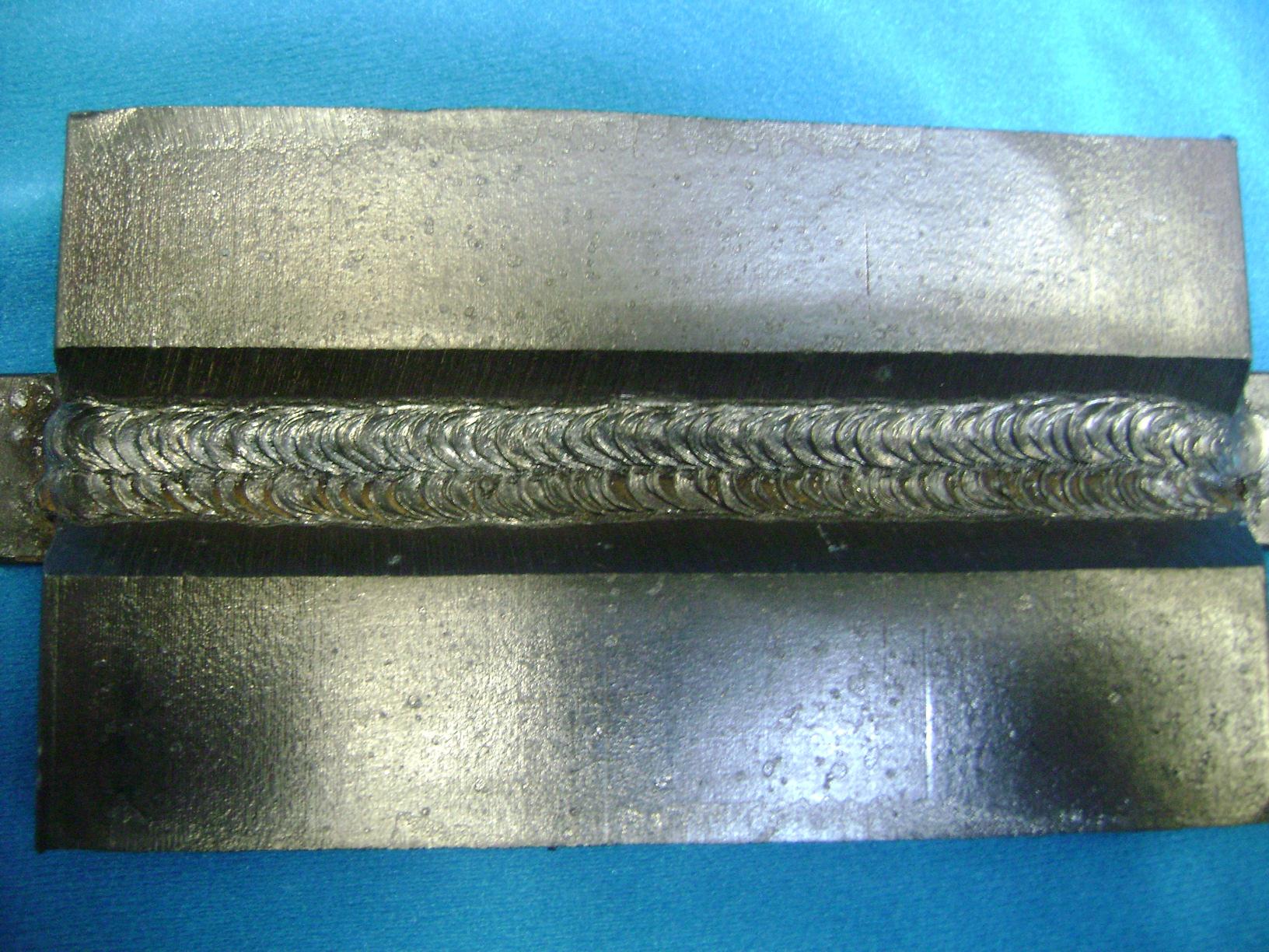

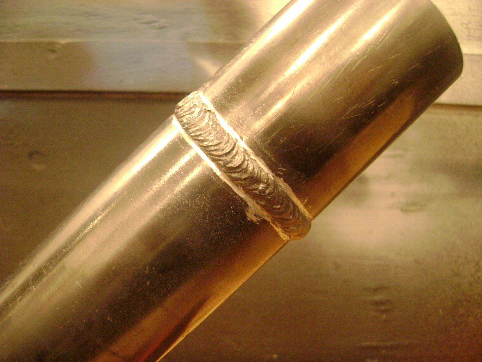

Once Mark got it through my thick head, that with the PA-200 running 6010 you have to hold a close arc length.
This is what the PA-200 can do with 6010.

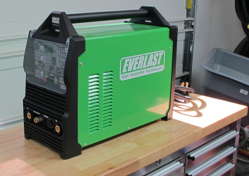

The new Everlast PowerTIG 255 EXT arrived yesterday!! Fast shipping I ordered it on Friday and it arrived at my door on Tuesday. No shipping damage, zero. I'm pretty happy with the fit and finish as well.
They are packed quite well with ample foam and heavy duty boxes.

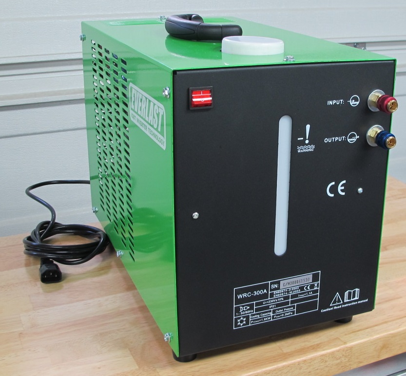

The cooler is fairly large I like it, note the quick disconnect fittings.
The welder has a bit of heft to it but I would say its portable. Compared to my Lincoln 210MP the Everlast is about 3 inches taller, 3 inches longer, and 1 inch narrower. Like the Lincoln it has plastic feet molded into the front/rear bezels. The Lincoln slides around on my welding cart so I guess I'll get a sheet of 1/8 rubber to line the welding cart. The cooler has 4 nice rubber feet so its good to go.

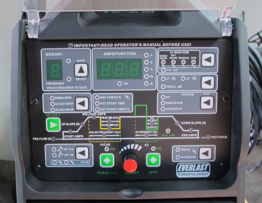

As a computer geek this front panel doesn't intimidate me, it seems pretty straight forward. I know some are saying unflattering things about the membrane switch panel but I have used membrane switch panels outdoors for years in hot, humid, rain, dirt, conditions and they take a beating and keep on ticking completely sealed from the elements.

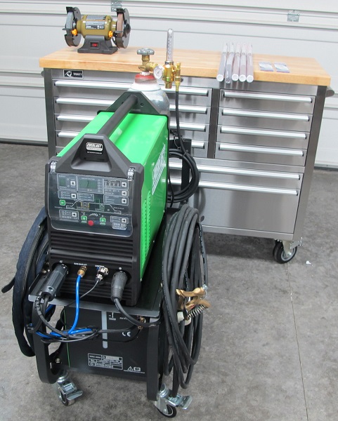

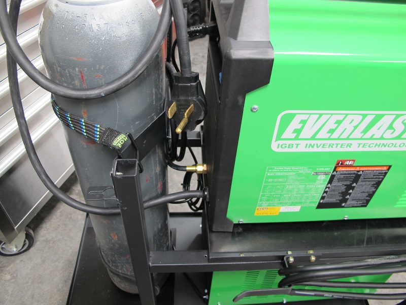

Well I finally have everything assembled and ready to weld after a torch hose fiasco and blowing the coolant out of the torch gas hose :censored: I managed to spend more money (shocker) on a tungsten grinder and fine grit wheel, E3 tungsten in 1/16 and 3/32, a bunch of stainless and steel filler metal. Tomorrow after some practice welding my first job is fixing a broken mill drawbar. Then I don't know, I'm sure my Kubota 2920 needs something made of stainless :scratchchin:

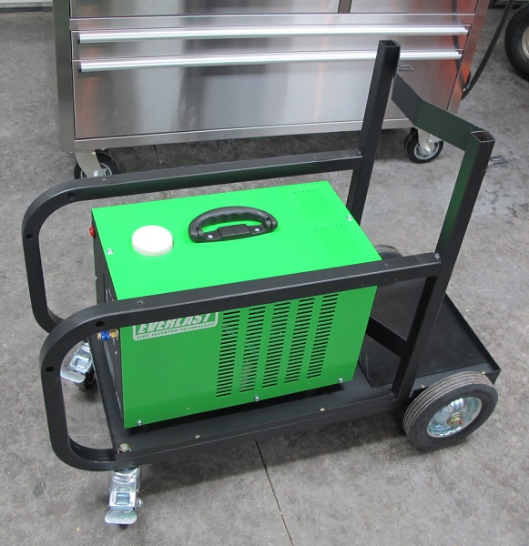

It fit on my Metal Man UWC3 welding cart...barely.
This cart is rated for 400lbs, really nice locking casters and metal ball bearing rear wheels. I cut the 3 prong dryer plug off the welder and installed a 30 amp 250v twist lock connector and assembled a heavy cord.

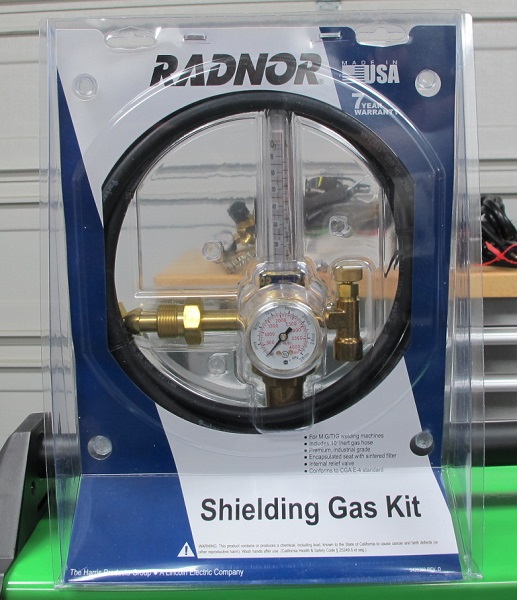

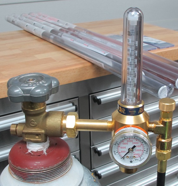

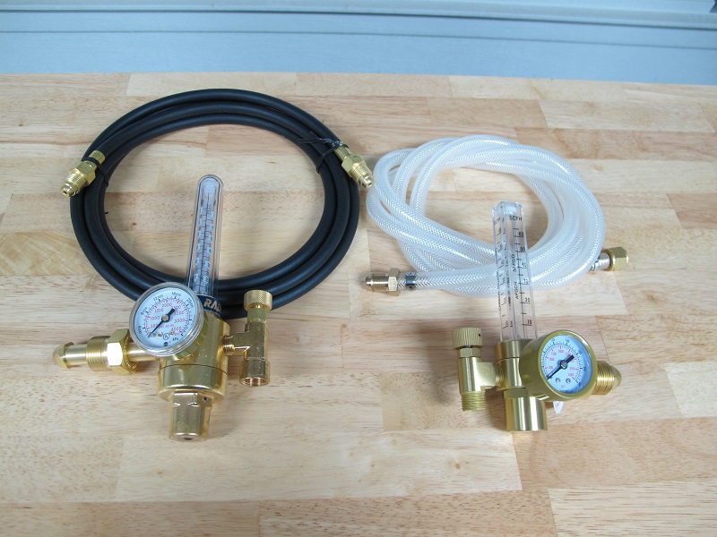

I upgraded to this Harris made in USA flow meter and hose.
Here I had to remove the top shelf of the welding cart to lower the behemoth cooler down onto the cart from above, it was about 1/8 inch too tall from fitting through the front dang it.
Here's a close up of the Harris
Here's a side by side comparison. I'm not saying there was anything wrong with the China flow meter, the hose was kind of wimpy, mostly I just wanted a nicer flow meter.
One problem I ran into was Everlast located the gas inlet right smack in the center of the machine. This 255 EXT is long, about 3 inches longer than my Lincoln, this is a large welding cart and it just barely fit but the hose and fitting butted up against the argon tank so I had to move the top shelf of the welding cart several inches forward.
