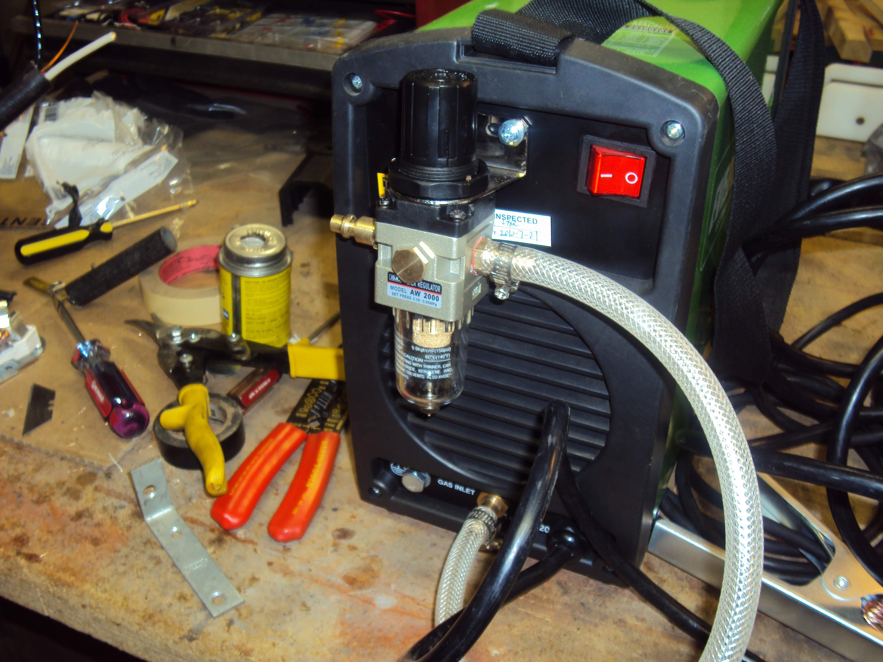

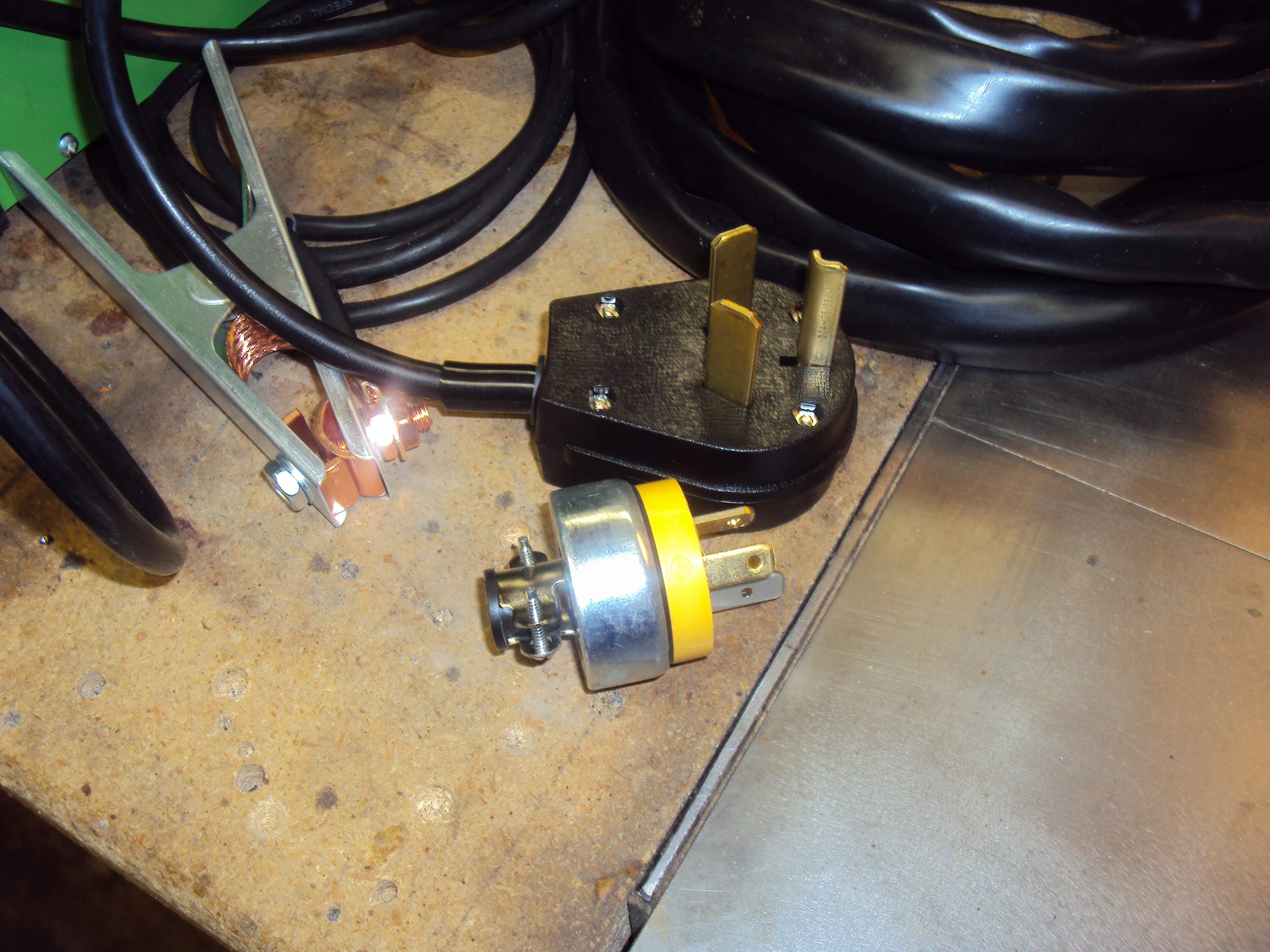

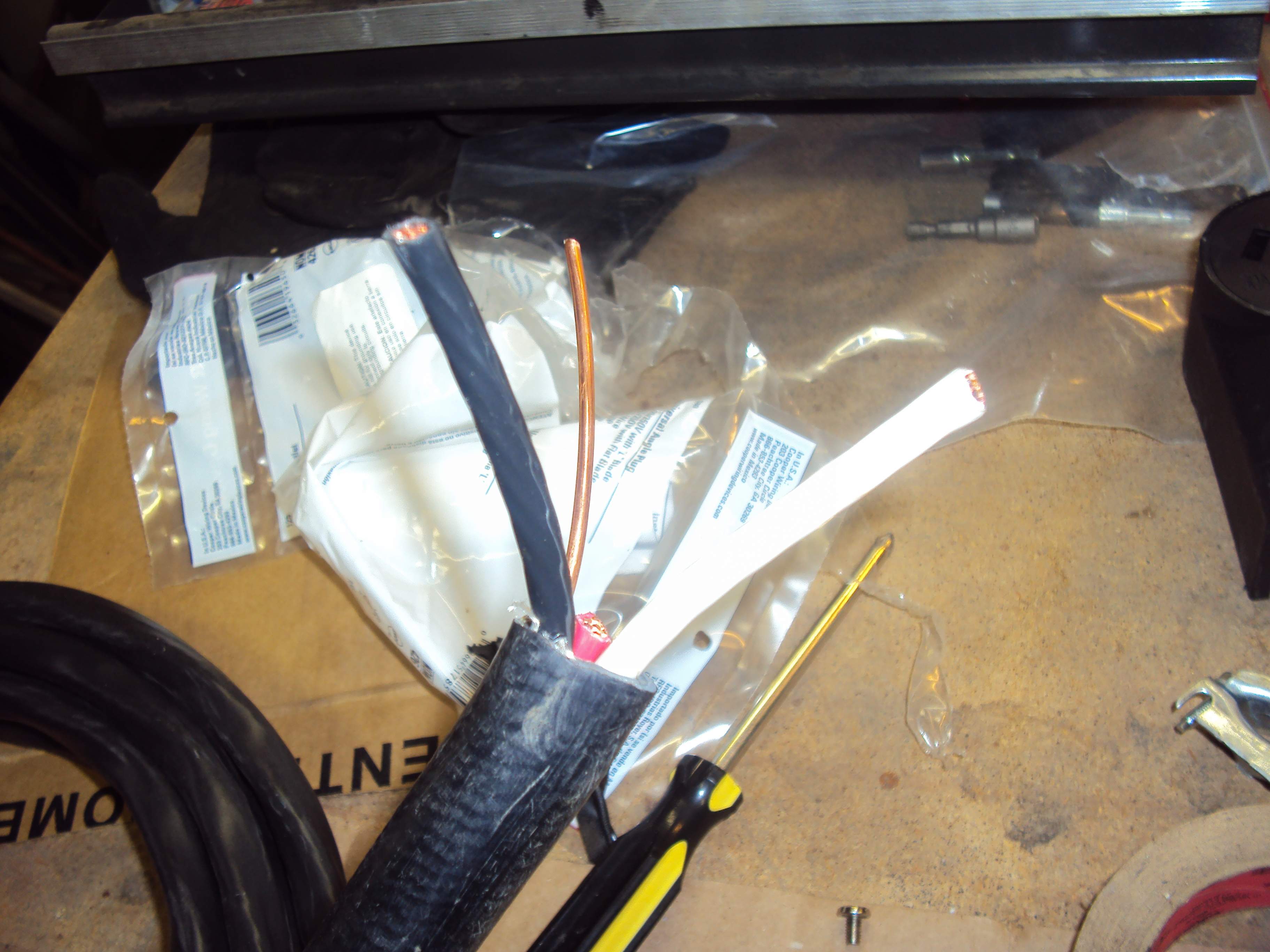

here are some pictures of how I wired the plasma cutter, and the extension cord. I used the Nema 10-30 plug/outlet, because it is what I already use in my shop. I picked up 30' of 6-3 wire from lowes, for the extension cord, because it was only 2 cents more per foot than the 8-3 wire (I also get the military discount there.) The plug that came with the cutter is next to the new one on the power cord. Also a pic of the air filter/regulator on the back of the machine. I would have installed a new 50 amp breaker, and outlet but I am having a new addition put on my shop next year, and did not want to go through the trouble, since that part of the shop was getting demolished. As far as dry air goes, I will post some pics of my unique set up in a couple days. Gotta work nights, and weekends, so not to much time to play with my tools.
